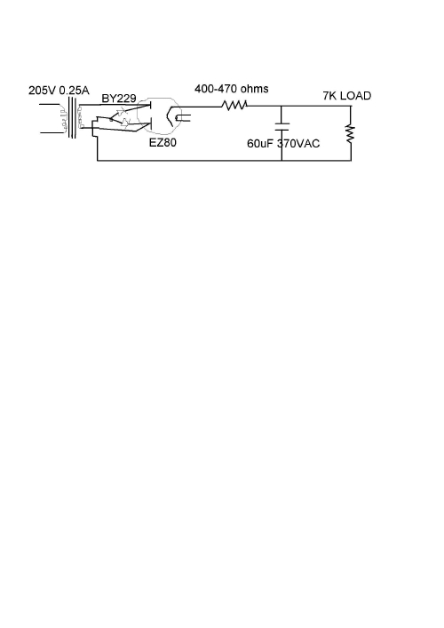

Hey,
I tried to get some help from you guys to design a hybrid-rectified PS at my project thread, " Help need to find..."
But nobody did, so here it is.... I really need help here....
I got a single new transformer with secondaries having no CT.
I can use 4 silicon diodes to form a full-wave bridge. This method allows me to save a lot of space, but I need to get high quality Schottky or Harris diodes, which cost an arm (I need 8 diodes in total to make 2 PS with single transformer!!)...
With this method, I would also have to add a switch on one of the two secondary wires to allow heaters to fully heat-up before HV is applied...
To avoid using the delay switch, I can use small rectifier tubes like EZ80 to make half-wave rectified PS, but the efficiency isn't good at all...
So it comes to a conclusion that I should use hybrid rectification with this secondary winding without a CT. It allows me to use any diode and does not require any delay switch.
It is really cost effective to me, as I already have many tube rectifiers and all I have to buy is 4 silicon diodes in any quality.
I know that this method is normally used with directly-heated rectifiers like 5U4, but why not with indirectly-heated ones?
But it makes me wonder... Is hybrid-rectification suitable with such a minimal approach, using only RC or RCR filter?
As I don't have any more space on the amp chassis, I can't add any choke or more 'large PS caps,' and I can't make a PSU on a separate chassis, as I've already spent quite a lot of money on the amp chassis.
So could you guys let me know whether hybrid-rectification is suitable with simple RC filter?
If IT IS suitable, please please please help me out to design one for my amp...

And here's the secondary winding:
----- 0V
l
l
l---- 167V
l
----- 205V @ 0.25A
It is rated for 205V @ 0.25A (with a tap rated for 167V, but that's not a CT... let's ignore the odd tap and use the 205V one...) I'll use the 0V and 205V taps to use the winding as a simple, two-tapped winding.
Please remeber that this SINGLE transformer will supply BOTH channels. I'll build TWO PSU sharing this single transformer, ONE PS unit for EACH cahnnel.

Hybrid rectification isn't a good idea. You'll have lots of ripple to beat-the-snot outta your filter cap. The SS diodes are going to conduct better at the top, the tube on the bottom of the AC cycle. The waveform will show one half-cycle larger than the other, this is going to turn into a nasty little sawtooth at the filter cap.
Use all SS or all tube, but not both, on the same winding.
Many designers use a hybrid, but on different windings - a 5U4 or 5R4 on the HV winding, SS diodes on the filament windings for DC heaters.
Too bad your limited on space, otherwise I'd suggest using a bridge of horizontal-damper tubes for rectification.
However, in your position, IMHO, just use a bridge of 1N4007.
If you mean a setup where you use two diodes and a half wave tube rectifier in a FWB configuration then I don't think there is any such problem as you state.
The silicon diodes will not cause more or less ripple neither will they be the cause of much increased RFI.
In fact the bridge will act as a FW tubed diode bridge with considerably less voltage drop and only slightly more spikes than a FWB uses all tubed diodes.
The idea was originally brought to us here by Gary Pimm and duely explained by him as well.
If you care to look it up I'm sure the local search engine will dig up some relevant info.
Of course the SS diodes can still be snubbed properly and be of high audio quality as well but there's little need for that: a pair of 1N4007s would do very well already.

Hmmmmm, I'll re-scope the setup I tried.....a 5Y3+2x1N4007. I had killer sawtooth troubles :xeye:

You can use four diodes as a bridge on the outside (206V winding terminals). Then use an EZ-80 slow warm-up rectifier (if that is the tube you must use), with plates paralleled for more current capability to each separate amplifier circuit.
The additional use of tube rectifiers will not stop silicon diodes from producing switching noise however. Someone please correct me if I am mistaken. This noise will travel back into the power xfmer and come out the other windings unless you use a transformer with a shielded HV winding. The noise may be attenuated somewhat through the rectifier tubes.
Snubber caps of 0.01 mF value at 1 kV DC rating can be used across each diode to help supress the switching nois. A parallel LC resonant network filter in series with each transformer HV lead tuned to the resonant frequency created between the output winding of the transformer and the stray circuit capacitance (usually 40 KHz to several hundred KHz) can also help keep this garbage out of the transformer. A capacitor across the HV winding of the xfmer alone (try 0.01 uF/1kV) may be enough to do the trick.
You could use one or both of the motor run caps on the output of the SS bridge prior to feeding the anodes of the EZ-80's. A separate electrolytic of a value not exceeding about 47 uF could be used on the cathode outputs of each EZ-80 to act as reservoir filter for the amplifier attached to that rectifier tube.

I'll try to draw a diagram and post it here, so that you guys can double check that it is ok (or SAFE!).

Guys:att'n:
Is this correct? Would it work safely if I connect two of these to the single Transfo. ??

jlsem said:
Wow - already. Where did you get your degree so fast?
Well, engineer mind... as near as I can tell. :D
