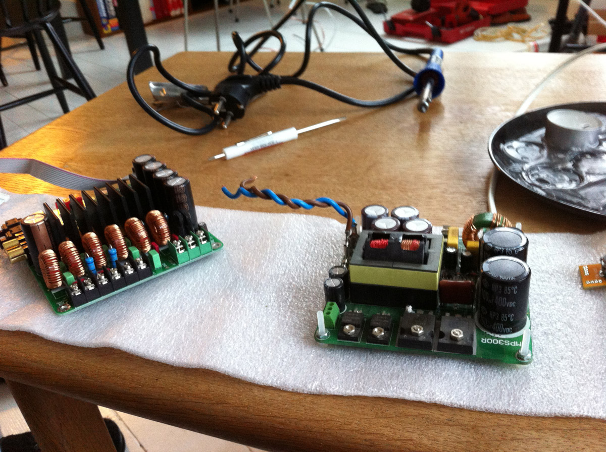

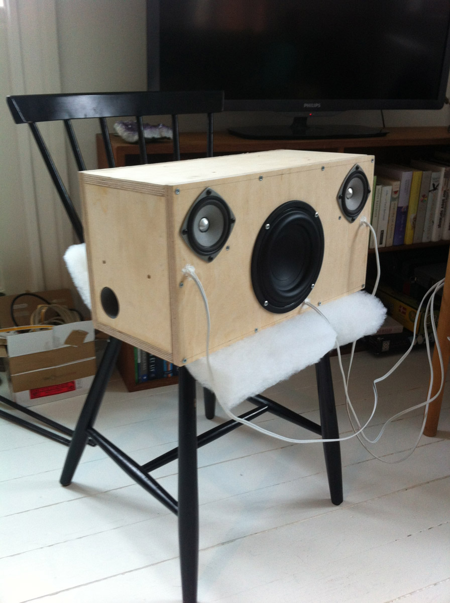

My friend and I have been thinking about this idea for a while and the other day we made some test builds. The idea is small active 2.1 boombox using two fullrange drivers and a (sub)woofer. The objective for this project is a small box with as much low extension as possible. After trying different drivers we settled on the Fostex FF85WK as fullrangers and a TangBand W6-1139SIF for bass duty. Crossover is in the 250-300Hz area. For amp we use the Hifimediy DDX320v2 2.1 Digital Amplifier with a Connexelectronic SMPS300R 38V.

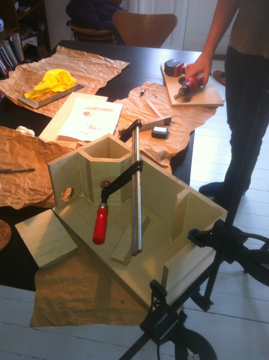

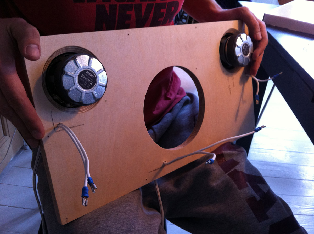

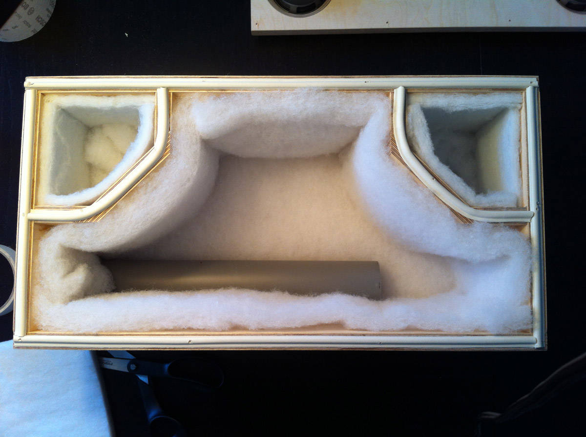

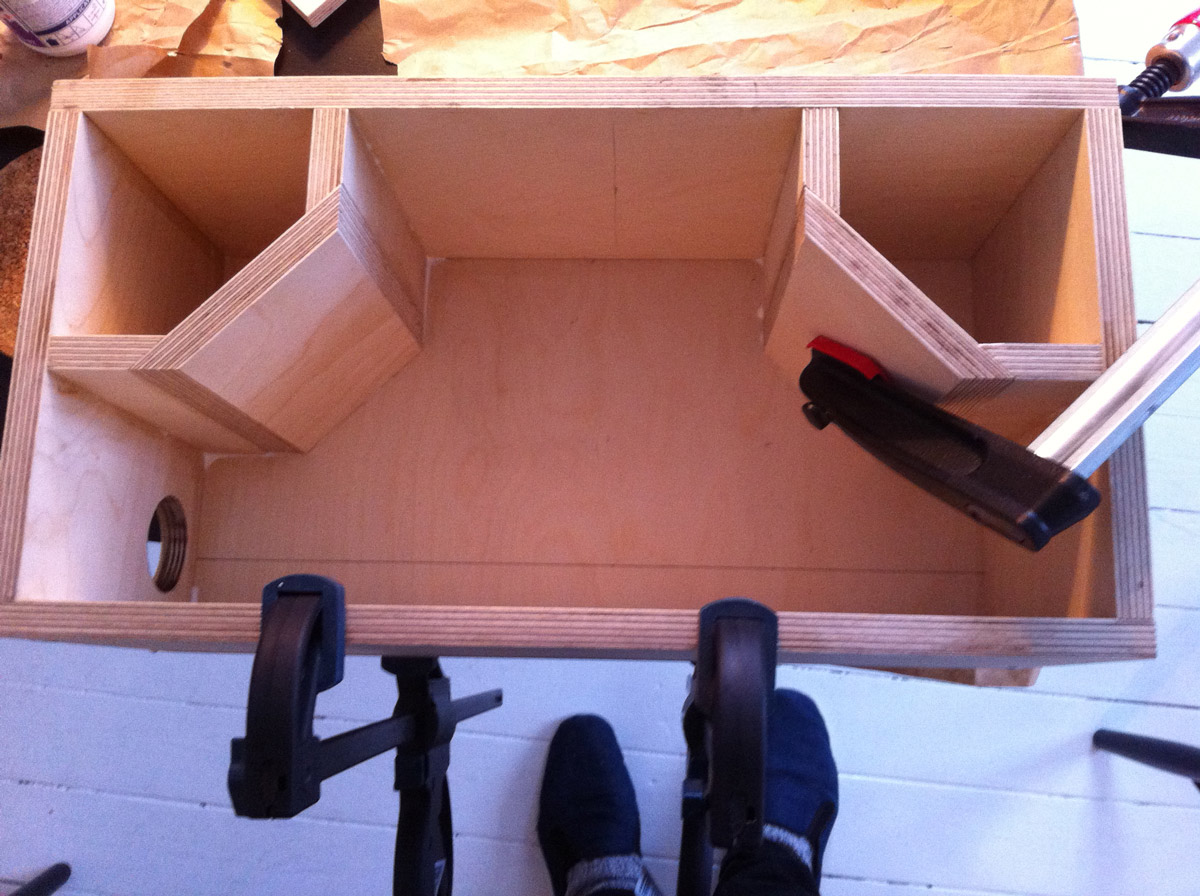

Here are some pictures of the test build using some leftover 15mm BB ply. The fullrangers are each in their ~1.5 liter sealed chamber, 75% stuffed. The woofer is in a 11.5 liter BR enclosure with a 50mm port tuned to 35Hz.
The DDX320v2 has an adjustable electronic crossover, which can be set between 80-360Hz, we settled on 280Hz. It uses a 2nd order low pass and 1st order high pass
So how does it sound? Okay I would say, but not amazing! We made a comparison with some budget 2-way bookshelves, the Dali Concept 1, placed very close together to be fair 🙂 Our boombox surely wins on the low frequency extension, but it isn't as "clear", "open" and "crisp" as the Dalis.
This is of course only a test build. We haven't measured it yet, and no EQ or time alignment has been applied so far. Filter options are very limited with the DDX320v2, but we also have a miniDSP and various amps so we can experiment.
Thoughts and ideas are greatly appreciated!

I've had this idea of making a tapered TL style chamber for each of the Fostex, inspired by Planet 10's Tysen. Do you think this will affect the sound much compared to our current 1.4 litre sealed enclosure with stuffing?

So when you say "yes" I assume you mean for the better? 🙂 Could it be that the FF85WK simply don't behave very well in a sealed enclosure?
Yes, performs better. "not open" typically is reflection coming back thru the cone. THe uFonkenSET for instance is more open than the slightly smaller uFonken, the TLs are larger volume and lower back pressure.

Interesting. So, if I made TLs a la Tysen for the Fostex in this application, could they then have similar sized enclosures (1-1.5L) and a length of only 15-17cm?
The sub enclosures & TL in my last ate up 3 litres and were ~26 cm long. The TL is not very critical in dimension but erring on the large size and longer line is probably better... it is dominated by the damping, but larger gives more room for damping.
