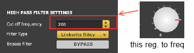

Hello,
I have a proposal. Currently we can change crossover frequency using key input like this(or click but increase\decrease +-1 only...):
attachment.php
But it will be good if we can control frequency using:
attachment.php
So the reason for this, is that we can in real time change frequency between two drivers and listen what sound good and what not.
For example I have 4-way system and 50-200-3000hz crossover frequency options and I want in real time change 200hz by moving up or down.
Currently to do this, I need click one channel then type new value, like 250hz, then click another channel and input again 250hz. That's not so useful.
