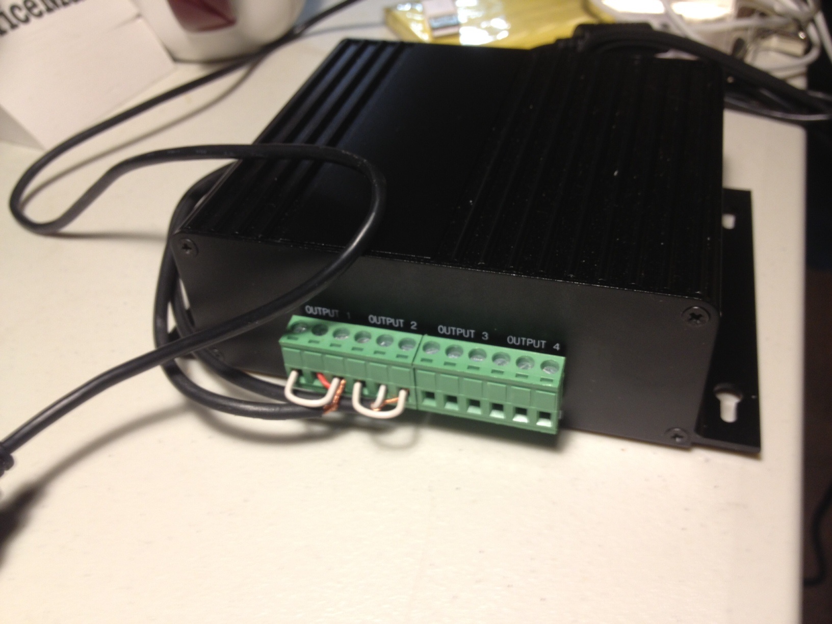

On unbalanced 2 wire rca, plugging them into the balanced connection requires the earth (edit..shield..still sipping coffee) to negative wire, like in this pic.
The amplifier I'm using for subs is an NU4-6000, which has balanced inputs. The amplifier for my mids and highs is an older Carver amplifier, which doesn't offer balanced.
What I need to know is, if I run 3 wire balanced to subs (using all 3 wires from the phoenix block for those two outputs) and then hook the other 6 channels balanced -> single ended (using the bridge wire like the pic) will that cause any output stage havoc, or should it be able to handle that without issue?
Ah. Yeah, those jumpers are not necessary and not recommended. (I don't care what it says in the owner manual.) All they do is take one side of the active signal to ground via the internal output resistance. There's no benefit in that at all.
All the output stages (all 16) are completely independent of one another. So, you can mix/match any way you chose.

Beautiful, thanks very much for the help!
