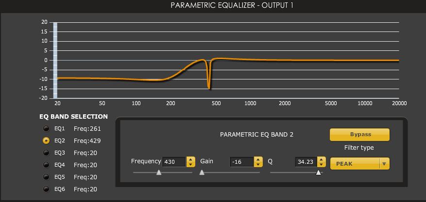

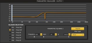

EQ that overlaps in frequency, but opposite directions
Can it be confirmed that the chip would work just for its EQ, and can be set up to handle effects that overlap in frequency, but in opposite directions?
I have a pair of sub kits with plate amp and XO: but not an ordinary set up, it’s Rythmik’s Servo controlled step up (Rythmik Audio • Servo subwoofer products) that it’d be better to keep as “a whole”, including its XO.
I also have an excellent fullrange driver which has a few quirks in response, including (without going into all the details, when put in a box that’s not unacceptably big), a very big upper bass lower mid hump due to high Q, starting at 500 Hz. (Yes the alignment is not optimal, but as it’s a bump theoretically it can be flattened, and for a couple of reasons I want to try this).
With the intended baffle width, baffle step cuts in about 50-100 Hz below where the hump ends.
If BSC is allowed for this, can the EQ plug ins remove the overlapping affects – the very broad peak, and add BSC that is shelved?

Hello Otto88,
In answer to your questions:
You can also overlap any combination of PEQ + Low Shelf + High shelf using multiple bands. See the attached picture as an example (though may not fit your application, but just showing how you can overlap a low shelf on band 1 + PEQ with high Q on the band2.
Hope this helps,
DevTeam
Yes, you can indeed bypass all processing on the path and just use the input/output PEQ or graphic EQ if using the graphic EQ. All LP/HP filtering can be set flat by using the Bypass function.Can it be confirmed that the chip would work just for its EQ, and can be set up to handle effects that overlap in frequency, but in opposite directions?
That one I can't tell for sure because EQ is not a one for all solution as you already know. What I'm just showing you is that the DSP can handle that processing. Whether it will solve your speaker problem, I don't know but don't see any reason why it wouldn't.If BSC is allowed for this, can the EQ plug ins remove the overlapping affects – the very broad peak, and add BSC that is shelved?
Hope this helps,
DevTeam

So the only reason it would not effectively remove the effects, is if the PEQ needed ,exceeded the number of bands? iirc the max is 6?
I could read through the whole thread – but in brief, apart from plugins: what hardware is needed?
And is their progress or likelihood on you sourcing a suitable case?
Cheers
Cheers
Thanks DevTeam 😉
Cheers
Either exceeding the number of band (max 6 per input + 6 per each output channel) or the fact that maybe your problem is a temporal/phase cancellation issue which wouldn't be solved with EQ...
As for what's required: For a stereo configuration, you'll need:
1 x miniDSP
1 x plug-in (2way PEQ or 2way Advanced)
and an external PSU (e.g. either USB supply or +4.5v to 24Vdc supply)
Hope this info helps
