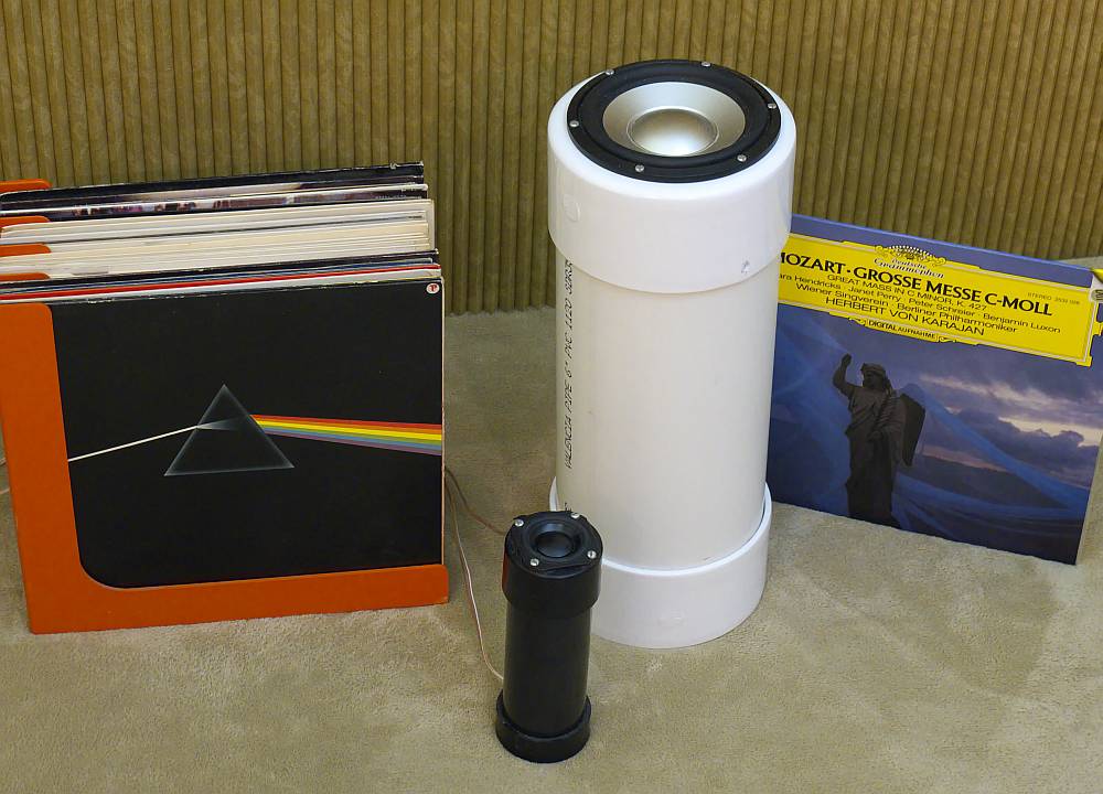

Hi, I have now documented my tiny bi-amped ground-effect omnidirectional speaker system.
The speakers are introduced here:
Tiny ground-effect omnidirectional biamped system - diyAudio
The amplifiers are introduced here:
http://www.diyaudio.com/forums/clas...tput-filter-designs-sure-tda7498-example.html
and the details of how the MiniDSP is set up to do "<ka precomp" biquads, and general compensatory shenanigans is on my website, here:
Trevor Marshall - Ground Effect Omnidirectional HiFi Loudspeakers
Thanks to the MiniDSP team for a wonderful product. I am having a ball figuring out all the neat things I can do with it 🙂

Feel free to advertise it or abstract any images. If you need more info, I will happily provide it. Thirty years ago, audio design provided my living, but these days I just engineer this stuff as a hobby, for relaxation 🙂
As for giving it a try - the Tymphany 830983 should be readily available in Hong Kong, I paid $17 for mine, and they are really the heart of the system. They sound fine without the woofers (but limit the available low bass power, of course). They put out a good sweet sound in a small apartment, such as one typically finds in Hong Kong 🙂 Switching in the MiniDSP compensation makes a HUGE difference in sound quality, not just in tonal balance. A good demonstration of the power of the MiniDSP, in fact 🙂
I left the compensation in my coefficients file to run the 830983 on its own, all you need to do is use channels 2 and 4, changing the 200Hz highpass crossover to 40Hz, or so 🙂 I did find that a single subwoofer did impair the sound (compared with two woofers).
