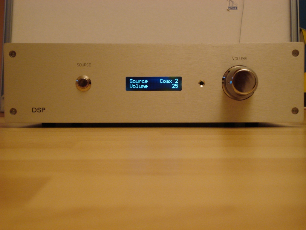

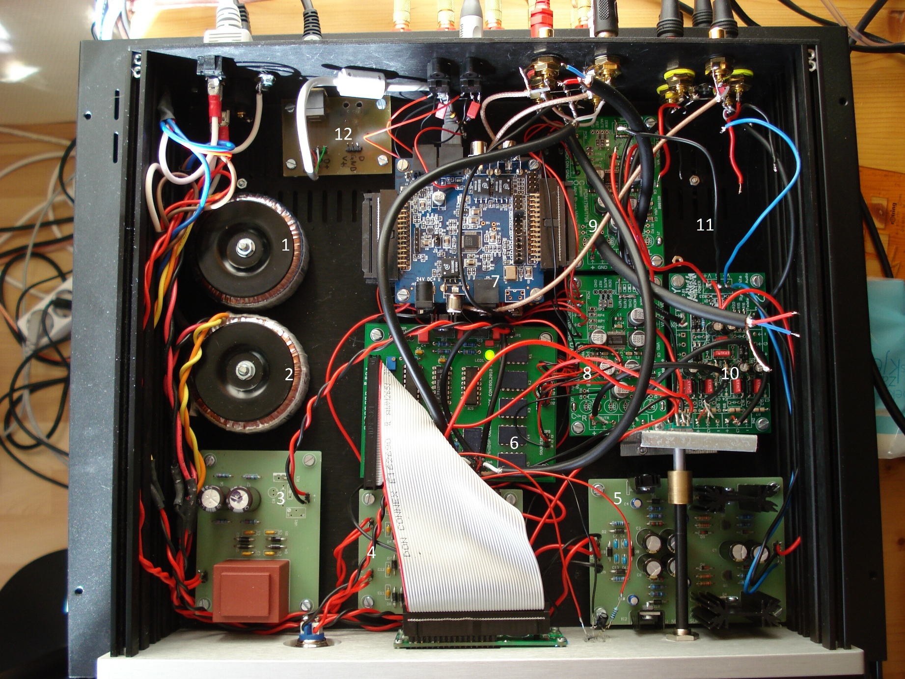

Thought I can show my minidsp based pre-amplifier as well. 🙂
It's basically a minidsp & minidigi with two pcm1794 dacs connected by I2S. Also included is a pcb for remote controlled switching 4 digital and 2 analog inputs and volume control. Volume can also be controlled by a rotary encoder. It displays the info on a vfd display.

Knuisje,
nice setup! Looks like you used twisted pair dacs, right? What about the volume control? Analog or digital domain? miniDSP or DAC?
How did you realize the digital optical inputs? Simply paralleling Toslink receiver to the build in of the miniDIGI?
I am about to realize a similar project with a miniDSP 2x8 and multichannel analog volume control (PGA).
Hi curryman,
Yes, I used 2 COD and IVY pcb's from Twisted Pear. The volume control is in the digital domain. I used a microcontroller to generate 0 - 3.3V for the master volume control of the minidsp.
The new optical inputs are TORX147 receivers. I removed the 47uH smd inductors from the minidigi so the original receivers are cut off from the power. I connected the new receivers with wires at the same points as the original ones.

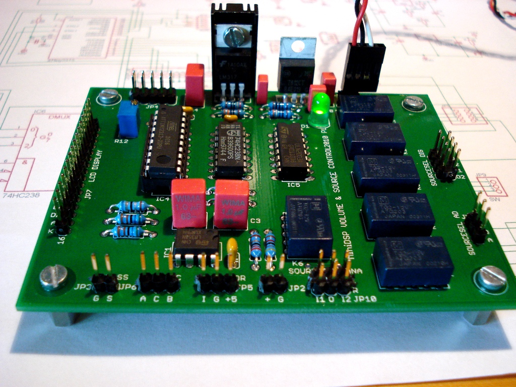

Very neat front panel and enclosure! Is this LCD + Rotary encoder + source selection a project of yours? You should sell a little kit to go with it, I'm sure that a lot of people would love it! 🙂
Quite a lot of things under the hood and thanks for sharing your trick for the optical receivers...
Devteam
Yes, I developed the control board on my own with some support of other Dutch DIYers. It can switch between 4 digital and 2 analog sources using relays and controls the master volume of the minidsp by generating a voltage. Also you see connections for a rotary encoder (volume control), IR receiver (volume & source selection), pushbutton (source selection) and LCD display. Everything is controlled by an AVR microcontroller. A standard Philips remote with RC5 codes can be used and the board can learn the systemcode of the remote.
I'm using the board for one year now and it's functioning very stable, haven't had a single issue with it. Several other Dutch and Belgian DIY-ers are using this board as well.

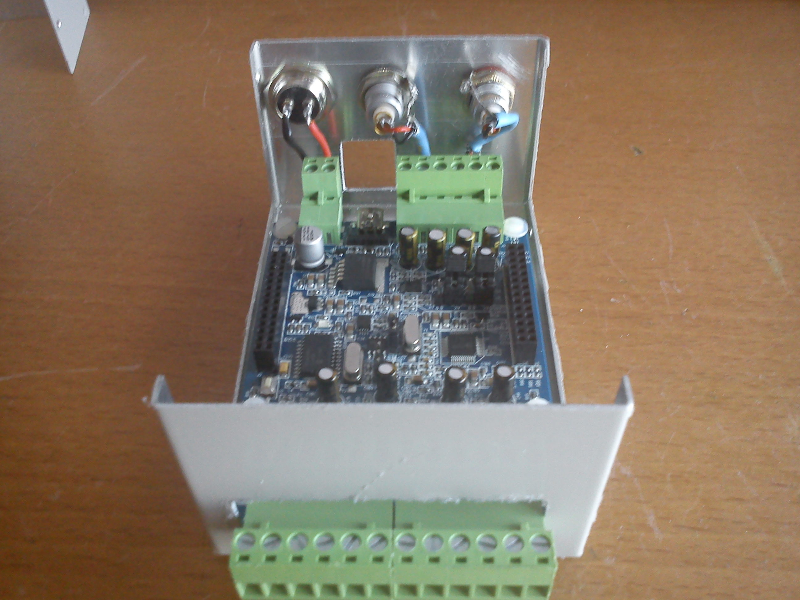

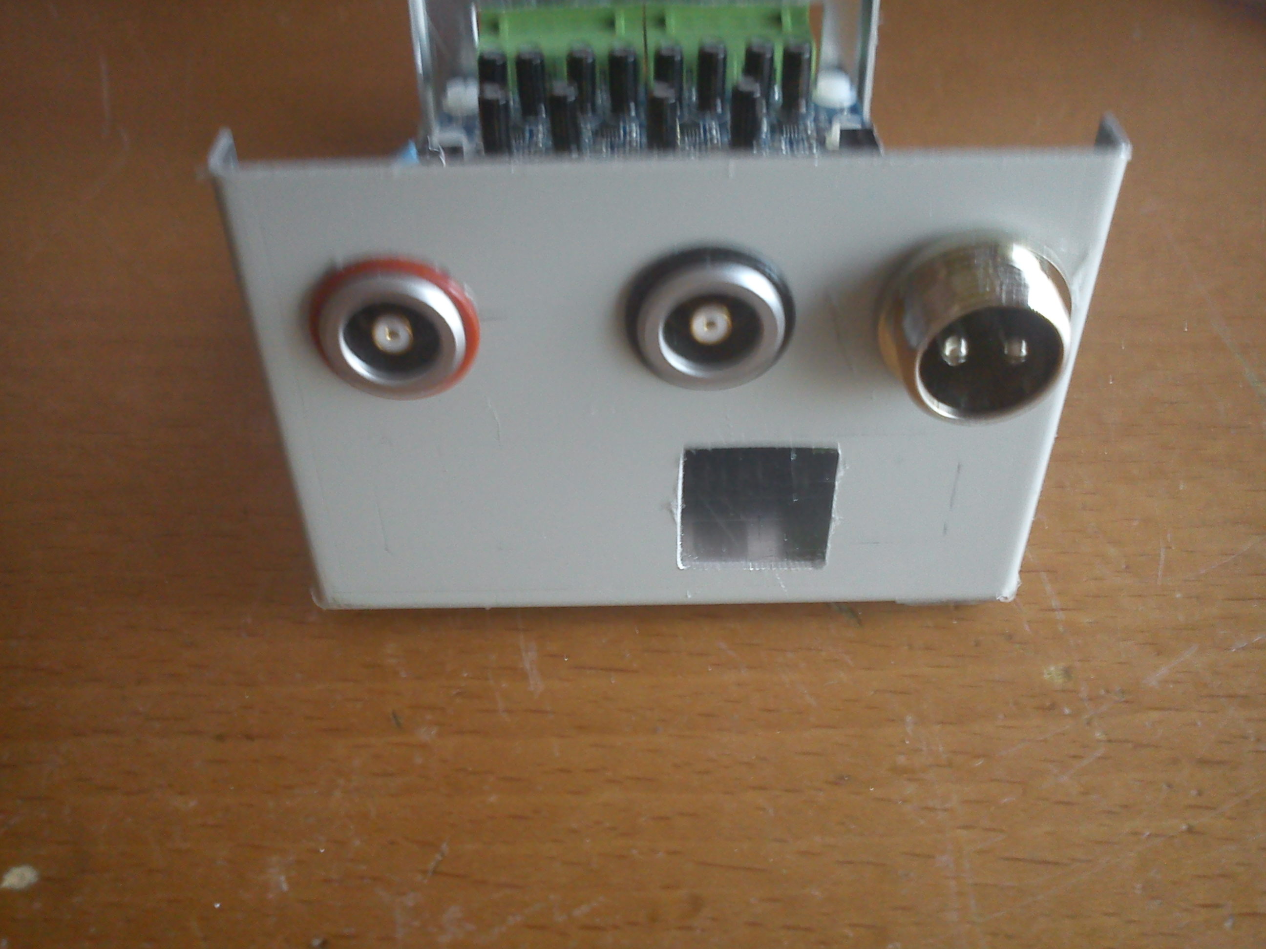

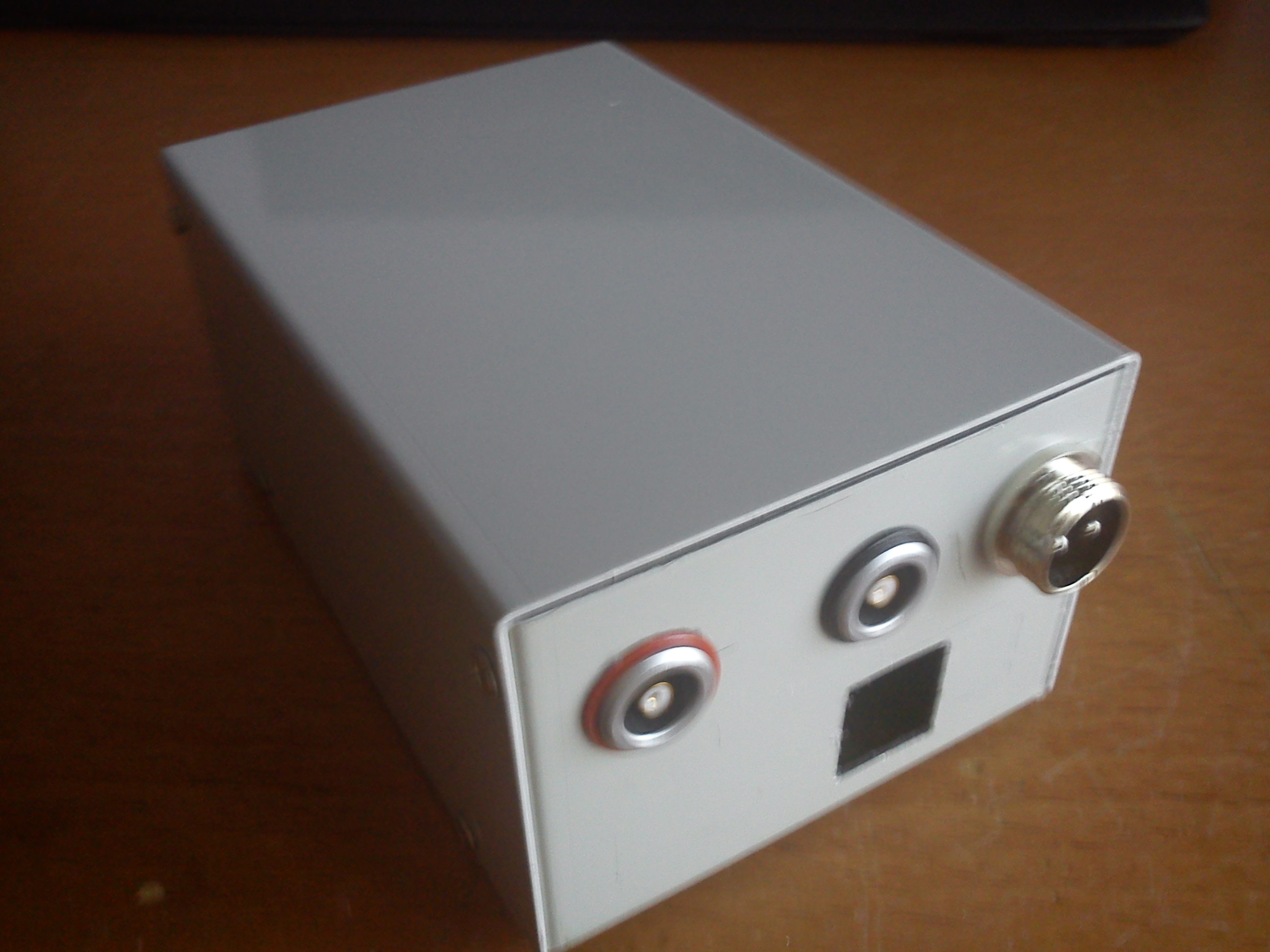

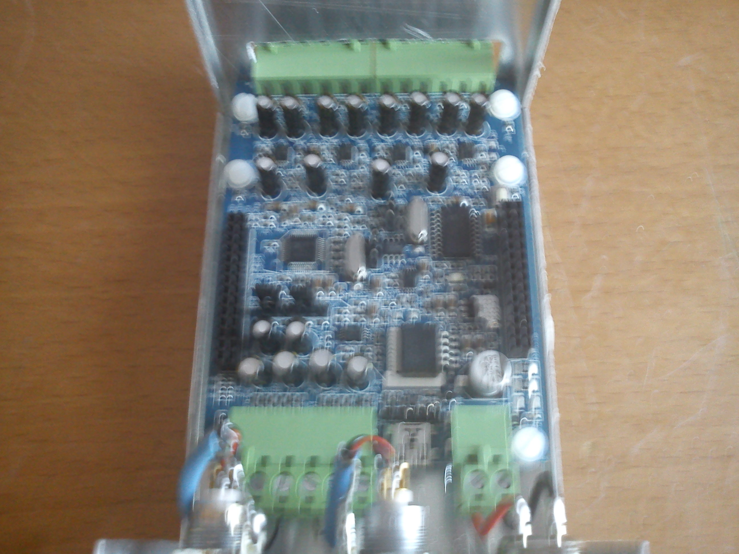

1 X MiniDSP Balanced 4 inputs and 8 outputs boxed
Just finished 1 X MiniDSP Balanced 4 inputs and 8 outputs boxed

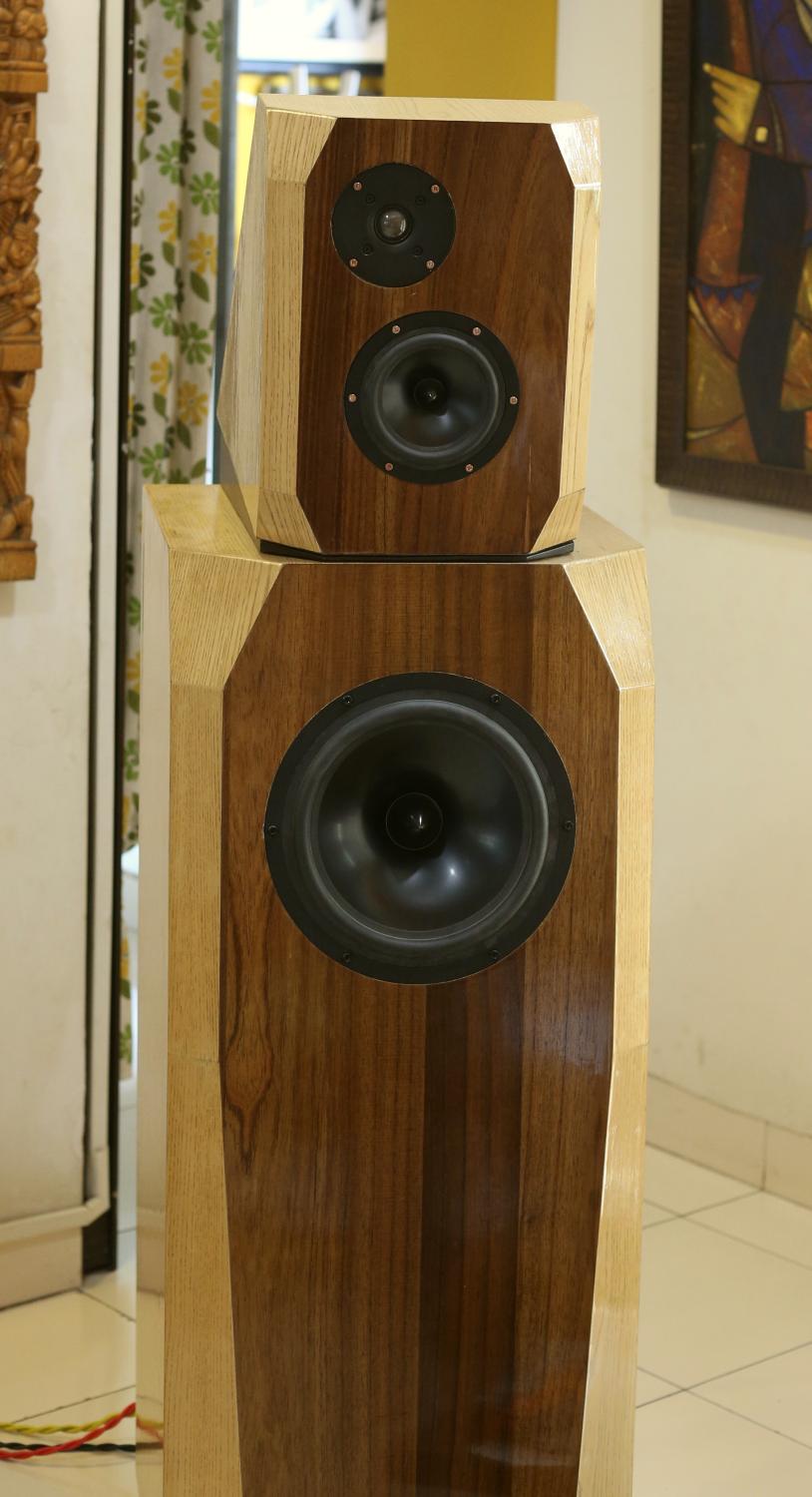

For some reason, no one's posted anything here for some time, and I didn't know this thread existed, so I never posted my speaker project.
I built the Darbari -- the enclosures were done in 2013, the measurements and the crossover were done in Sep 2014.
I used the MiniDSP 4x10HD, feeding six analog outputs to a Marantz AV receiver in 7-channel mode.
Lots more photos on my pages including a lot of construction details.
