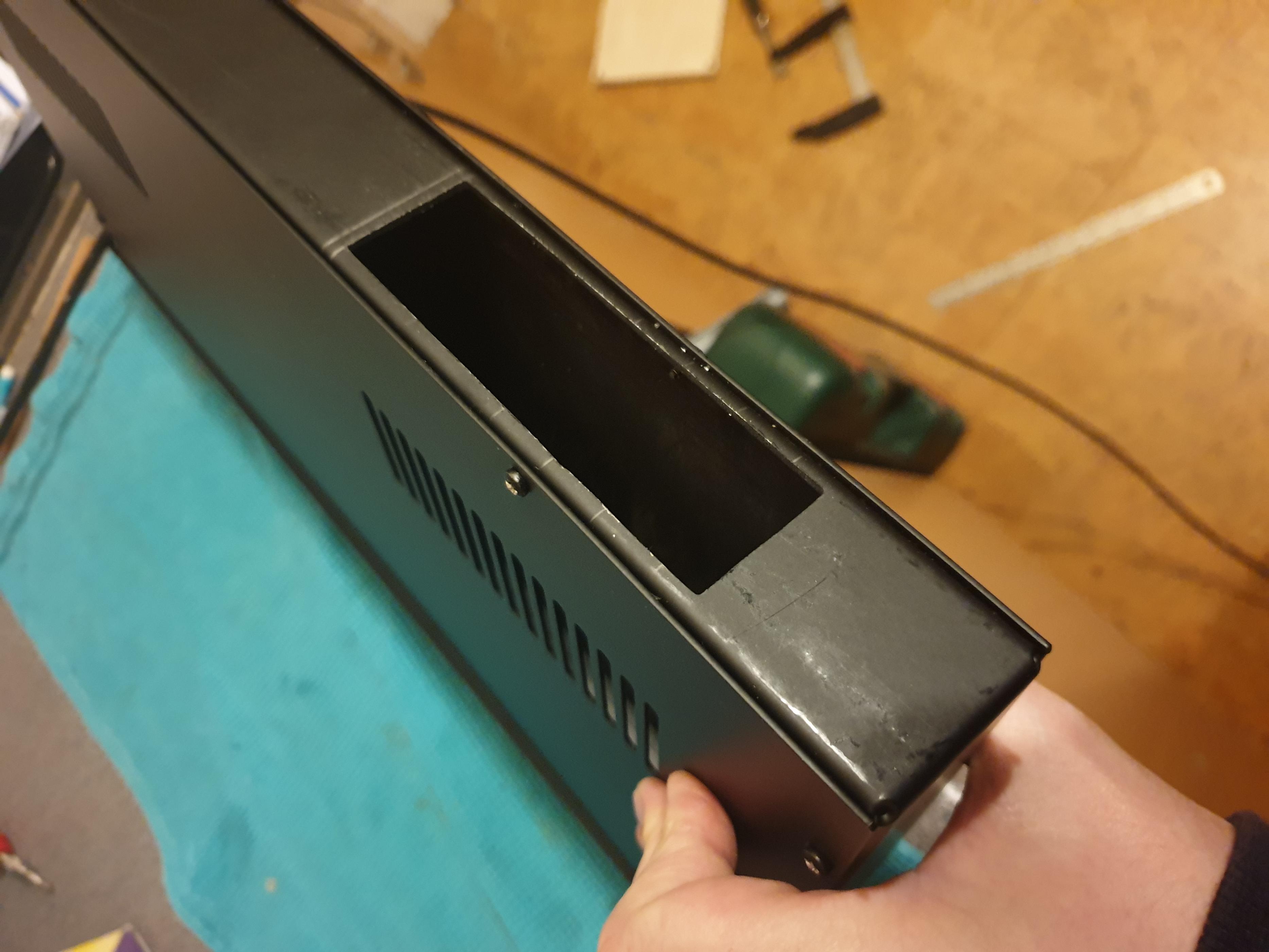

I've not done any metal work like this before and I cocked up the holes for the rca sockets so badly I had to cut a much wider hole for the Phoenix connectors as well.
Have I ruined all screening properties that the case will give me with these wide holes?

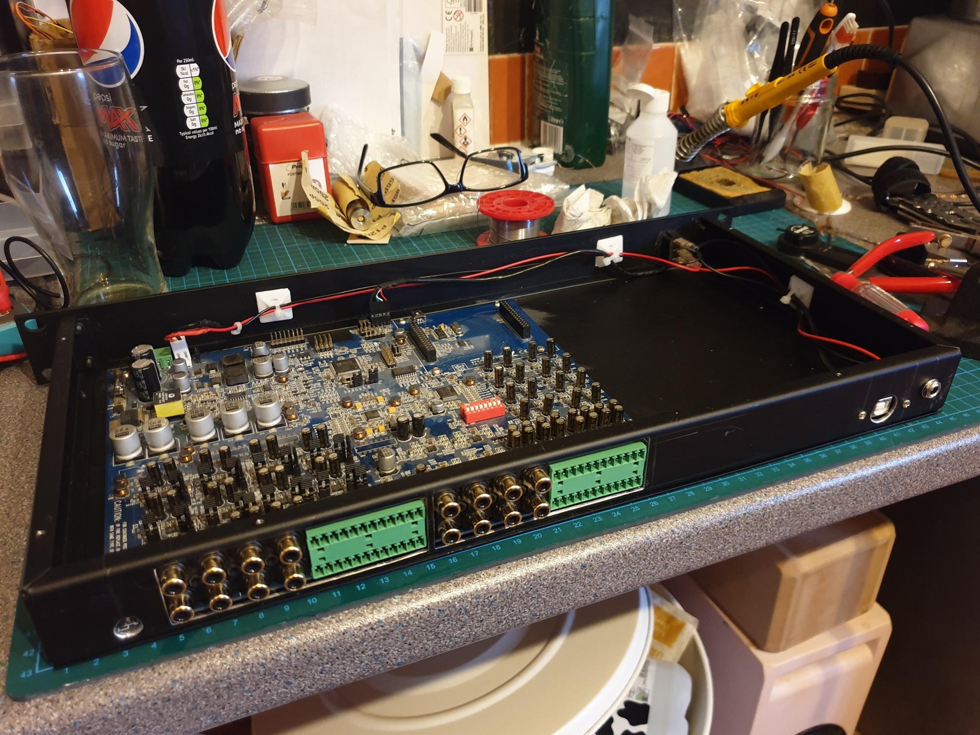

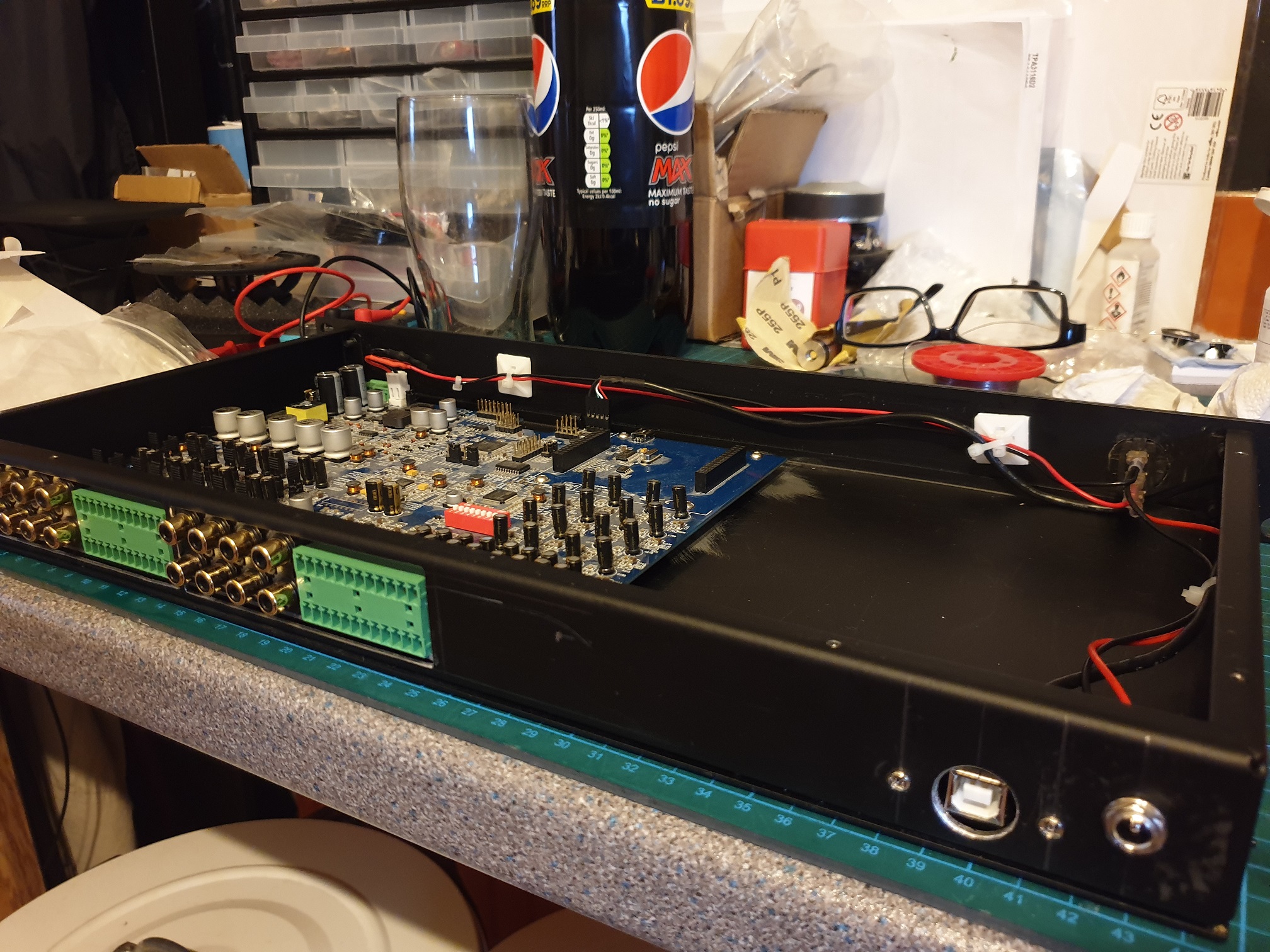

It isn't the prettiest thing I've made but it's perfectly functional. There was A LOT of hand filing done.
Now I am getting the same stinging power arc (?) from the MiniDSP enclosure that I get from my computer case if I lightly touch is with sensitive skin. No improvement on noise but that's one potential problem taken care of.
I wonder if the stinging arc from both cases is due to poor grounding or something from my computer PSU? I use a Lenovo ThinkCentre E73 Core i5 with maxed out 16gb RAM. A budget machine.
Both Xonar U5 and MiniDSP 8x8 are connected via USB to computer constantly and audio is connected between them. Potential loops?
