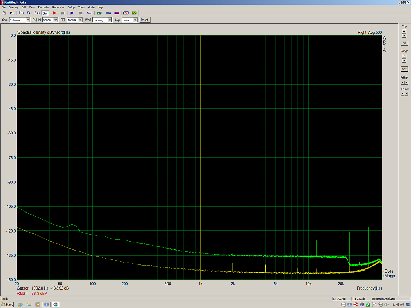

But, since it's posted, his noise performance (shown in that image above) appears better than anyone else's measurements of the miniDSP by order of magnitudes. I am curious of the particulars as to why his approaches -130dB (I'm skeptical), while others are closer to -73 to -83dB in reported similar tests?

You need to compute the total rms, the little red text at the lower left.

The "others" are either not measuring correctly and/or misinterpreting the measurements/numbers. I suggest to perform some measurements yourself.

Here's another noise floor test with 96khz SR. Same graphing scale and setup as the one in post #41.
I believe Barleywater is correct and that, in some cases, out of band noise modulates with certain power amplifiers to create noise within the audio band. This probably accounts for the differences of opinion regarding audible noise of the miniDSP 2x4 unit.
Thank you Scott. Now that I know where to look for that, Davey's value is within range of everyone else's measurements.
