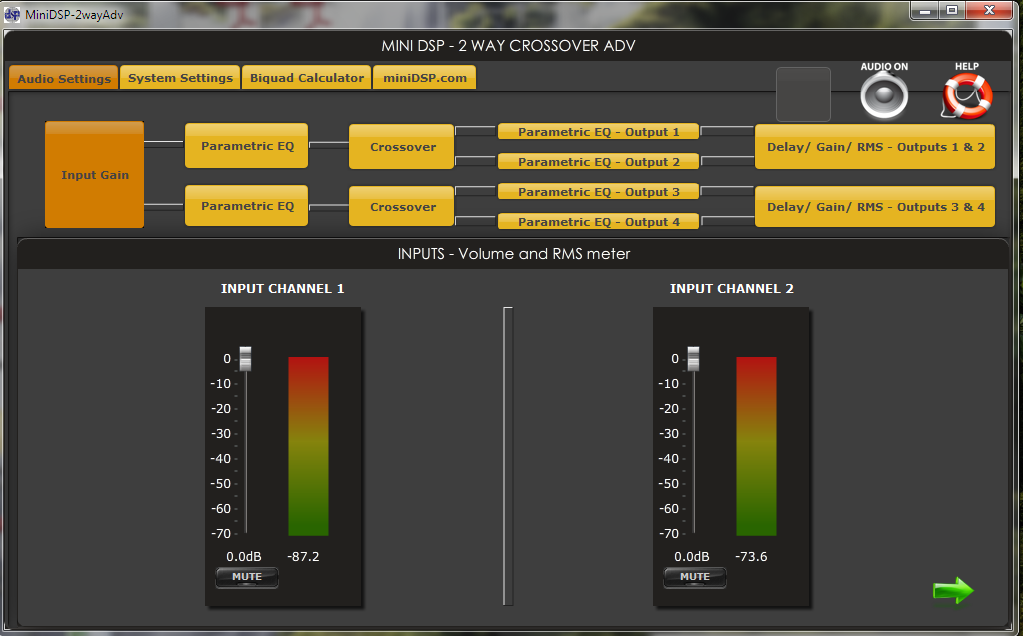

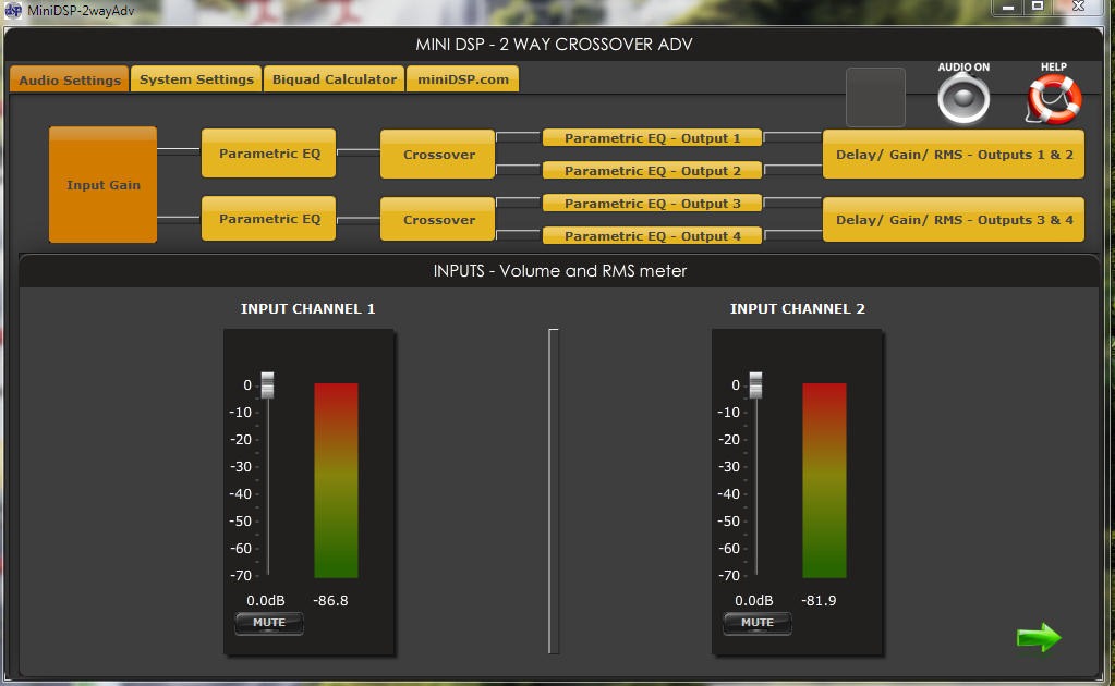

I've just received a minidsp 2x4 and I was interested in measuring its noise floor.
As a first thing, I powered it through USB, set to 0dB gain, shorted the inputs and looked at the 2-way advanced crossover plugin VU meters.
The two inputs show values that jitter between -73dB and -86dB, independently and randomly. It looks like noise (see attached)
Is it normal or is my minidsp defective? I would have expected a stable value similar to the noise spec of the AD chip used by the board. The minidsp datasheet doesn't seem to specify a noise floor value.
So far I'm a little disappointed, should I?

Noise with inputs shorted
Yes.
i tried two different setups:
1. amplifier with gain of about 16, input impedance of about 47Kohm, speaker connected to output, inputs shorted, no miniDSP; I can hear no noise even with my ears at a few cm from speaker cone
2. miniDSP with inputs shorted, connected to the above amp. MiniDSP is set with 0dB gain, all filters bypassed. This time with my ears close to the speaker cone I can hear a distinct hiss.
Minidsp power supply is 12V, filtered with 2200uF + 10uF tantalum + 0.1 uF
If I power the miniDSP through USB, of course the hiss get louder and more "random", so definitely a better PSU reduces the hiss, but I couldn't manage to eliminate it, even with a "good" PSU like the one detailed above
Any hint, is there anything I could try to eliminate or at least further reduce the hiss, which is really annoying?

A bit of hiss/noise would be normal......relative to low-noise analog circuitry.
If your speakers are fairly high efficiency and you still need to put your ears close to the speakers, I'd say you're doing okay and your miniDSP is operating nominally. Is it audible from 3-4 feet away?
With some gadgets you could pad the outputs to lower noise, but since the 2x4 unit maximum output voltage is 0.9VRMS you probably can't afford to do that.

-73dB looks a bit much, but -86db is already very good for this chip. That's the limitations of the DSP used here. However, if you don't use digital volume control, this is usually good enough.

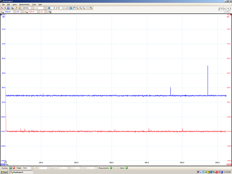

For a non-subjective reference, here's a spectrum analyzer look at the noise from my 2x4 unit with nothing programmed and inputs shorted. This is a 625khz linear window...blue is the output of my 2x4 unit and red is the other channel of my spectrum analyzer with input shorted for a baseline reference. The miniDSP output noise is equivalent to approximately -86dbV across the measured bandwidth.
It's possible to shunt the output with an appropriate value capacitor to create a low-pass filter using the miniDSP output resistance. This will reduce the above audio band noise which could be causing some sort of modulation into the audio band with certain power amps. I haven't found this to be necessary with any of my power amps, but the option is there.

yes the background noise is not much, but in my application I'm using six 2-way speakers, which means that the noise will be x12, most probably audible from a few feet when no signal is played through.
The spectrum analyzer screenshot is interesting. I wish I had such an instrument.
In your opinion, what is causing the ~470KHz ~570KHz noise, which seems to be very very narrow band and not related (maybe a harmonic ?) to any clock/frequency used by the board?
Also, as you have the instrument 🙂, may I ask what is the typ noise floor of an amp (with gain 20 or more, average efficiency speakers) that is silent even to ears placed very close to the speaker cone?
If you maybe have it to test, what is the noise floor of Curryman's DAC?
