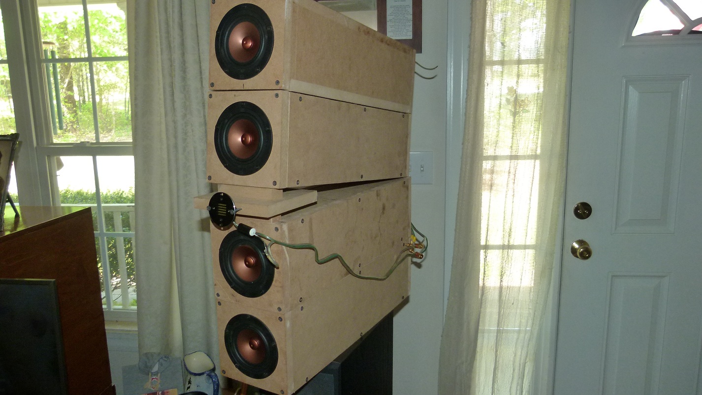

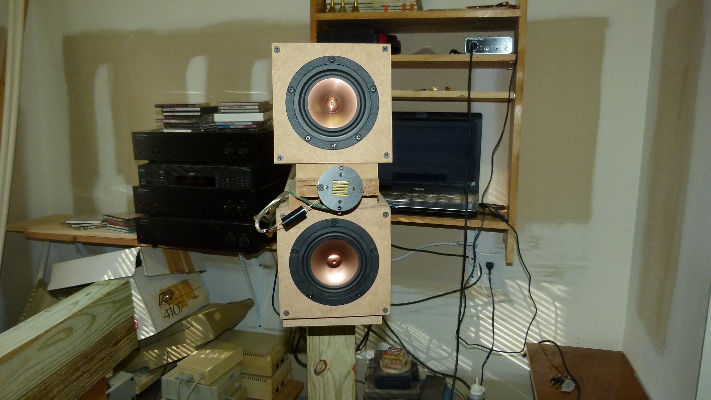

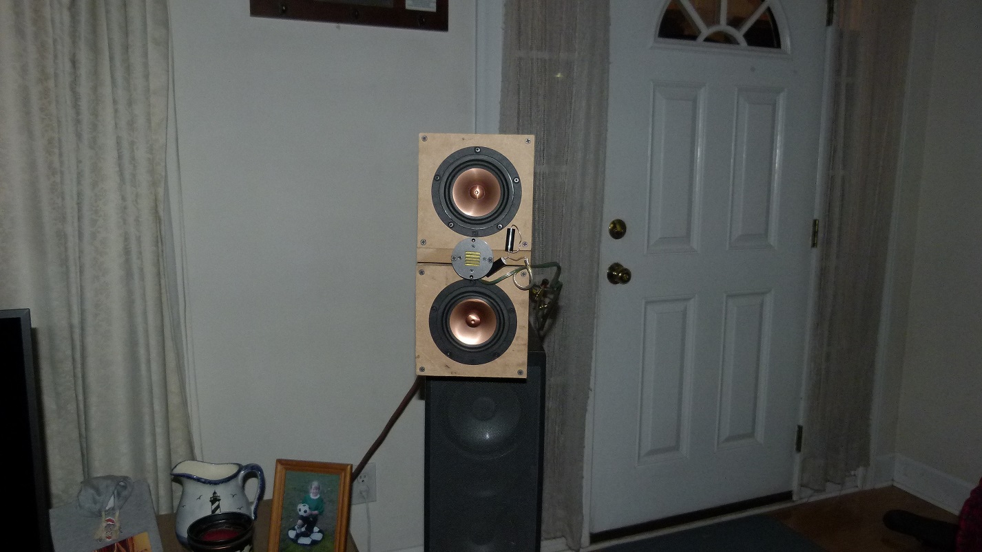

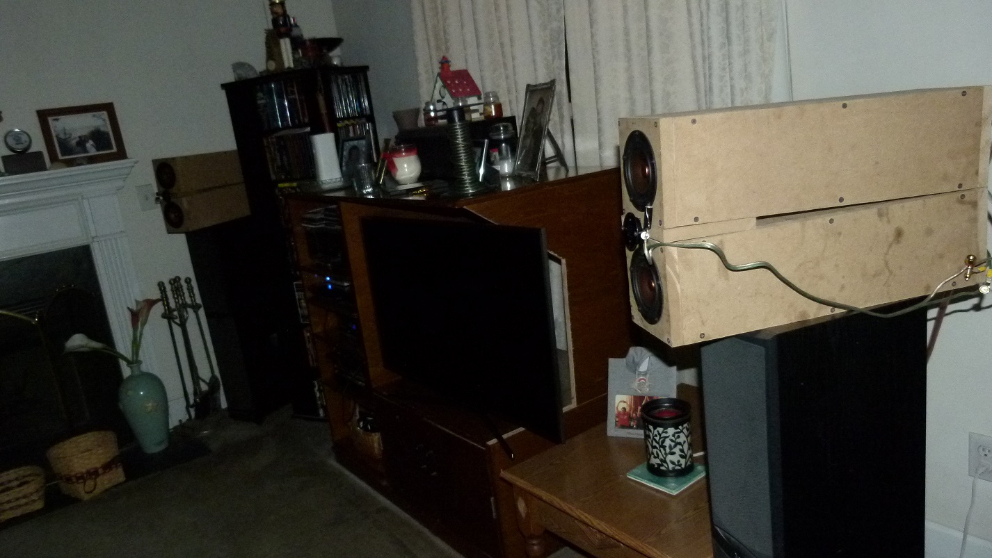

Right now I'm experimenting with MTM, i.e. 2 stacked FR Pluvia's with an 4-ohm AMT tweeter in the middle and everything is wired in parallel. The only crossover I have so far is a 2uF polyester cap in series with the AMT65-4.
All the lower frequencies are gone from the lobing effect, which is fine at this point. After I build 2 more boxes for 2 more Pluvia's, I'll test a MMTMM setup for L & R channels. The endgoal now seems to be a WMMTMMW setup with 8" SB Acoustics woofers crossed over in the sub 200Hz range. We'll see after the MMTMM experiment.

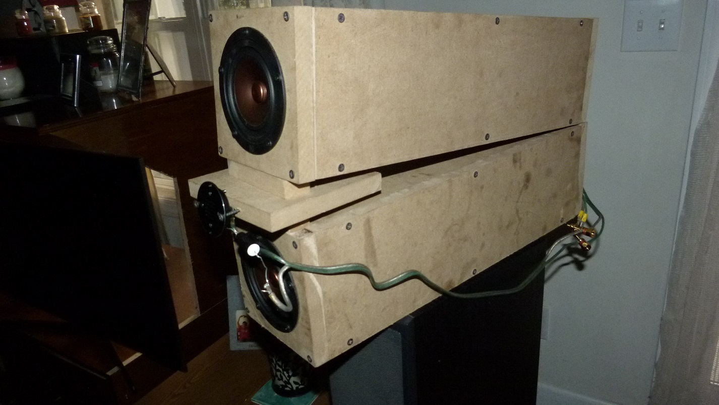

I'm about to enjoy these.... Today I put them in the garage, slightly different angles on the Pluvia's before I brought them back inside for a comparison test. Slightly improved lower FRn in both rooms. More work is needed. Comb filtering is more evident in the sub 1kHz region.

Thanks for contributing Dave! But why is it that's the region where I hear the most difference when comparing one speaker to 2 stacked boxes?

If the Centre-to-centre distance is less than a ¼ wavelength then the 2 drivers are essentially coincident. Combing starts when the c-c is much greater than that.

What you have built in the last images is an MTM configuration, might pay you to read information from D'Appolitto or other's on that arrangement to give you some insight.
You also have the tweeter forward of the woofers and the woofers angled, so you will be changing the interaction between them. Usually the tweeter needs to further back to time align better. Perhaps you could build a waveguide type fitting to put the tweeter in putting it further back and lining up better with the acoustic centres of your full ranges.
At the very least putting the tweeter on a small baffle in between the full range cabinets and having them all point in the same direction would probably give you a better result.
True mtm is tricky.
Ideally, if you have 12" from top speaker frame across tweet to bottom speaker frame, you'd treat them like a 12" and cross no higher than 1,200hz.

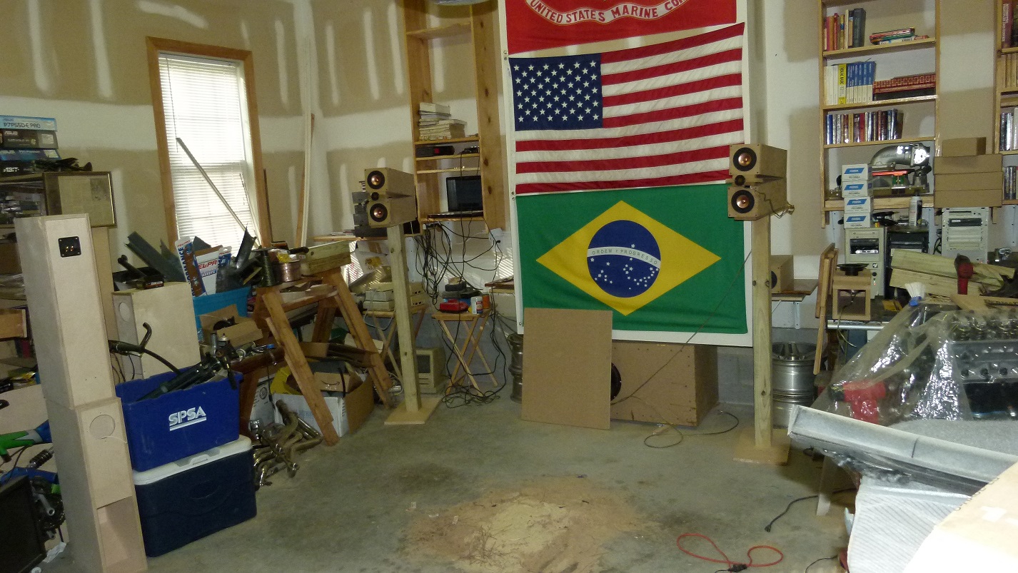

You can see everything has been made to be re-arranged for the best sound. Totally experimental at this point.

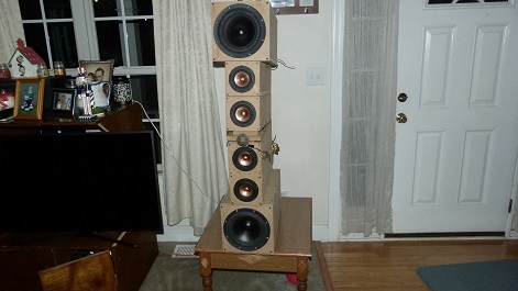

Working on the last of 8 total enclosures for the Pluvia 7's. Then I have enough MDF to make 2x 1 cu.ft. for the 8" Dayton (sub)woofers.
Up to MMTMM...
