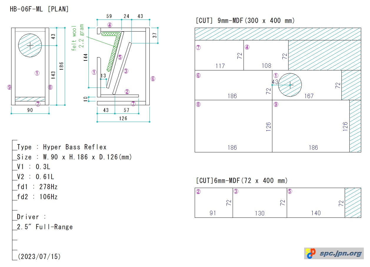

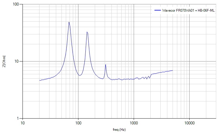

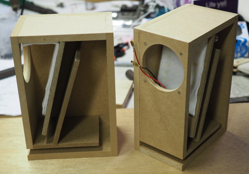

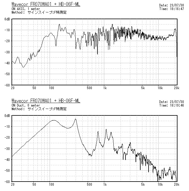

Mini speaker using Wavecor FR070WA01 (2.5" full-range)

Greets!
What kind? I guess I'd call it 'accurate' within its design limits with nothing calling attention to itself once I swapped the caps to PIO, added some damping around the tweeter. Personally believe some of its 'goodness' is due to its thick, relatively heavy cast alum. box, well designed metal grill.
