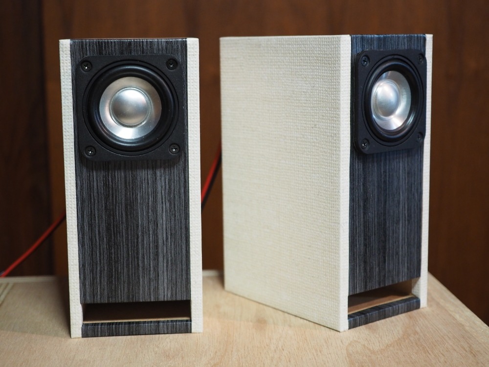

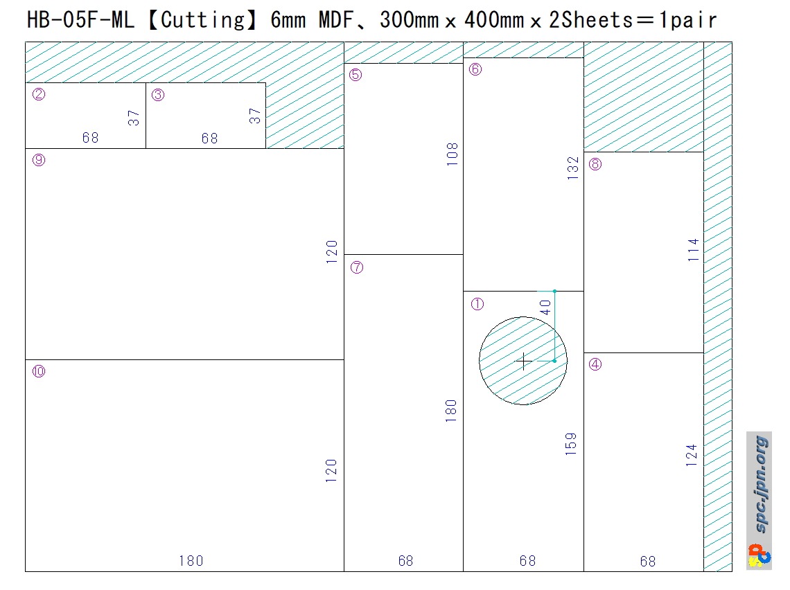

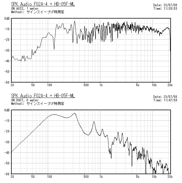

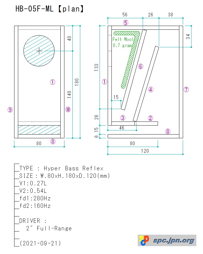

Mini speaker using SPK Audio F02A-4 (2" full-range)
I build several mini speakers, but this F02A is the end of the line.
It does not produce heavy bass, but I adjusted it to emphasize the bass feeling.
PVC sheets and wallpaper were used for the finishing.
Mini size is also interesting.
