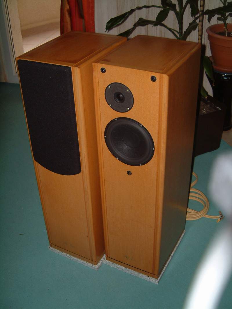

33 feet ?
You must know Jack ( from Jack and the bean stalk ). How tall are you ? My neck would break looking up at your speaker.
They look very nice. Now can you scale it down to 33 inches ?
How do they sound compared to the usual box?
sorry for the error
of course it's 33 inches.
Concerning sound, the box is damped with bitum on all sides, and there are two braces, so the sound is very good, at low and high level.
Sorry for my error
Sorry for my error
just kidding.

The speaker looks really nice. Is that real veneer on the (MDF?)box ? The colour in the picture is very attractive. How much did you spend on the drivers alone ?
Great job.
Cheers.

500 euros for all drivers
(4), it's expensive but....it's not bad loudspeakers.
The MDF used is just varnished with a paintbrush.
The result is really good, I speak about sound of course, it works very well with my Zenquito.

SDF said:The MDF used is just varnished with a paintbrush.
Do you mean the speakers in the picture in this thread (above) are *just* plain MDF varnished? Looks really good ...
Varnished with paintbrush, two layers, it's a good really simple solution, not expensive and not at all difficult...

That was pretty expensive. Me and my fellow builders bought the drivers from Audio-Components (http://www.audiocomponents.nl/) and they were EUR 230 for all drivers if I am not mistaking. I paid just a little less than EUR 500 for the whole speaker including everything (drivers, filters, wood NC-cut, stainless steel screws, terminals, veneer, damping, bass reflex port, glue and oil).
SDF said:230 euros ???? Do you want I suicide me ?![]()
Thank, I will know for the next time!
That would be most unfortunate. I however would like as few people as possible to be discouraged from building due to high driver cost which it apparently does not have to be.
