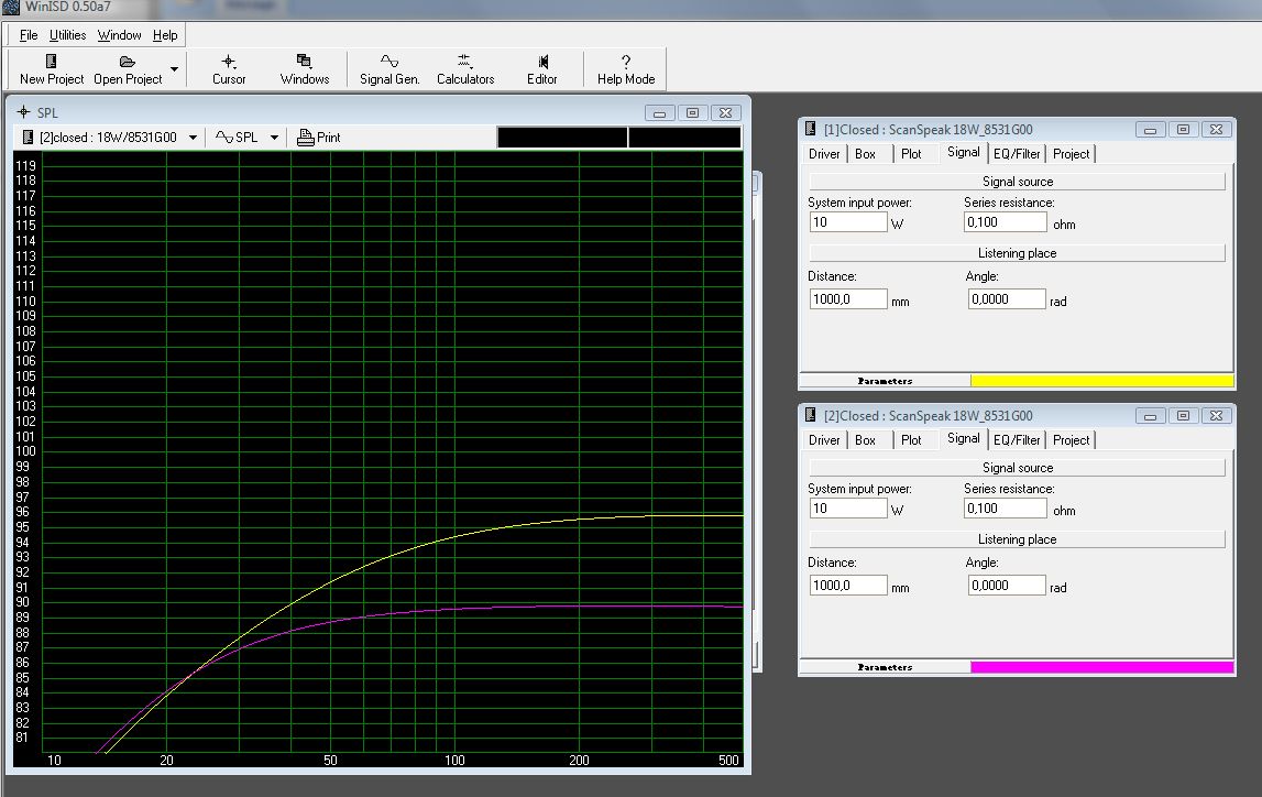

Henry, of course weight matters.
See a simulation of two identical drivers (ScanSpeak 6,5 inch) in a 10000 l box (approx. infinite baffle).
One has a moving mass of 17,5 gram, the other doubble up. Input is 10W. Difference is 6 db.

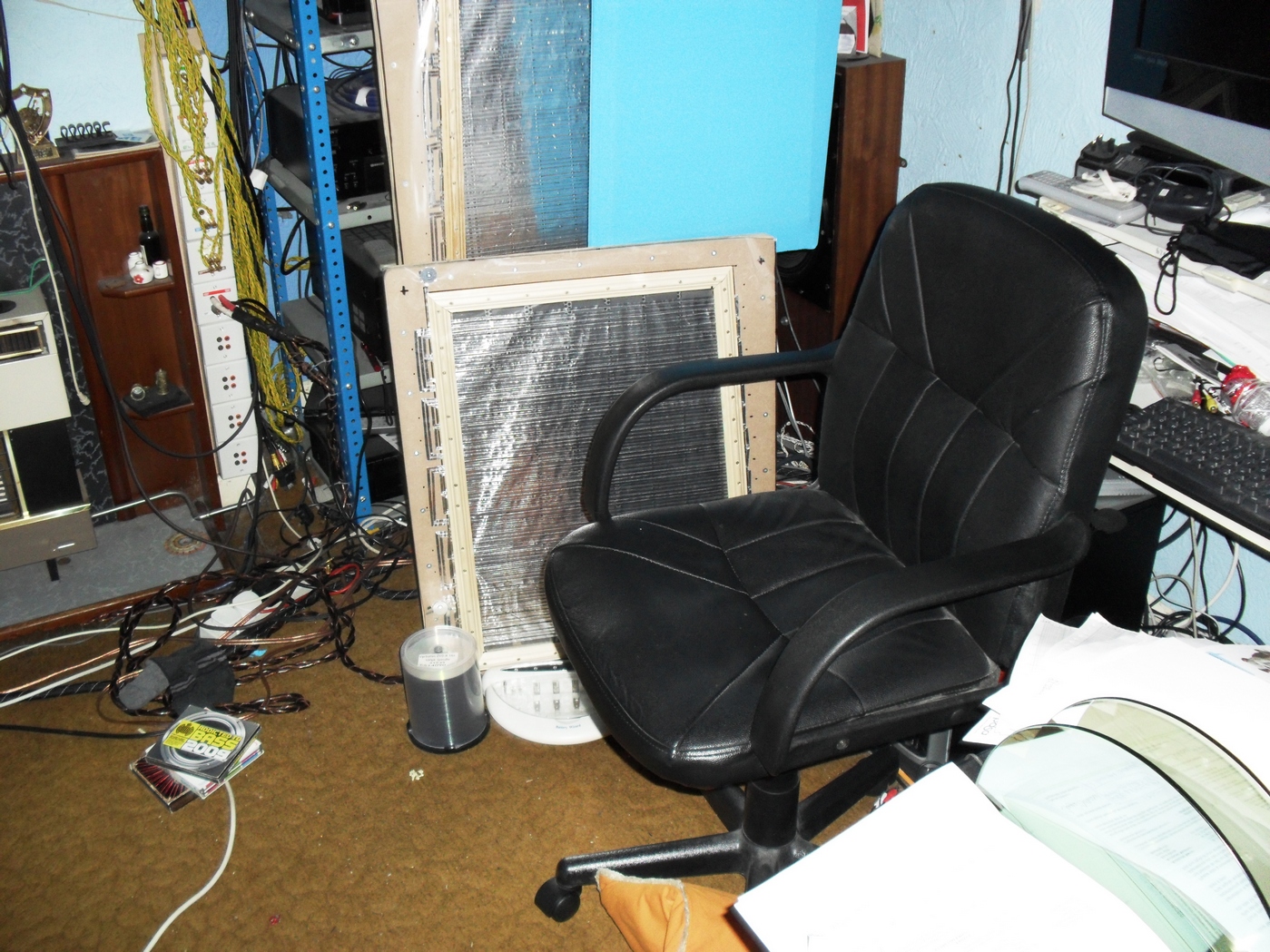

A4 mini planar
Hi Henry
If you are thinking on rebuilding A4 planars with Epsilon layout, please hurry up!🙂
I just can't wait to know how it goes.
A4 is the max size I can afford to desktop planars.
Still, it's rather difficult use epsilon with the magnets on hand (2mm!)
Kind regards, and don't stop rewiring...

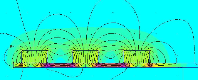

I'm not sure I understand what you mean by epsilon layout. Please explain or point to a place where it is explained. Thanks in advance.
I'm still trying to nail down the defining characteristic of "the Epsilon layout" as well. I don't think the details of the serpentine conductor pattern, meaning the way the conductor loops around after completing a run in one direction and prepares for a run in the opposite direction, are the key point. The increased sensitivity seems most likely to come from increasing the length of wire immersed in the magnetic field: the BL product (magnetic field strength times length of conductor) is larger. More conductor means more mass but also more force.
I remain a bit baffled by the usefulness of running a conductor in a region of space where the magnetic field lines run largely perpendicular to the diaphragm rather than parallel to it. Since the pictures of the magnet arrays don't include labels of N and S poles maybe I'm making some bad assumptions about the layout.
Exactly. The number of turns within the magnetic gap, means more force, and better sensivity. How you make the serpentine, won't matter as long as the current runs in the right direction.
You are also right that right above the magnet (in the middle of it) the field will be "directed out of the diaphragm" and will therefor not make a force in the right direction to move it back and forth. A conductor running right over the magnet will actually try to mode the diaphragm sideways .... which probably creates distortion. So to my mind it will be better to have an empty region above the magnet to save weight. Making the conductor go a little over the magnets edge will help though.
And as you still not sure what is meant by "the Epsilon layout" ... which gives higher sensivity.
Best regards Baldin
Yes the magnets are the usual layout NSNSNS,etc.The diaphragm does not distort whatsoever.Whether you understand the foil layout, the fact is it is a great improvement in sensitivity with no more distortion than the normal layout. Having rebuilt 3 previous normal diaphragms into the new improved ones, I think I can safely say that it works. As long as you get the correct orientation of the foil, which is very important.🙂I'm still trying to nail down the defining characteristic of "the Epsilon layout" as well. I don't think the details of the serpentine conductor pattern, meaning the way the conductor loops around after completing a run in one direction and prepares for a run in the opposite direction, are the key point. The increased sensitivity seems most likely to come from increasing the length of wire immersed in the magnetic field: the BL product (magnetic field strength times length of conductor) is larger. More conductor means more mass but also more force.

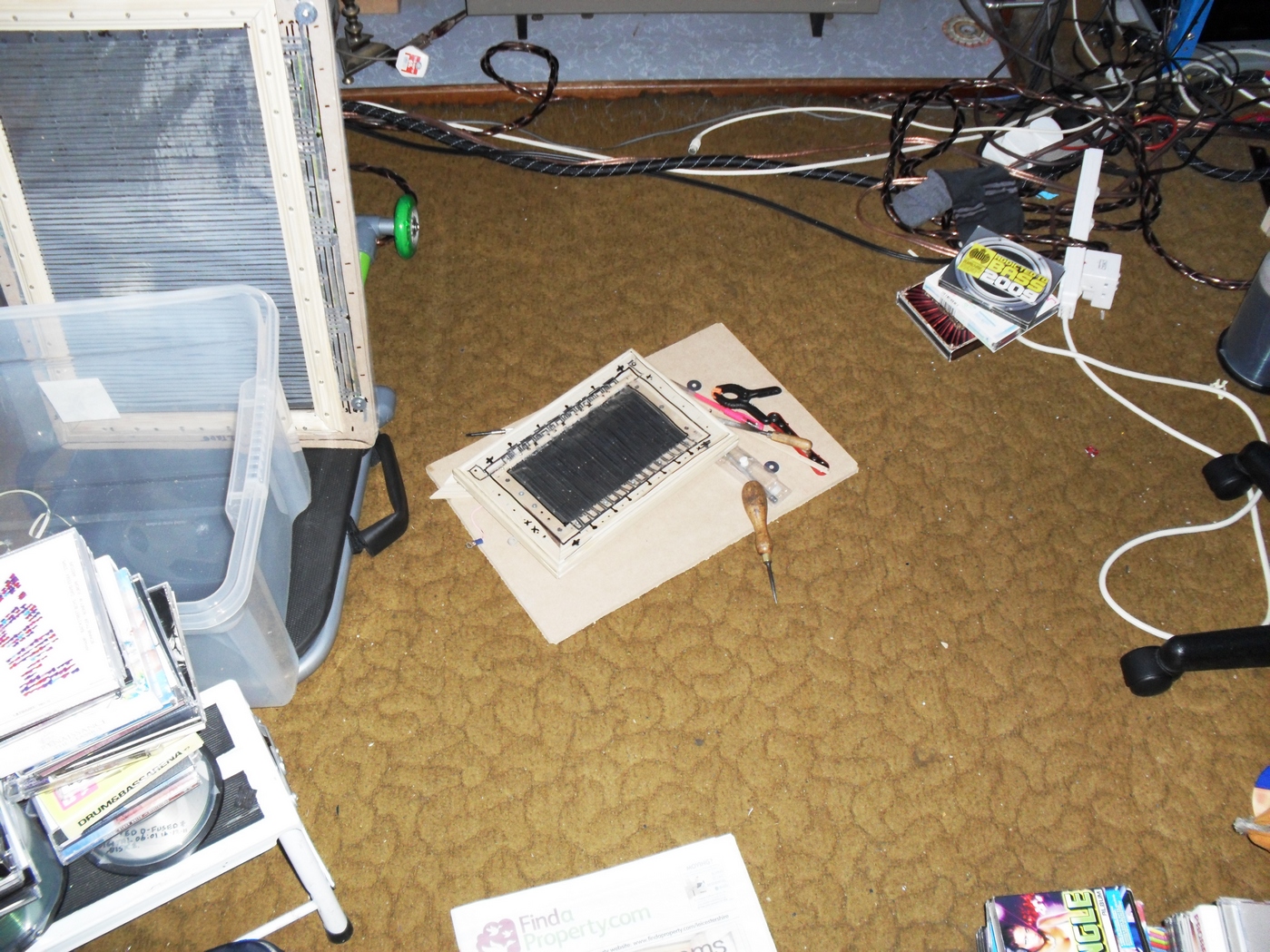

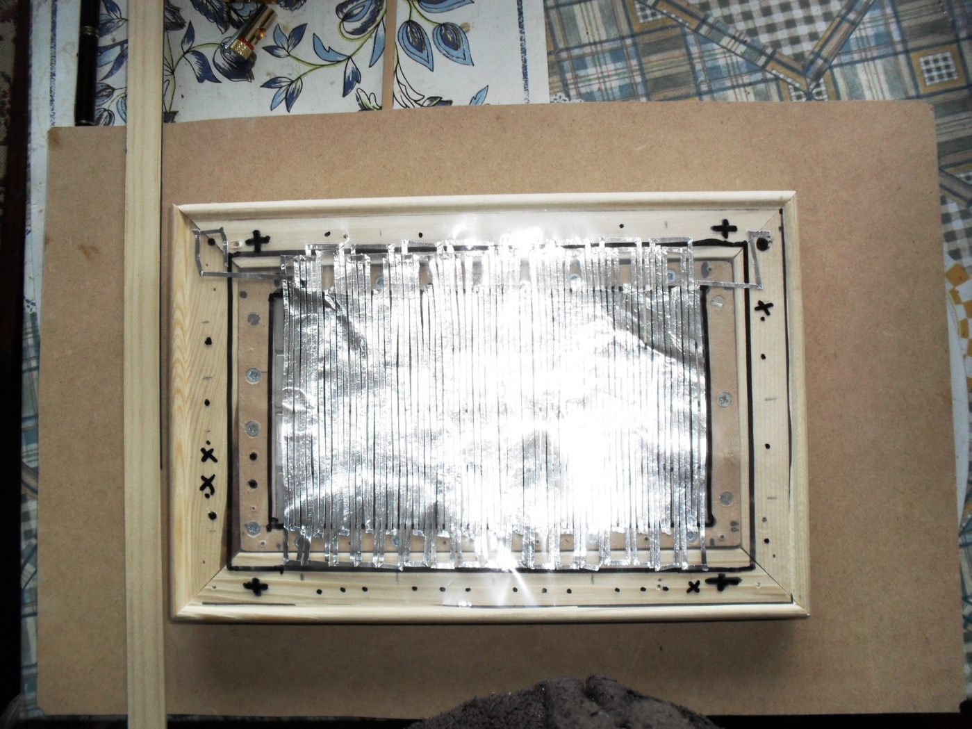

latest rebuild
Used 45 meters of tape only 51/8 finished got to measure how much is required. See if I have enough in my other remains of 45 meters, if not will have to use another 45 meters that is the other half of the cut. The diaphragm will be heavy , all that tape. Will have to use a penny washer to join the 2 layouts.

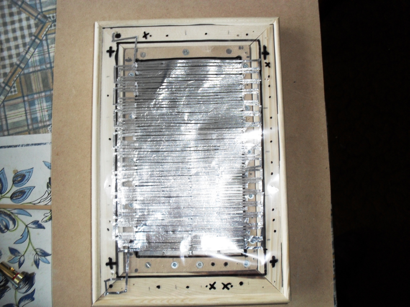

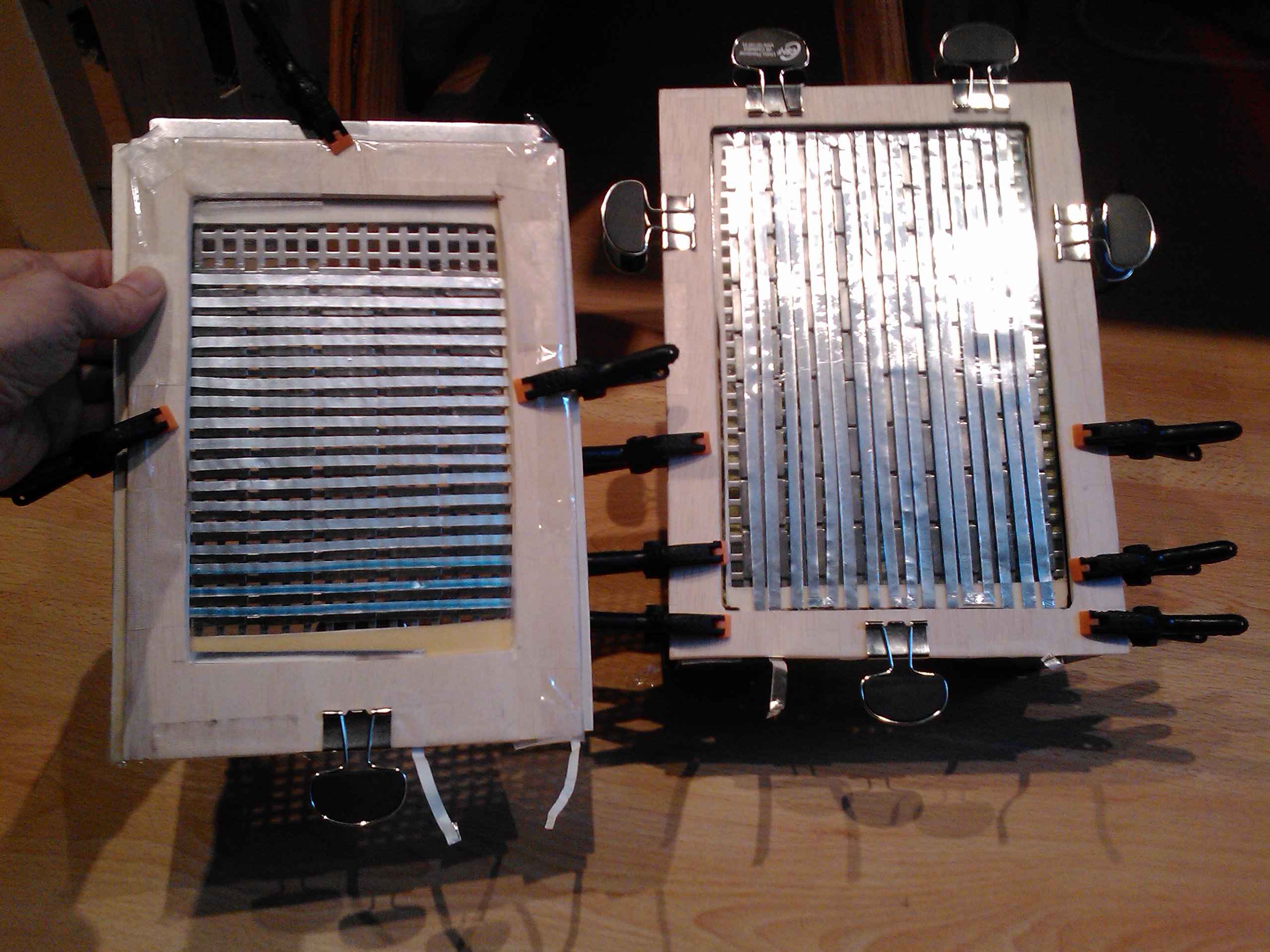

Quasi Epsilons
Quasi Epsilon configuration.
I've just finished another mock up of the mini planars. Using the same amount of magnets, *i.e. more or less the same magnetic field, but increasing the util surface, *and puting more Al on the gap.
I called the configuration Quasi Epsilon, but probably it is not. It's just the epsilon with only two conductors per gap or the standard with doble run of Al tape.
The test are encouragin, but still the real test can't be done before a run in time, and a re strech of the membrane.
I'll try to post some pics later

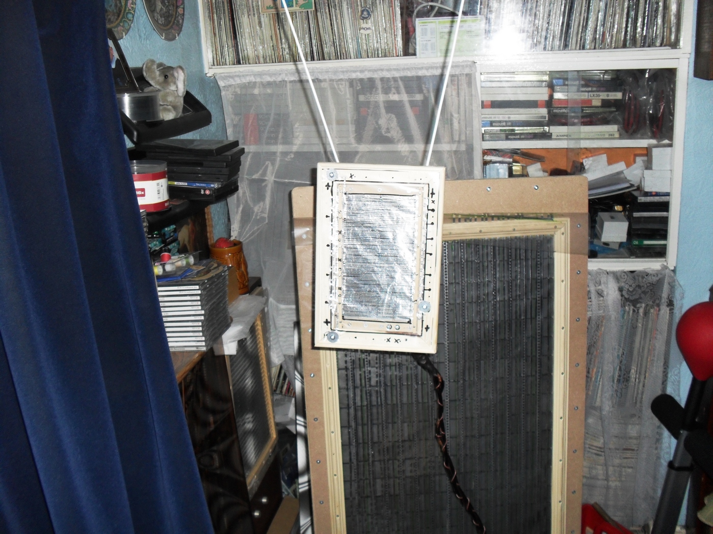

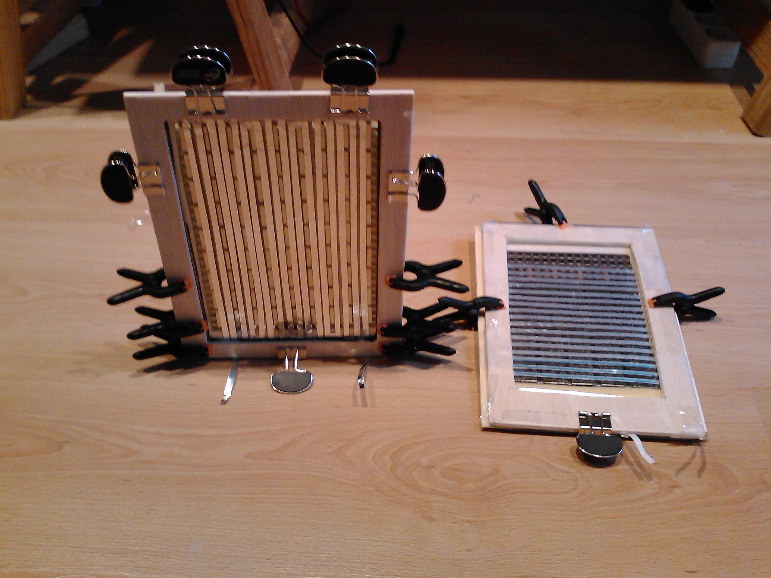

some pics
The quasi Epsilon and her little sister.
the bigger the better.
The sound gets better with the size, the tension of the membrane and the stifness of the frame.
may be one last mock up and ready for a pair on my desktop...

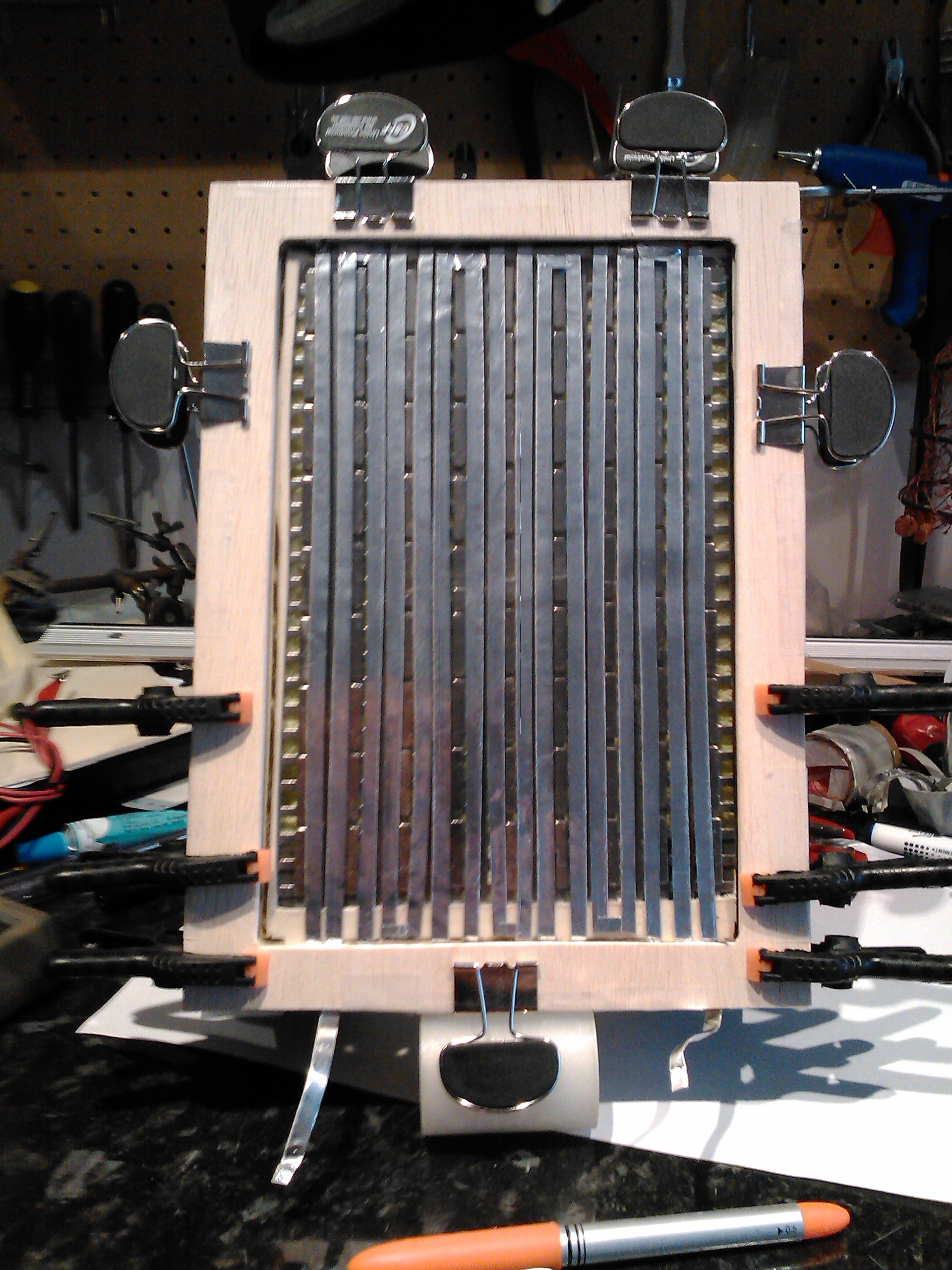

A4 SIZED PLANAR.
I mended the hole with a penny washer always works. Running with the big one on the right at the front on the floor.The A4 is 8.7 ohms. I had to turn the big one down by about 5 Db, so not too bad sensitivity! Not getting hot diaphragm or 25 watt resistor. Not finished yet just a quick mock up to see if it is worth the trouble of building a pair.Quite happy with it so far.
