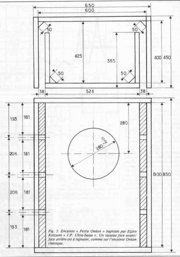

Mini Onken clone driver question
I'm looking for some driver advise to rebuild the Onken to support my Oris Horns.
It seems quite difficult to find information and background for this speaker. In all designs i find the used speakers are no longer in production and very hard to find. The only current one i found plans for are the Onkens using a Supravox 280 speaker. Which is a little bit too high priced for me. The attached Speaker used an Altec 414. I looked up the thiele & small parameters for this speaker :

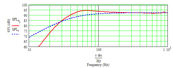

Anyway, here's a reasonably accurate sim of it using 414-8C published specs with no output series resistance from the amp or in-line inductors or small gage wire, so very under-damped:
GM

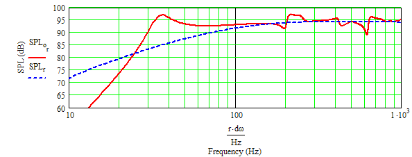

WRT pricing, I don't have a clue what any drivers cost in Germany, only here in the USA, so you'll have to give me some makes/models that stay within budget. Anyway, with only 150 L available the options are very limited if driven with a ~matching impedance amp as the F1 appears to be since the specs will need to be suitable for mid-bass horn loading, which also means little Xmax in many of them. Also, if indeed the amp's output impedance is 8 ohms, then getting 'fast' bass will be hard to come by without going ~aperiodic. For instance, assuming the B&C 15NDL76 is within budget (all dims i.d.):
~37 Hz Fb:
H = 30"
W = 18.81"
D = 16.25"
zdriver = 14.5"
zport = 6" dia x 5" long down near/at the bottom
Sim with 8 ohms series resistance. Stuffing the vent will flatten the response and lower Fb if it's not 'fast'/'clean' sounding enough:
GM
