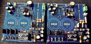

Was able to test the amp today, I got 45Watts into 4 ohms resistive dummy load using 8Amps 24-0-24VAC transformer. (Single channel driven)
As for the sound, It has a wide soundstage and superb detail, the instruments sounded lively.
I compared it to my LM3875, this one has more detail and the bass has more punch. The LM3875 is much softer/smoother though.
For me the sound character is much like BAKSA 50 but with more refinement, more details and more accurate bass. 🙂

That's a very nice build by the way.
I'm new to Chip amps. I'm going to build a simple version first to see how it goes. But it's interesting to read about other designs. This design appears to use the LM3886 as a current driver and another opamp for the voltage gain.
So when listening to this amplifier I assume that it is the LM318 that 'sets the tone' for the sound and not the LM3886 ?

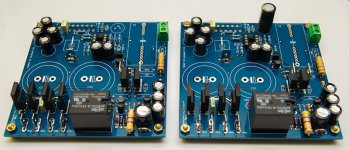

I had a request from a friend in a local forum to create a My Ref Rev C layout which uses an LM318 supply similar to fremen, and putting ample space for input capacitor. I also provided a jumper (computer motherboard/harddisk jumper) so that the input capacitor can be bypassed easily. This one also uses a better circuit for speaker protect.
Size: 3.9" x 3.9"
PS: For my personal use only, not for sale. Only showed here for gallery purpose.
Size: 3.9" x 3.9"

I understand boards are for your personal use, nevertheless it would have been nice to see credit to Mauro Penasa... at least.
+1 Credit where credit is due..
Yes, my bad.
Next time I'll put mauro penasa's name on it.
There's really no more space on the top pcb that is visible when all components are soldered. So I can't put all the credits for the parts of the circuit.
