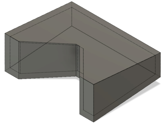

Hi all,
I'm starting a new project a little bit crazy (need to keep busy ^^).
There would be 2 speakers + 1 compression driver.
For the design, I was thinking about something like that:

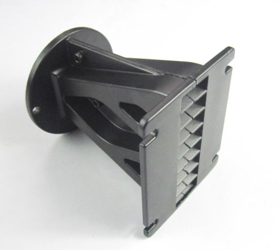

Dimensions are 50x35x20cm approximately. With the compression driver mounted on a waveguide like this one:
The two mid/bass will be located within the horn walls.
Regarding the opening angle of the horn, I haven't decided anything yet but I was thinking something around 90 degrees. To be confirmed with a simulation.
For the low/mid section, I've selected 3 drivers that could suit: FaitalPRO 4FE32-4, 5FE100-4 and 6FE200-4.
I've done the first simulations with Hornresp (7L for the 4" and 5", 10L for the 6").
The front face of each speaker will radiate in a kind of horn, more a duct in fact (circle equal to Sd, 3cm deep). This explains the (wanted) ascending slope and the resonance at 1kHz.
I'll choose the driver size according to mechanical constraints (not sure if the 6 inch driver would fit ^^).
And I might completely change the dimensions because the volume is too big (15.4L but the drivers need only 8-10L).
In light of the above come some questions
And the filtering between boxes will be active.

1) speakers with pattern flip always sound 'weird' to me, and it's not possible to fix them with EQ because the problem is the polar pattern
2) If you need a tweeter with narrow vertical directivity, ribbons and AMTs are cheaper than compression drivers and sound better. The advantage of a compression driver, for a line array, is maximum output. If you're listening at home, you probably don't need to generate 130dB.

Ribbons and ribbon-shaped compression drivers have a vertical directivity that's basically zero.
Because of their shape, when the wavelengths are shorter than the height, the directivity will be close to zero. For instance, a 4" tall ribbon will have zero degrees of beamwidth down to about 3khz.
But after that frequency, the beamwidth expands dramatically and nearly instantaneously. The net effect is that music and voice sound weird, because the pattern is wildly asymmetric.
I've built a ton of horns for car audio, and this asymmetry is the reason that most people get sick of horns in cars imho.
In a commercial line array, the elements are stacked vertically, which dramatically increases how low the array can maintain beamwidth control.
For instance, if you use a FORTY inch ribbon instead of a FOUR inch ribbon, the frequency goes from 3,375hz to 337hz.
In a line array, the narrow beamwidth is a "feature" not a "defect", because it prevents them from interfering with each other.
Basically there's no good reason to use a single element line array IMHO. If you don't need huge SPL, go with a conventional two-way. I have some Yamaha DXR 12s, those are nice for that.
