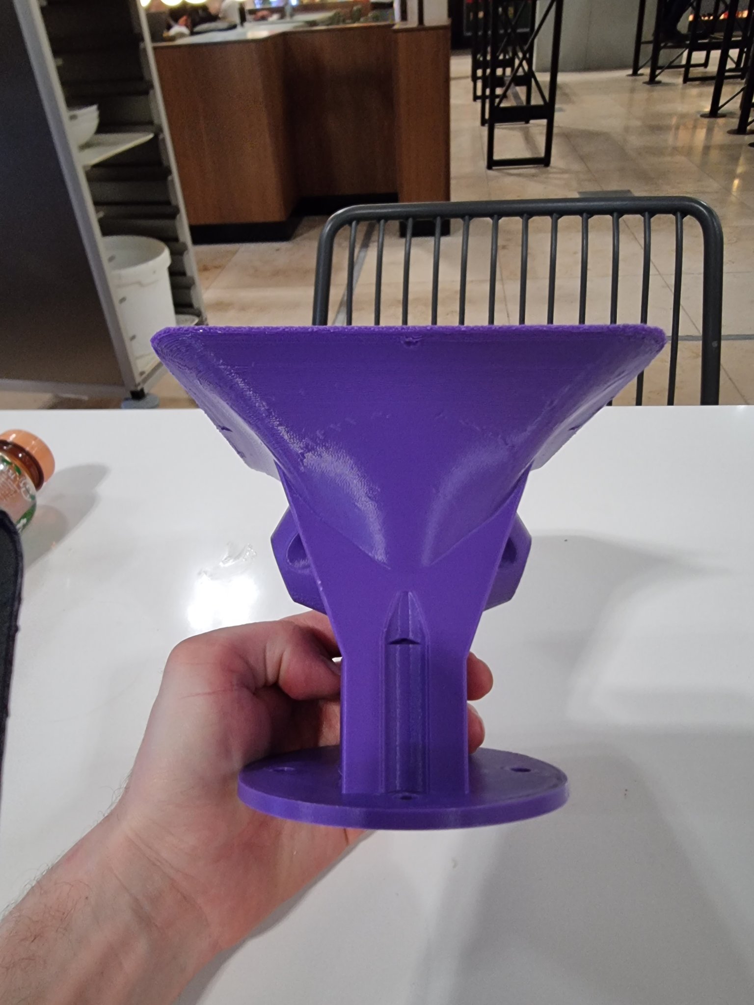

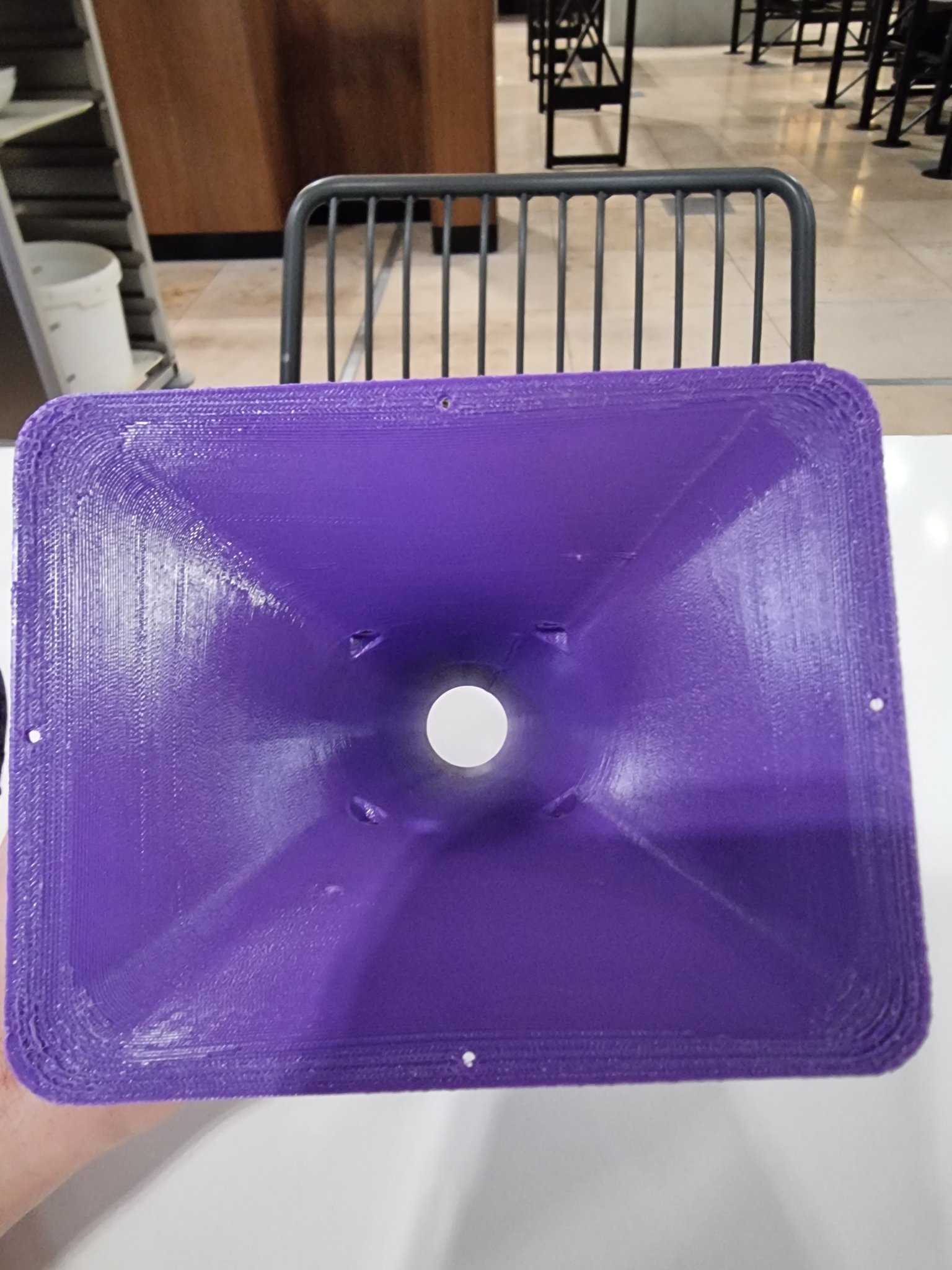

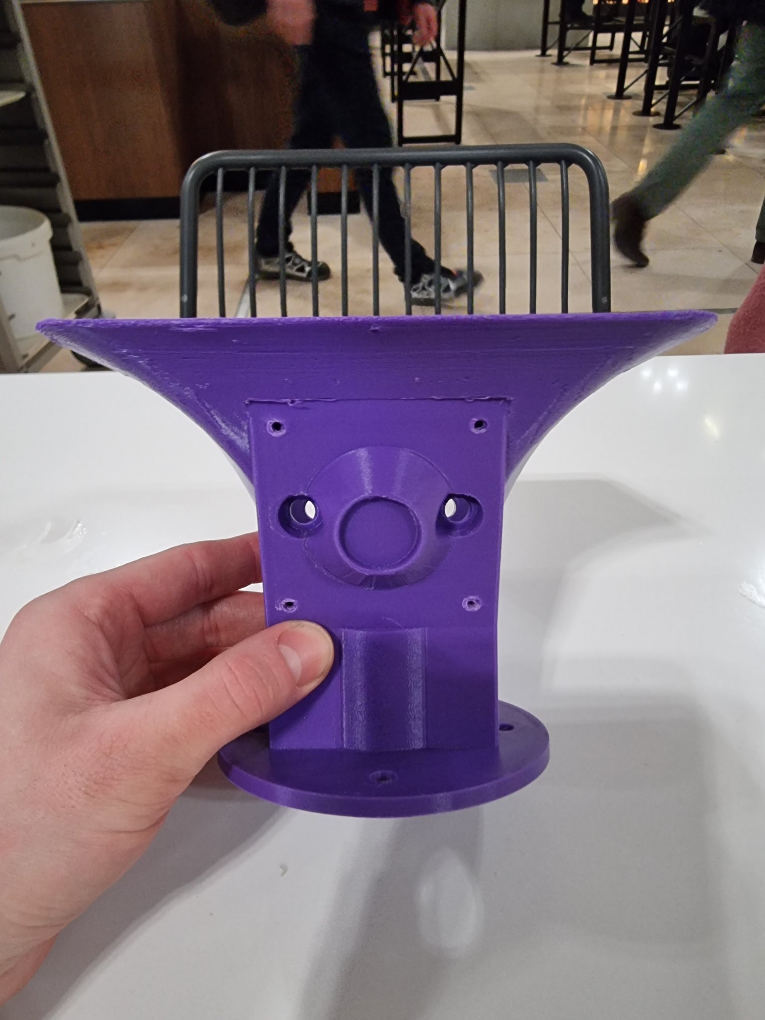

Over the past weekend at a Hackathon I have designed and printed a small MEH. I used ATH to generate the horn then simmed the HF and measured it to compare. I then also decided to add some midrange 2" drivers to see how it would turn out.
I am so happy with how it turned out for 1 weekends worth of work and not really any simming haha.
On the midrange measurements there is a big dip at around 1350hz the length of the horn is 120mm which would be half a wavelength from inside the compression driver to the horn mouth. Do you think that could cause the big dip at 1350hz then boost (1/3rd wavelength) at just below 2000hz?
The drivers I used were ones that were already here, it was two Faital Pro 2FE35 and a Lavoce DF10.172k which is way overpowered for the midrange haha. The rear chambers were made out of tape and hot glue.

Some pictures of the measuring process:

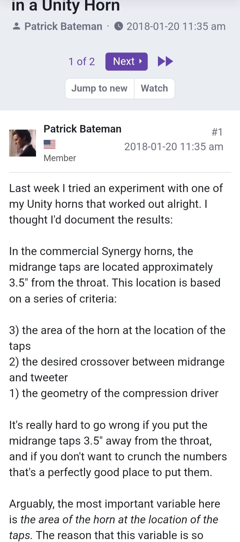

The sharp (high Q) dips ~2.6kHz & 3.6kHz may be the result of the out of phase reflection between the mid port holes and the virtual horn throat, which may be somewhere in the compression driver phase plug.On the midrange measurements there is a big dip at around 1350hz the length of the horn is 120mm which would be half a wavelength from inside the compression driver to the horn mouth. Do you think that could cause the big dip at 1350hz then boost (1/3rd wavelength) at just below 2000hz?
The mid response rises smoothly from 400 to 2kHz, other than the dip ~1.6kHz, which may be related to the geometry of it's enclosed "phase plug" (cone filler) volume.
Nice results!
I will do some more testing to figure that out.
That cancellation does match up with the length from the horn mouth to throat.
I might redo it but make the horn slightly longer, keeping all other dimensions. Testing if it is related to the horn length

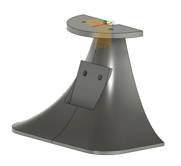

The taps are 70mm or 80mm away from the compression driver from memory but will check later.
Which would be a cancellation around 2145hz maybe a little lower for the distance inside the compression driver at 80mm
It is a really short horn haha, 120mm length which is why they might seem further away

The area the midrange taps are in supported up to just below 2k, I think the cancellation at 1.3khz is also boosting 2k so rolling it off a bit later
This is tiny and not really suited for PA use, was more a test.
120mm x 120mm x 160mm not including drivers (Fit on a print bed in a single print)

I am planning on building a 2" version, 3" version and 4" version. See what frequency I can get up to with each.

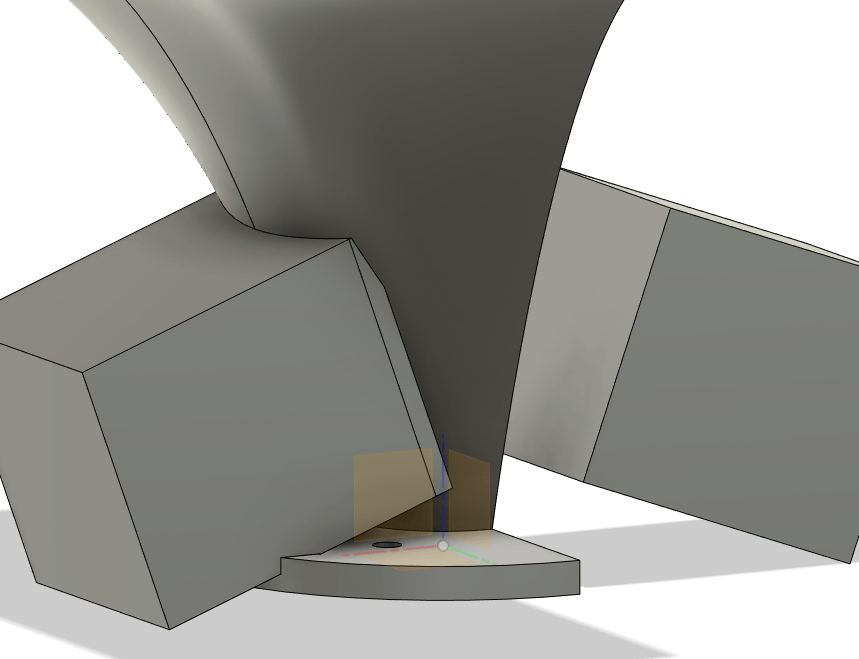

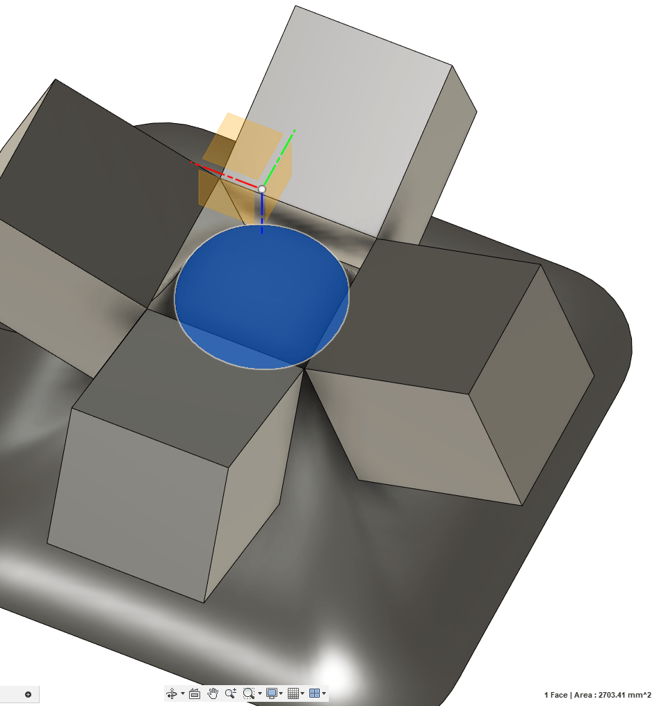

I have tested in CAD for four drivers and I think the highest I would be able to push the 2" drivers to would be ~1861hz
area of 2703mm3 would be a wavelength of 18.43cm and 1861hz
(I would add the other two drivers)

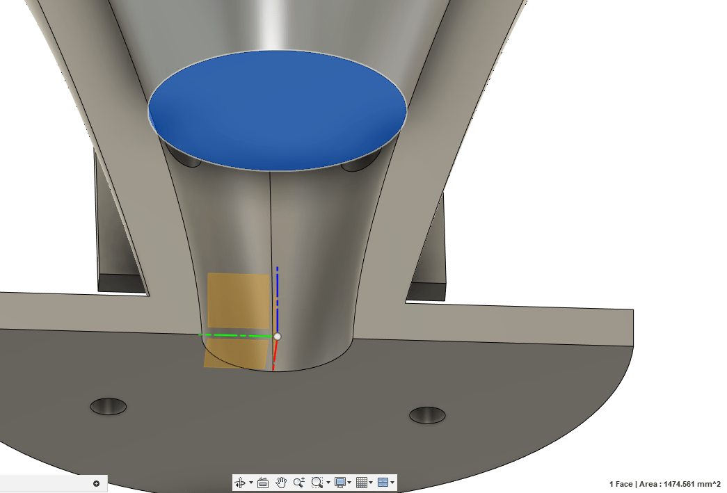

With two drivers I think it might be possible to get 2.5k out the 2"
1474 mm3 would be 13.6122cm wavelength and 2520hz
Ports would be max 3.2cm away from each other across the horn
Ports are 4.3cm away from the compression drivers which should only cancel above 3khz (adding some distance inside the compression driver)
I will finish model and try printing it and measuring it, hopefully it will print well in one go on my printer
