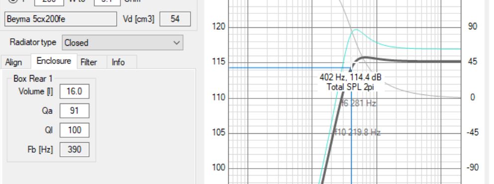

I did some research and I found a driver combination that would work for a 3 way version.
For a coaxial I could use the Beyma 5cx200fe for highs and mids. According to VituixCAD it will need to be crossed to a low mid woofer at ~500hz. They recommend crossing it to the horn at 3,500hz. The published response for the horn looks pretty even
Then I can use 2x FaitalPro 6fe100. This will cover 100-500hz.

That Beyma Coax has a low Fs for such a small midwoofer…..I would not hesitate to cross it to your woofers in the 350hz range. At that point, there’s no need for tilting anything…..you’re well within center to center distance 1/4 wave area to avoid any destructive combing. My little KEF UniQ 5” center is crossed at 250 to a pair of 6” woofers and the speech intelligibility is fantastic out to +/- 30 degrees.

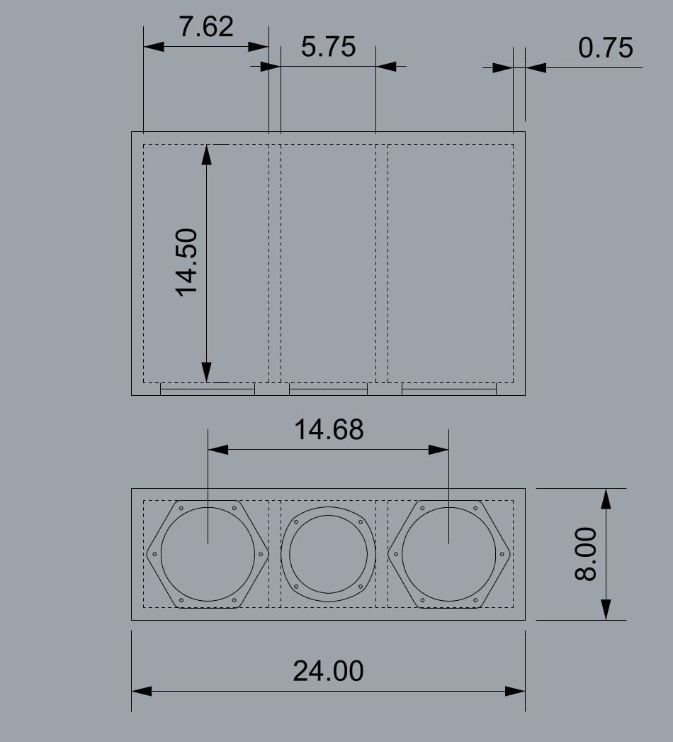

Here's a rough drawing that seems to work OK. The simplest design.
These drivers don't really seem to care what size enclosure they are in.
The proportions look like what I would expect from a center channel. 24"x 16"x 8".

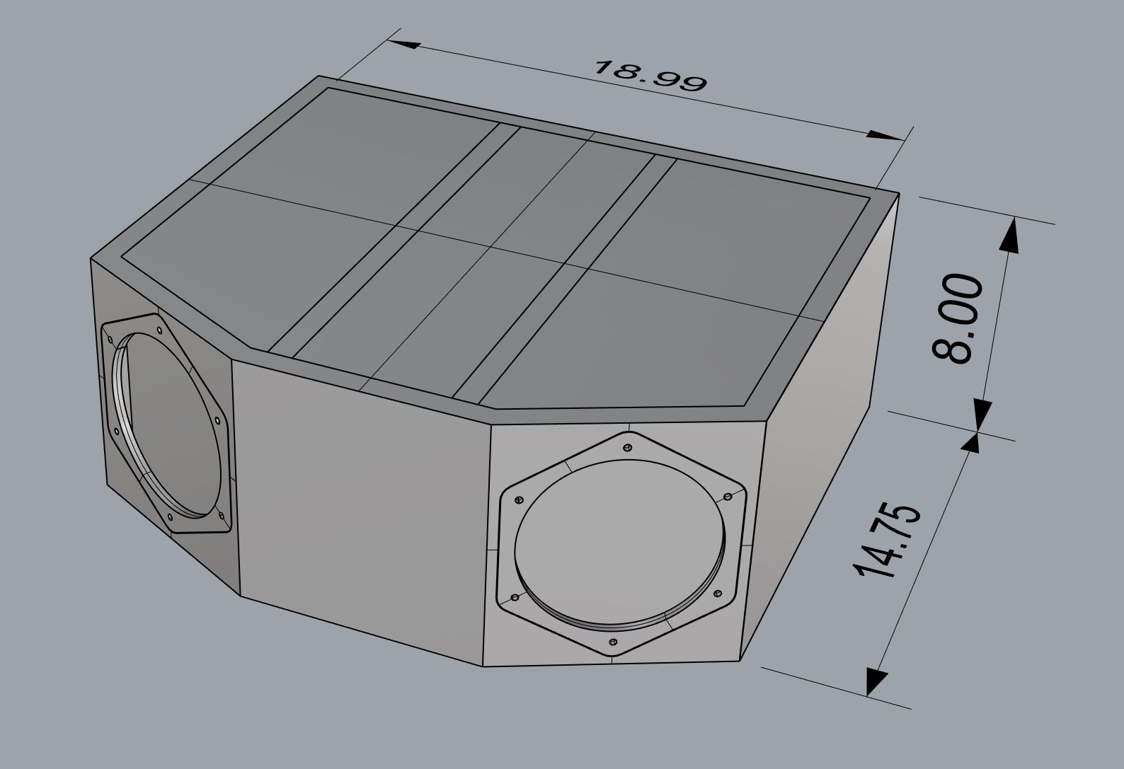

This would work, but I still think I want to angle the drivers. Why? Because I want to build it into a TV stand with 19" racks built in. So I'm tempted to squeeze this down to 19" (internal width)
This is probably a smarter way. I'm still thinking of a design to double as a surround speaker. It is starting to look like something to me.
One idea was to try to copy Genelec's "Concealed Woofer" design. I'm seeing that possibility re-emerge. I just need a "wave guide" baffle across the front. I don't know anything about designing a functional wave guide, so I'll try to come up with something that looks the part.

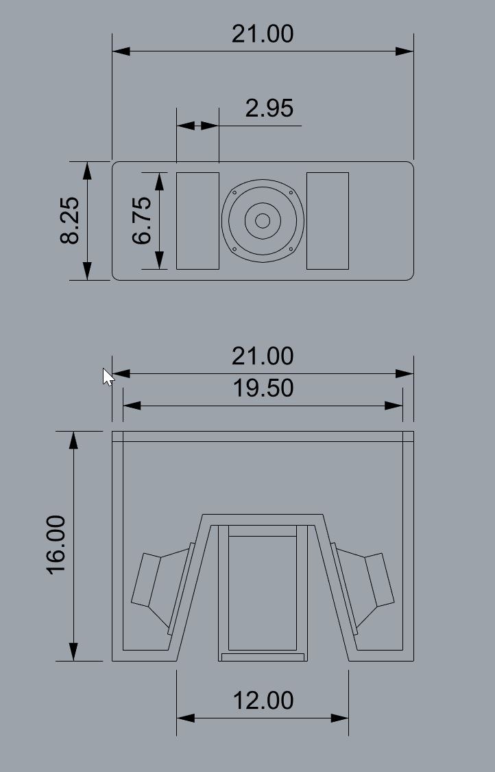

Back on track. This is the 3-way version. The openings for the woofers are 12" apart, so that should match the directivity of my 12" coaxials.
The "box" in the center is for the 5" coaxial, and it has to be removable so I can install the drivers! The real line array does essentially the same thing. I thought about making it a cylinder too.
I thought 8" was still kind of tall for a center channel, but I did some research and found many center channels are around 8".
I was also thinking about hiding four 5" woofers inside to reduce the height. Maybe I'll draw that up tomorrow...

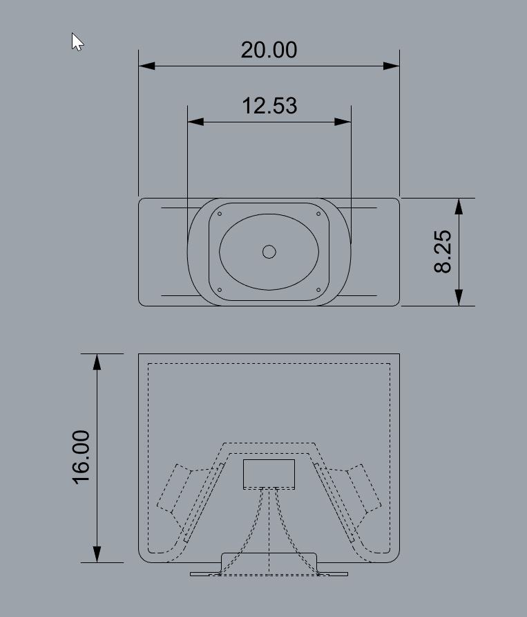

Here is the 2 way horn version. The Faital Tactrix horn claims to work down to 800hz, but most likely I'd still cross it around 1khz.
I know next to nothing about compression drivers, so for this drawing I used Faital HF10AK dimensions. Horn is Faital LTH102. Any expertise on compression drivers is welcome!
