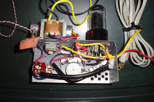

What brings me to the forum is that I am a hobbyist guitar player and recently bought a single tube 25L6GT Webcor amp for a few bucks and was planning to make a 1 or 2 watt guitar practice amp.
Here is brief description and issues amp:
First, amp does not work, I get hum and some crackle. I tried a new GE tube and still does not. My guess is that the electrolyitc capacitor is dry. (capacitor reads 50 MFD 150V) I have not been able to find one to purchase.
There is a tag that reads Amplifier No. 14X351-2 . No power transformer, single tube 25L6GT. 3" speaker that will be replaced. One volume/on/off pot and another I assume is tone.
There is a red wire and a yellow wire that I am assuming are the input but not sure. Another couple of wires are not connected but these are very thin, I assume they are for a led or light.
Can the 25L6GT tube be replaced for a more guitar compatible tube without modification to the circuit? can I use a "more powerful" tube? (if that is even a question)
I am attaching a picture of the actual amp.
Any help would be appreciated.

Jorge,
First- welcome to the forum!
Second- be very careful! No power transformer means power is taken directly from the mains and therefore it is possible for the chassis to become 'live' which is a bad thing.
Please take the time to read the safety thread on this forum. Lots of good info there. Tubes generally use high voltage (this amp probably uses between 110 and 200V which is actually low in the world of tubes).
I'm not familiar with this amp but I can try to answer a few of your questions.
1- Replace the electrolytic. It is a common value and rating. By the way you can replace it with a higher voltage rated cap. If you can't find a 50uF/150V cap you can use a 50uF/250V in its place. Stick with the original uF rating (within reason, a 47uF cap would work just as well).
2- Check all the resistors as the older carbon comp resistors can 'drift' in value. It wouldn't hurt to replace them as well. Use quality metal film resistors.
3- The 25L6GT is a beam tetrode tube. It has a 25V heater (thus the '25' in its name). Not an extremely common arrangement these days in either hifi or guitar amps. But tubes are still available as you found out.
The VT201C is a replacement. Changing the tube to something else would require essentially rebuilding the amp.
In class A (which is the case with this amp) it is good for about 3 1/2 watts peak with around 200V on the plate and about 2 watts with 110 volts on the plate. That could make a very good practice amp with the right speaker. Check out Antique Electronic Supply or Angela Instruments for suitable speakers.
4- I am not an 'expert' and am not familiar with this amp. In particular I wonder about the input stage, where is it? Is it sensitive enough for guitar? Others above my salary grade can probably answer that.
Be careful, have fun and look at this as a learning experience. Don't be discouraged if things don't work the first time.
I'll also say you should not spend anytime electrically connected
to any equipment that does not have an isolation transformer.
Plugging your guitar into it I regard as being very connected.
Very dangerous ....................
🙂/sreten.

You can add a three prong plug and a fuse but that doesn't solve the problem. An isolation transformer separates the amp from the mains and is far cheaper than a funeral. :angel:
When you plug your guitar into an amp with no power transformer then you are electrically connected to the amp. If the chassis of the amp is live due to a failure of a component or even just plugging the plug in the wrong way round and you then touch anything that is grounded you get fried. :hot:
Jorge,
I hope you paid a very few bucks for that POS. As has already been stated, that thing is DANGEROUS. Please notice the POOR quality phenolic wafer tube socket. That thing under the O/P trafo that looks like stacked metal squares is a Selenium rectifier and it's a toxic time bomb. Also, you didn't acquire the preamp electronics needed to raise a LOW voltage signal enough to drive the 25L6.
IMO, you should save all 25L6s you have along with the O/P trafo. Sadly, all the rest is trash.
Look here at another thread on this "board", where getting respectable performance out of the very similar 50L6 is discussed.
The 25L6 draws 300 mA. of heater current. That can be safely obtained from a Radio Shack Catalog # 273-1366 transformer.
The preamp circuitry you use will vary in complexity depending on your choice of options. If you forego a tone stack, a 12DW7 should be enough to drive the 25L6.
