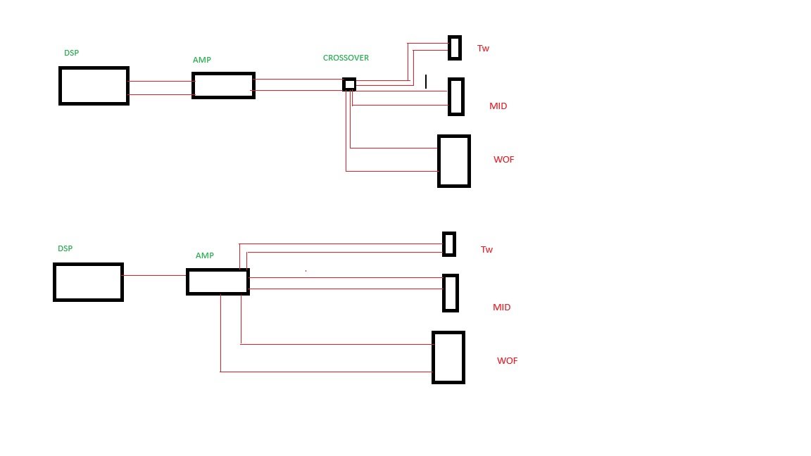

A few questions from me because I'm already lost completely.
MiniDSP:
I have no idea how to connect it:
1. should I skip the original crossovers that are already in the speaker and connect the drivers to the mini DSP?
2. the original crossovers are to remain in the speaker and I am to connect only the Mini DSP to the speaker terminals?
System:
300B SE AMP--> Tannoy Gold 15
Check pics.
The Mini dsp is à Advanced crossover so the order is:signal source — preamp—minidsp—Two Power amplifiers— ome direct connected to tweeter the other amplifier to the tweeter.. before that you have to program the dsp to set the parameters of the crossover.
