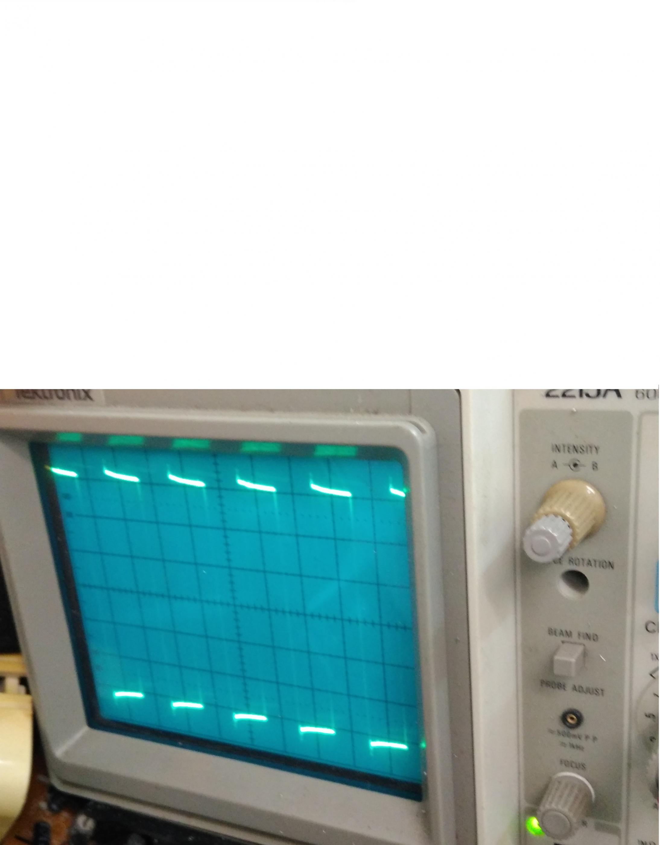

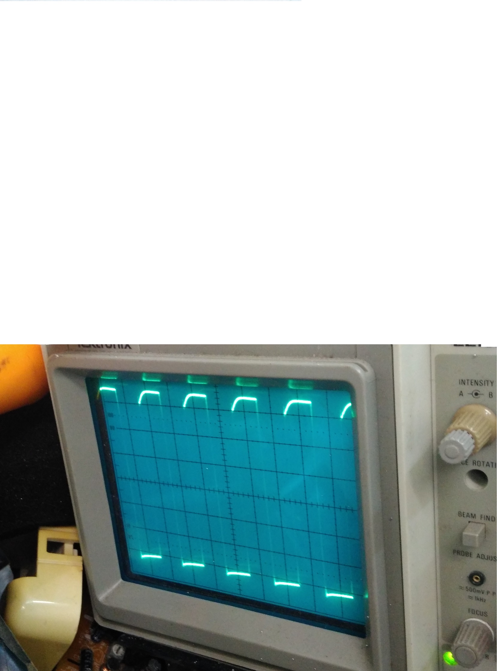

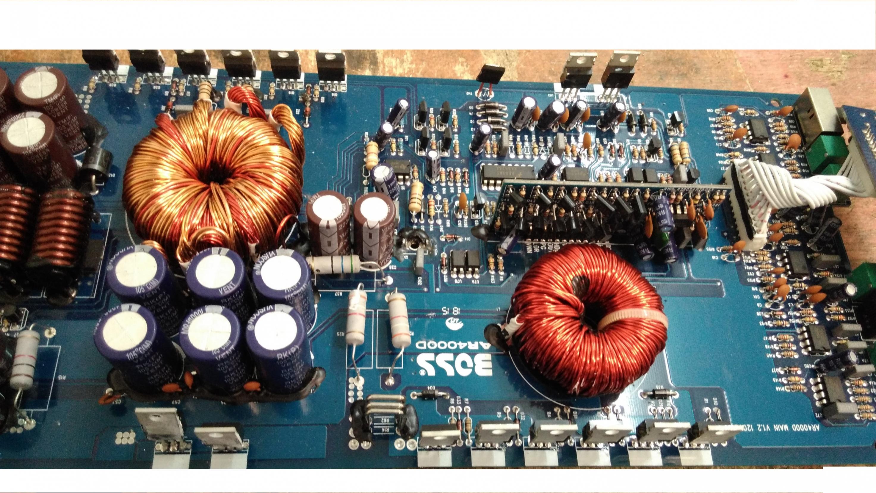

The high side FETs heating up fast. original problem was shorted outputs.I replace the two 42s and all outputs.
20v/dv 10us
signal on the high side FETs

For the FETs that are heating up...
How long does it take for the FETs to get too hot to hold you hand on them?
Is there any DC offset on the output?
Do you have a load connected?
Measuring with the black probe on leg 3 and the red on leg 1, what is the DC voltage measured on the high and low side FETs?
I think you may need to calibrate your probe (not critical, just a note).
The curved part at the top of the waveform that extends above the positive rail is drive voltage. The rising side is curved because the gate capacitance is being charged through the gate resistance. The falling side of the drive signal is more vertical because there is essentially no resistance in the discharging of the gate capacitance.

Yes IRFB32N20D
I got them from an authorize distributor.I also repair two order amps with FETs from that same batch.I will install the rest of FETs that survived to make sure.
Also the 100v/220uf caps on the output if they are bad can i get results like this?
I went back to this amp toady and now it has more problems.
With the high side FETs in circuit it will cycle power and protect.When i remove them it will power up.
Other problem before that was the high side FETs would heat up at idle even after i tried a next driver board.
