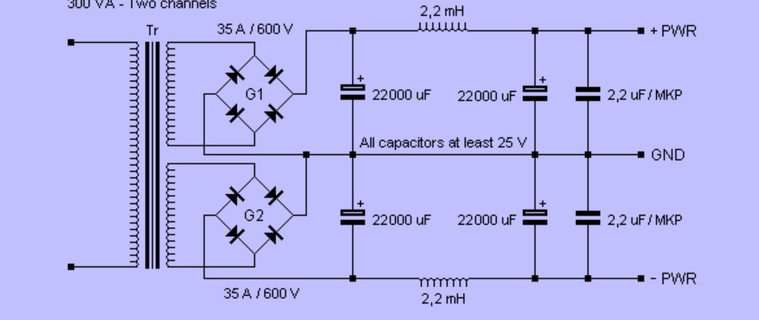

its the basic brute C-L-C power supply

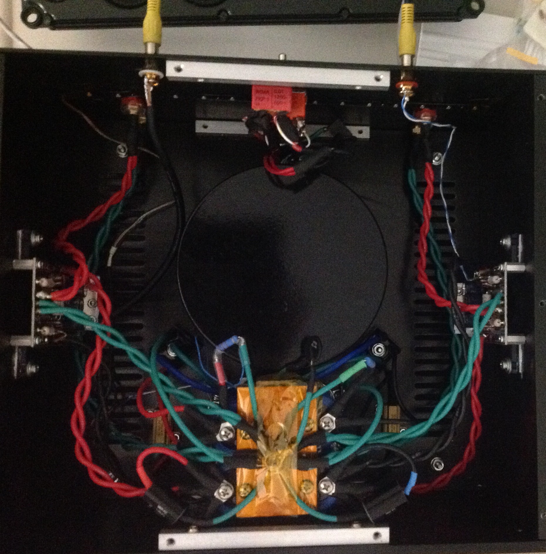

pictures and complete info about PSU

PSU is c r c, 15,000uf to 0.1ohm to 15,000uf per rail
each rail has its own full wave bridge rectifier. smaller resistors in photo
are bleeder resistors. Also Solen 0.1uf on the outputs of the psu. Transformer is Antek, shielded wire to chassis ground with steel cover on it.
I have tried 100k shorting input to ground. Adding 120ohm parallel to x2 cap between AC ground and chassis. The star ground at the CRC's has a CL60
between its star ground and chassis. the minus speaker terminal goes from star ground directly to speaker post isolated from chassis.
I swapped twisted pair wire on one channel with shielded wire and that did not
help.

Are you connecting bridge output (noisy) to the star ground? If so, I have read that it is not a good idea. I'm not an expert, so I'm not really sure, though.
it is pretty much this CRC supply with dual FWB mounted to chassis
resistors also mounted to chassis
Antek 12V 400VA with shield cover--->33,000uf 50V--->0.1ohm 25W--->33,000uf 50V--->1uf solen mkp cap
there is a 2k bleeder resistor off the last 2 caps
nothing fancy here
2 CL60's on transformer mains and 1 CL60 from psu star ground to chassis
AC Ground and chassis has X2 cap in parallel with 120ohm resistor

Thanks but cannot rebuild.
I took the toroid out of the center of the chassis and move up and out to one side.
There was no change in the hum so its not emf.

Shield wire frok antek toroid disconnected or connected to chassis made no difference either.
I have built few other aleph and F5, some tube pre's. This one seems to be more troublesome.
I only have this one antek toroid so also wonder if its the toroid itself that is the cause.

I've used surplus computer grade caps without issues. You have
33000uF + 0.1 ohm + 333000 uF per rail, and unless there's something
seriously wrong with the caps, that should be adequate. (The Aleph 30 has
about 120000 uF capacitance in total).
