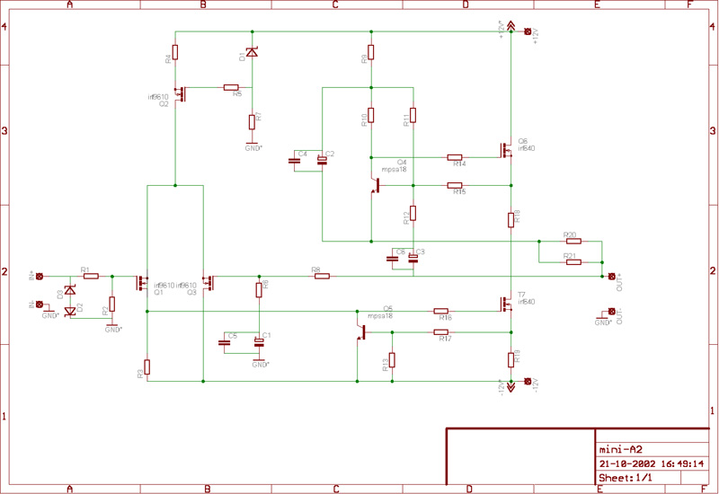

I have made a board for the Mini-A and would like to hear some opinions on the layout.
I have added protection diodes on the input and the possibility of bypass caps for the electrolytics. The board are two layer. The top layer hold the ground level and the bottom holds the signal and power.
Here's a picture of the layout. The actual films will be posted in a zip file when I decide not to change them any more (a day or so).

In addition to putting the output devices closer the the edge of the board, I like to have the outputs positioned closer to the edge. I also don't like resistors placed vertically since it puts more strain on the resistors and the pcb. It wouldn't take up much more space with them positioned vertically. Also, you can get away without a heatsink for Q1 - Q3, but I would leave room for heatsinks, and possibly putting Q1 and Q3 on a shared heatsink (with insulators) for better thermal tracking. The only other suggestion that I have is that you could leave more spacing for the caps, in case you decide to try some exotic caps later. (there are only a couple used, so the cost could be justified).

So, here are the much cleaner layout.
Featuring:
More room for power resistors, room for heatsinks on Q1-Q3, output devices on edge. Option for protection diodes on input ( 9.1V zener). Multiple holes for the cap of your choice.
The board are two layers, the top is the ground level. Of course you could easily use a wire instead, because there are only five or so ground connections.
Note: you have to download all three parts of the zip. Final size =202kb. Print films are in PDF format and should print correct size at 600 dpi.
I must say that I haven't build the boards yet, so they are UNTESTED. Don't kill me if they don't work, kill your cat. :fight:

May I suggest 2 things
1-using irfp044 as the ouptut devices, they are much better in just about respects. Maybe you could provide dual pinouts.
2-put the CS and the diff pair Q's closer and on the same line so one can thermally couple them with a thin Al strip.

Moving Q1, Q2 and Q3 closer is probably a good idea, thanks.
I think the option for to-247 style transistors sounds like a sound thourgt. Afterall, in Grey's original introduction it sounded like this was meant to be buildt with spare parts you allready have, so a few possibilities aren't bad at all. 🙂
