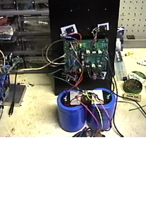

Two output devices, eh? Now, that's interesting.
