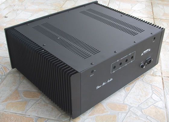

This is the chassis I ordered from China - it will take FOREVER to arrive (possibly 2 months?), but it was relatively cheap at $180 shipped.
Thinking about possible doing a Group buy, but work is keeping me extremely busy...
Anyway, I bought the 4U version of the Pesante Dissipante from that Italian website and this one looks to be nearly identical to the 5U version in looks, heatsinking, and overall dimensions. I am quite pleased with the 4U Pesante Dissipante, although the sinks are a bit too small for the Aleph 60 or Krell Clone, so I bought this one from China.
Need to get that Dunn Mei printing off - hopefully a bit of alcohol and light rub will work, but the on/off switch, and rca, IEC and binding post cutouts are there, so a decent tradeoff.
The 5U Pesante Dissepante spec sheet says the heasink is rated at .23C/W
Also says with 6 devices/channel, it will sink 375W total (yeah, but at what temp?).
The seller did not know the heatsink rating, so I am making an educated (?) guess due to its similarity to the 5U Pesante Dissipante (PD from here on out, as I am getting tired of writing it)
Can't yet vouch for the quality of the Chinese chassis, as it has not yet arrived, but I know he has a lot of them to sell...and they look quite nice

Joined 2005
Pic of rear
More specs from Lawrence...someone wanna take the heatsink dimensions and make an educated guess of its rating? I am guessing .23C/W - .25C/W.

Joined 2005
I originally bought this chassis for the Krell Clone - I would be setting the bias to a max heatsink temp of 50 - 55C.
Hmmm, well, I can always experiment with adding an internal heatsink inside the chassis, or add a fan, or upgrade the sinks.
I got tripped up on the "Aleph 60 draws 240 watts from the wall at all times and most will be seen on the heatsinks"
Figured I would have enough sink with this chassis for the 240W dissipation total...
Joined 2004
That's a pretty nice "Heavy Durty" chassis! I would stick a stereo A60 in there and see how hot it gets.
Am I reading that right, that it comes supplied with the on-off switch (not just a hole)? I would make a cover plate for the rear speaker binding post holes to use dual banana posts. Depending on how nice your amp turned out, you could have a new thicker face made (or take it down to your local anodizer to see what colors he has). Nice find!
