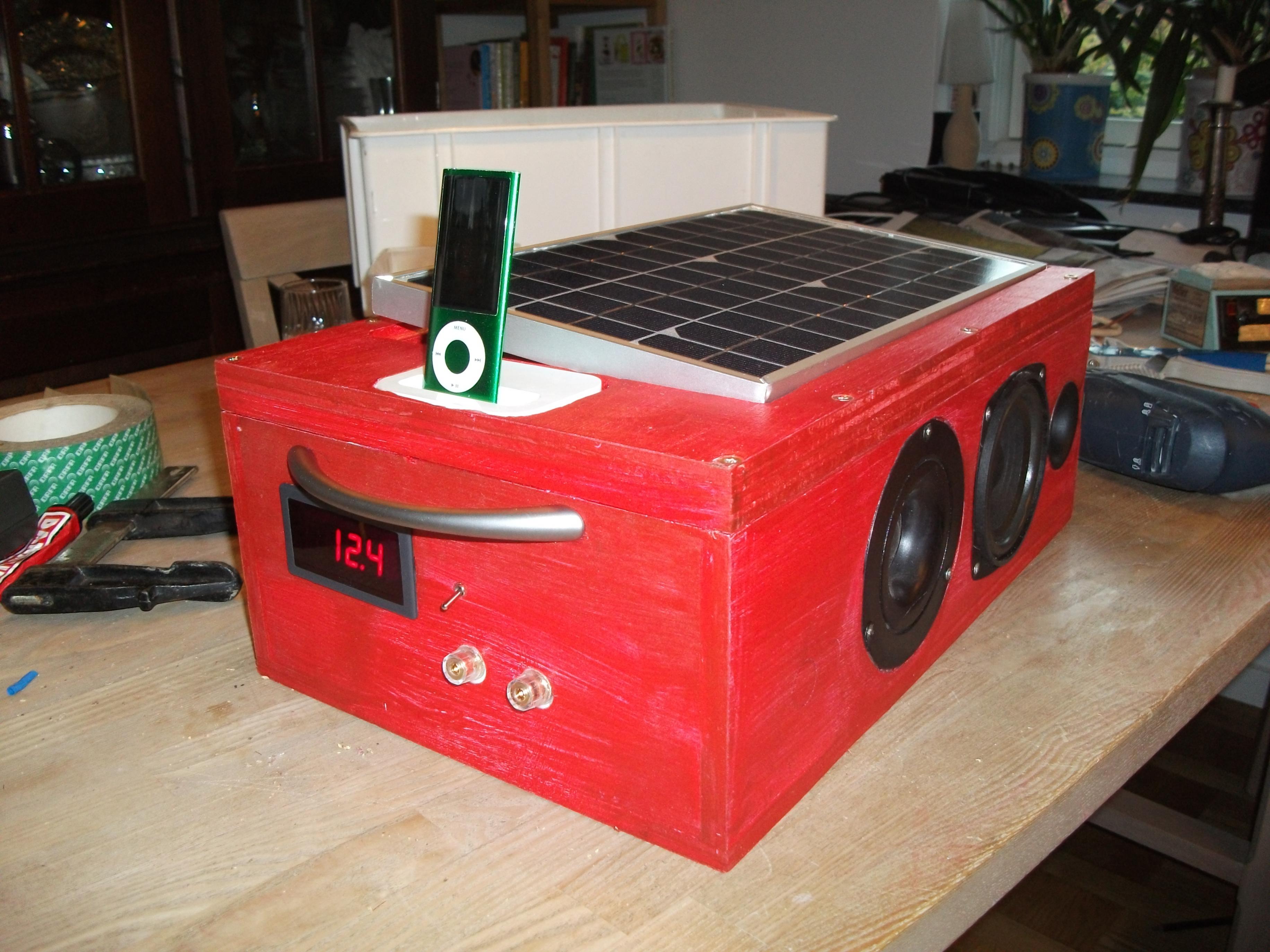

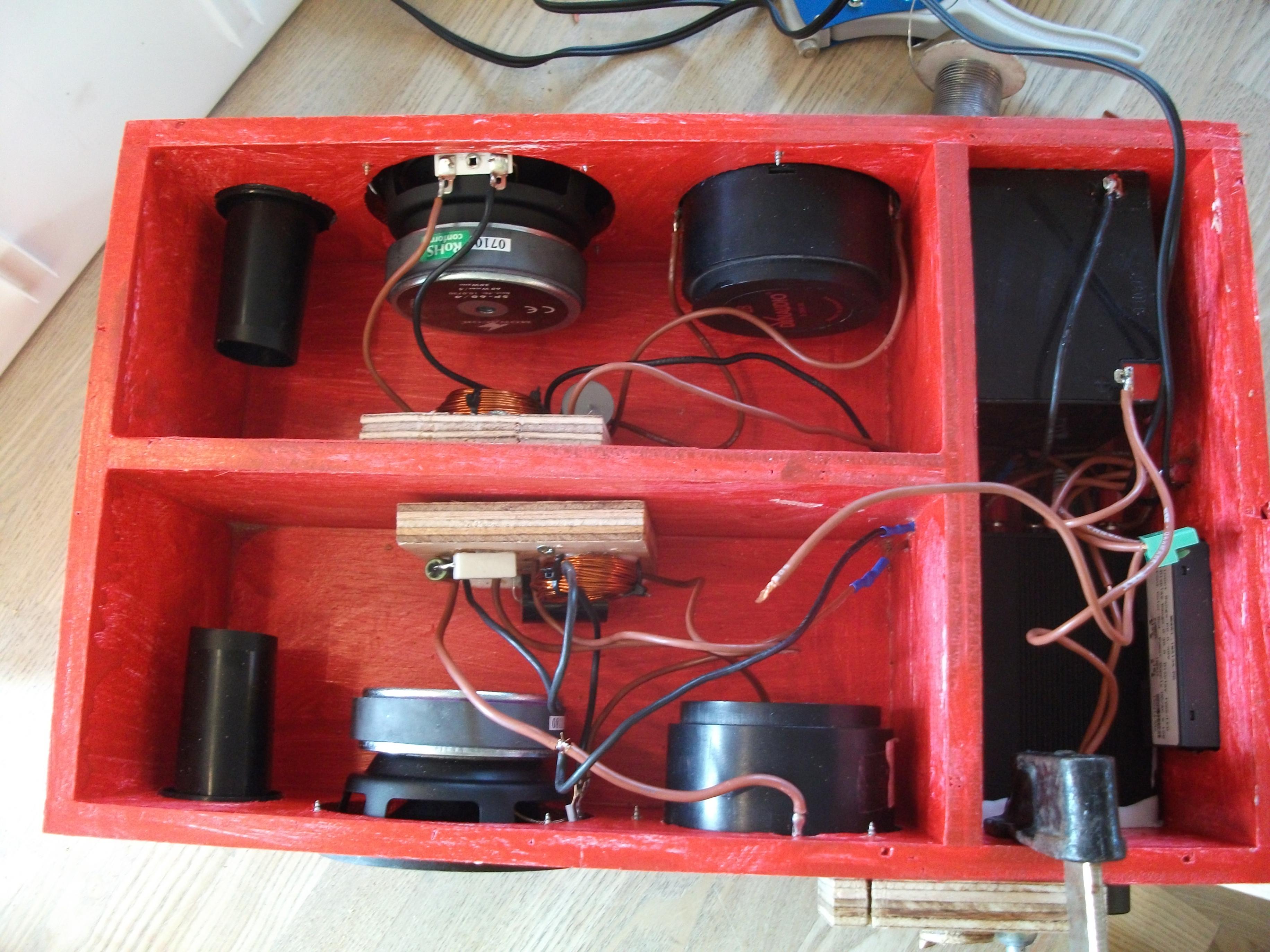

I built a similar thing last summer. Used a cheap amp 2*15W (from sureelectronics) a lead battery, about 5-6 ah. I made it a stereo build, but added a contact to shut off the back side if extra battery time is needed.
I used the woofer SP-60/4 from monacor. This is an amazing driver! It has an impressive low response from even small volumes. Also it goes quite high in frequency, so u can just get a cheap tweeter and do a simple 1st or 2nd order crossover around 4-6k Hz. The sensitivity is also quite good btw (90 dB from a 4"!). For tweeters I used D28 from dynaudio, but that was just because i had those laying around. If u don't want to mess around with crossovers u can try piezo horn tweeters.

Nice. *Very* cool construction 😀 😀

Are you talking about Cal's red toolbox? He has a cool mp3 player with down firing sub called the Pentagon.
I loved *both* red boxes.

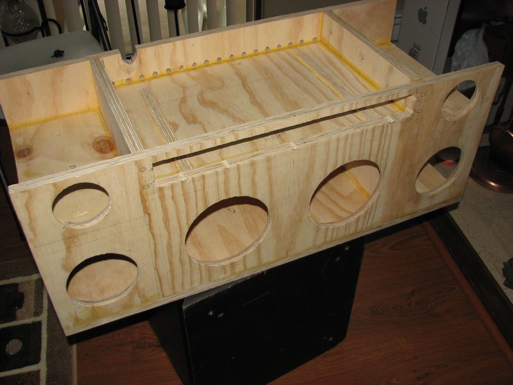

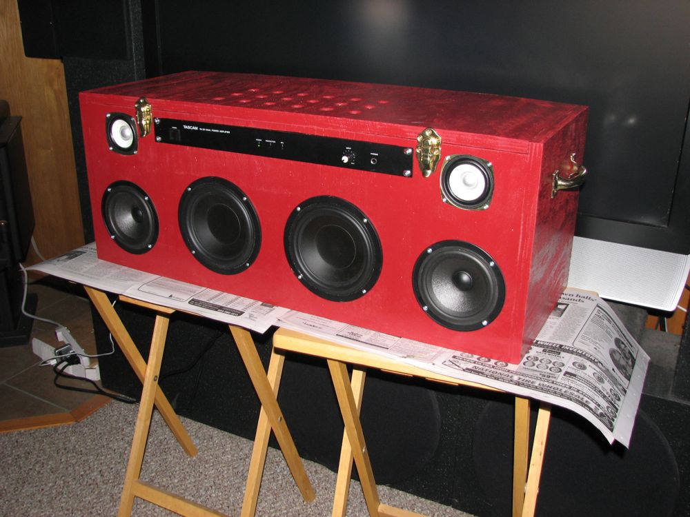

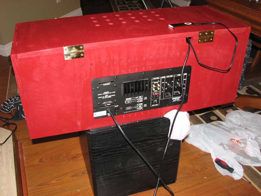

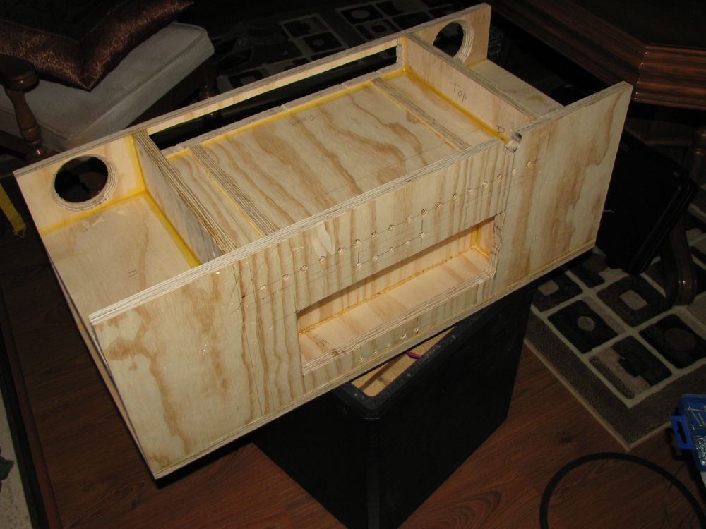

Hi Guys,
Mine doesn't qualify as a true Boombox as it runs off house mains. Nice thing about that is you get to have some decent power. The Toolbox has Extremis 6.8 woofers running off a plate amp, and the Wharfdale mid basses and LG drivers drivers running off the Tascam mini PA amp. Seven compartments in total.
Both the Toolbox and the Pentagon use RCA for inputs.
It's extremely loud.
I was gonna make 'er pretty but I noticed a twist in it after glue up, so I had to change plans and do whatever I could. Toolbox is the first thing that came to mind.
I like what pegodk has done with his too.
Nice design Cal. I see you are a fan of plate amps for woofs. Where are the ports for the woofers or are you running them sealed. Thanks for showing us pics of the wood under construction, a picture is worth xxxx words.🙂 How many watts on each channel?

Thank you, yes so easy to control the bass depending on the listening enviro.Nice design Cal. I see you are a fan of plate amps for woofs.
Sealed, both in one chamber. Plate amp in its own.Where are the ports for the woofers or are you running them sealed.
Woofers share the 125 watt plate and the Tascam is 30wpc.How many watts on each channel?
