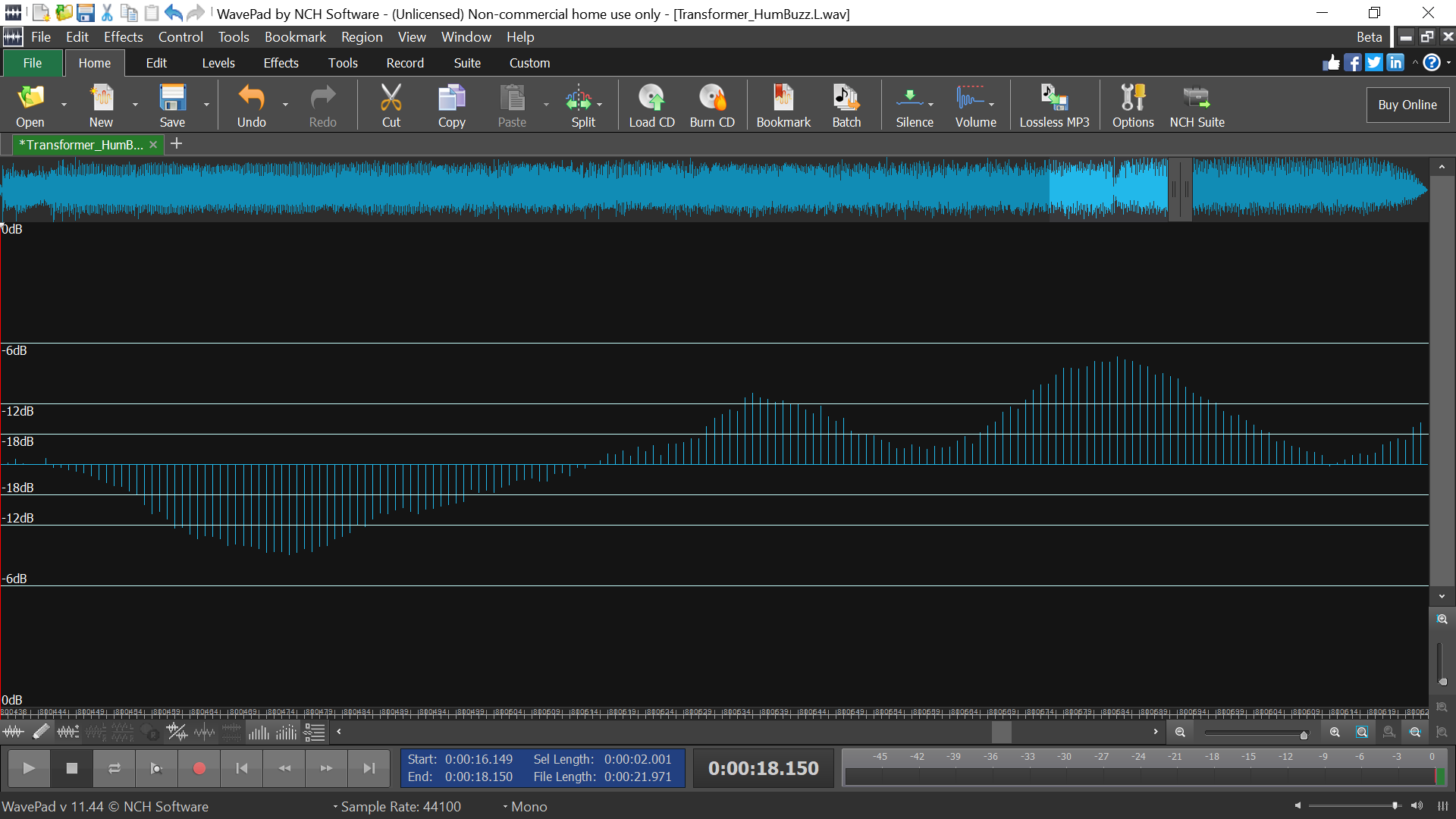

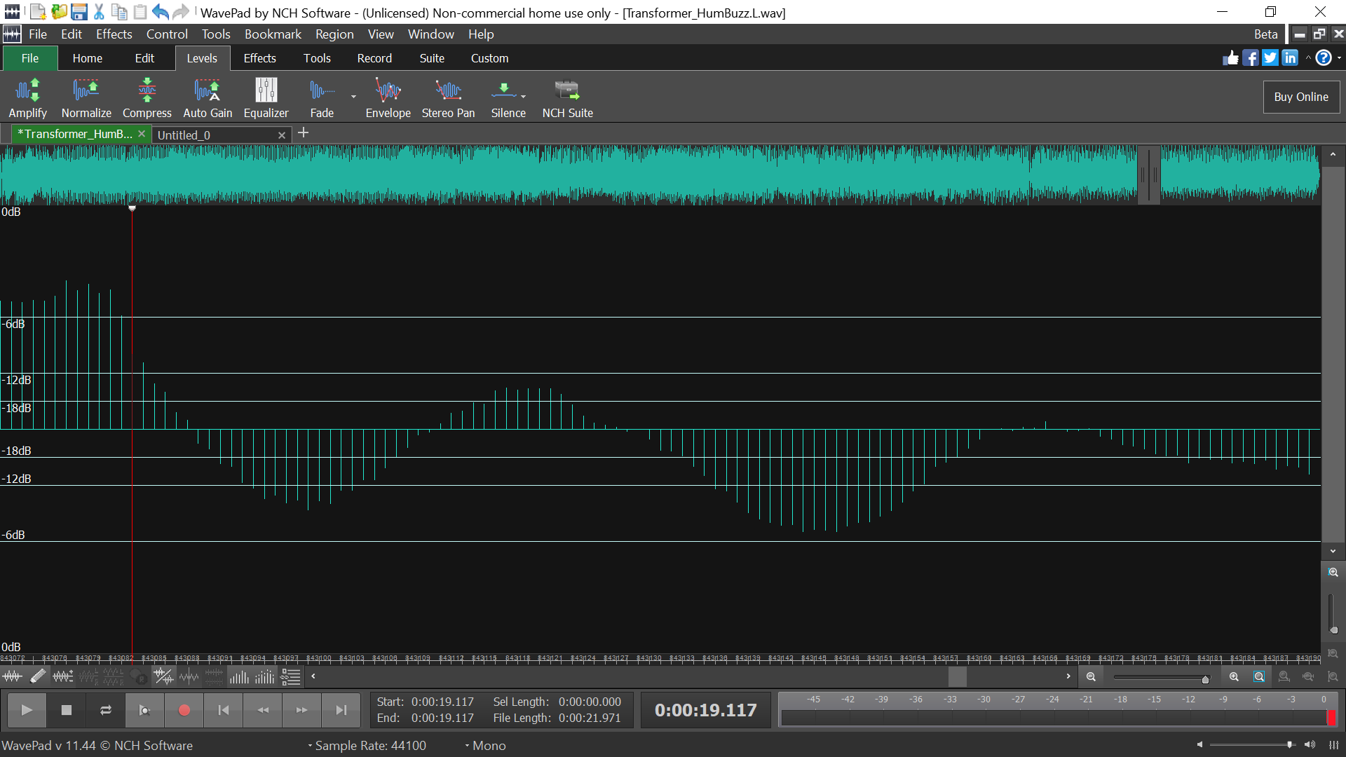

I zoom in the hum file your posted this is what it looks like, the hum is riding on another pulse freq much higher than itself. Could it be some kinds of oscillation or it's presented in grid line power supply?
