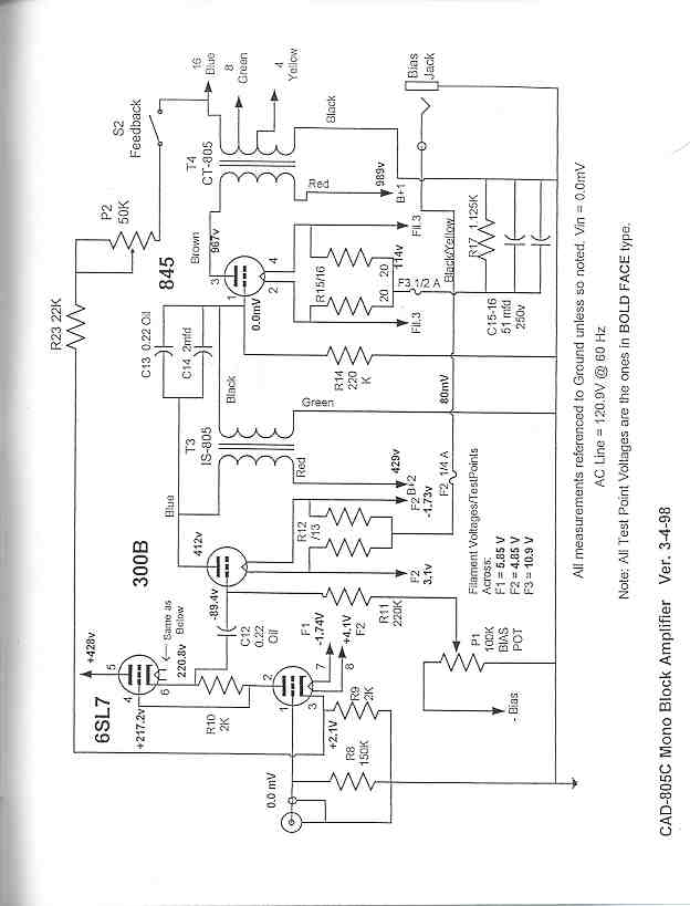

Do this MingDa amp use the Cary circuit??
Thanks for the nice report.
Propably there is some resemblance but clearly they are different amps. Cary has a switch to use different power tubes (805/211) and different pre stage with different tubes.
The Cary is not SRPP?Propably there is some resemblance but clearly they are different amps. Cary has a switch to use different power tubes (805/211) and different pre stage with different tubes.
I don't know Cary's schematic.
I cant identify if this input stage is SRPP. :-((
It is.
Thanks.It is.
So, as I suspect all these MingDa amps are descendants of Cary.
Thanks.
Compare the schematics. Those two amps do not have anything else in common besides the SRPP . SRPP is very commonly used stage.
I'd say these two models are totally different amps.
There is a second schematic?Compare the schematics. Those two amps do not have anything else in common besides the SRPP . SRPP is very commonly used stage.
Do you can post it?
So the Ming Da is a Mystery Amp to me;
The Cary is IT coupled, notice the couple caps bypassed across IT. Probably for current dump because of the poor quality of IT?Thanks.
