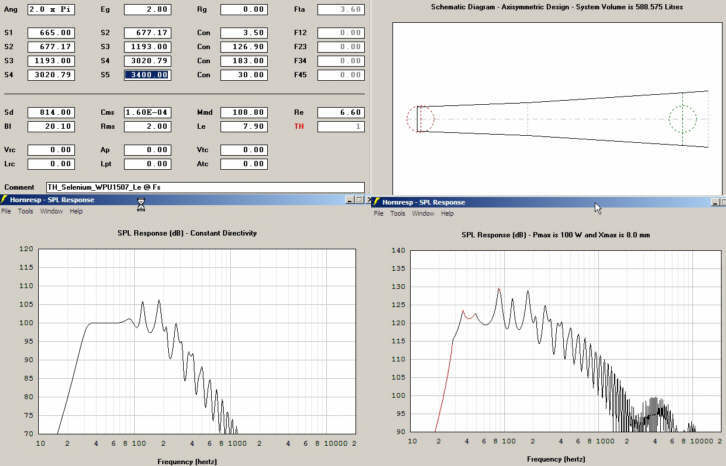

You're at double the x-max for that driver, and at only 100W.
How about a single driver with twice the x-max, and 104.7dB?
The 4015LF is actually a better choice, but I had already loaded this design up last year.

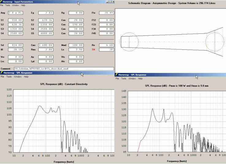

Hi djk, to your Post #23:
I assume, that you are addressing my Post #22.
I agree that there are better low frequency drivers, but the question in Post #1 was: "I am using 4 15" woofers in two Altec 210 cabinets. They are too big for me to move around with just one truck. Can anyone suggest a cabinet or cabinets that will house them but be a little smaller and still get me down to 50Hz?" And as Cal started the thread I tried to comply.
As to the Xmax most-if not all-low frequency drivers would be better served, if they where used with an appropriate low cut filter, it is virtually impossible to design a vented enclosure in which the driver will not exceed Xmax (or Xmech) if driven below its design bandwidth. The speaker in Post #22 stays well within its Xmax when driven above the design spec of "...down to 50hz...".

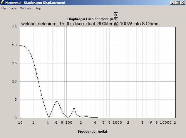

Just more food for thought. 🙂 Here is the displacement for the Selenium from Post #22:

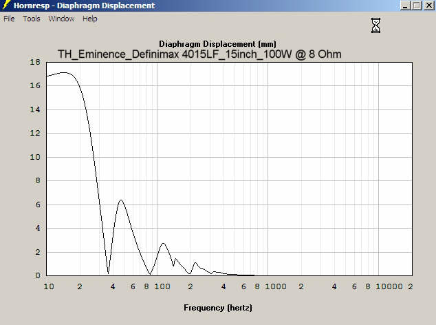

You are not using the same tuning for both designs, this can be clearly seen at the dip in excursion.
If the boxes are both tuned the same, the 4015LF will have 6.4dB more maximum output capability based on the x-max (9mm vs 4.3mm).
I would build two cabinets for the $180 Difinimax 4015LF and sell the Selenium before I would build twice as many cabinets for the Selenium.
The design in post #23 has 7dB more output in the 42hz region, and is much flatter than the dual woofer Selenium design in post #22.

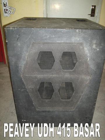

Hi Cal
Have you thinked to use a band-pass cabinet for 4 X 15" woofers? You know probably the tremendous UDH of Peavey, which are obsolette of course now. I had 4 original such type subwoofers and i made also 4 clones. For rental of course, not to meet my new neighbours!
I can confirm you that UDH can touch frequencies down to 35Hz with enough SPL to sake-down your liver. It is heavy, but it is smallest in size compared with your Altec or JBL style horns. A usuall truck like a 4 X4 Ford or Chevy or Dodge, can contains 4 UDH.
The advantage (if your wife agree of course 😀 ), it is that from UDH you can get almost all the energy bellow 100Hz yet in a distance of 1m, instead from your horns you may stay far away at least 5 to 10 meters to get their full energy under 100Hz.
I have the complette plans to build one if you wish.
In the photo (from the web, not mine) you can see a UDH.
