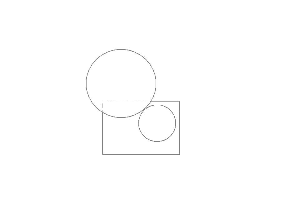

Hi tinitus
I have been asked to calculate the contour but was not involved in any further design decisions at all.
If *we* were asked to start from scratch - what you think might turn out well with that given horn ?
Michael
Oh, thats a tricky one
Maybe not simple
Oval design might have helped, but not an option
Maybe try something like this
Its rough and done in a hurry
Maybe try and angle horn and woofer slightly towards each other
And consider to have listening height/horn midpoint placed slightly above normal listening height
Apart from other possible advantages it will help getting woofer a bit higher up

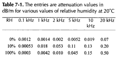

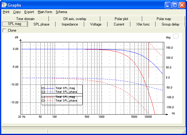

What I wrote above isn't strictly true. While it's true that each 'ball' (molecule) acts as a lowpass filter with a resonant frequency far, far above the audio range, if you stack enough of those filters together (more balls on a longer spring), the combined effect will move the lowpass down into the audio range so there will be some attenuation and phase shift of high frequencies relative to the low frequencies. The biggest effect is the group delay due to all the stacked filters but the HF roll-off can be a big deal in a large stadium. The pic from the Handbook for sound engineers shows the typical lowpass effect.In air, where the period of oscillation of the 'balls' (molecules) is much shorter than the period of any audio wave, the resulting lowpass filter acts as a pure group delay and phase-shift effects can be ignored.

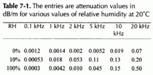

Always thought this is due to *absorption* effects ?

Tinitus your suggestion looks reasonable to me – especially as I guess (in lack of measurements) the sweet range of this large min phase horn may be somewhere three (maybe four) octaves above 600-800Hz with smooth roll off above that.
So rising the mid-bass from the floor might be a good idea.
In the electrical/mechanical model, the absorption effects are caused by the lowpass filter.

The Boltzman constant for a gas replaces the spring constant in the mass-spring model.

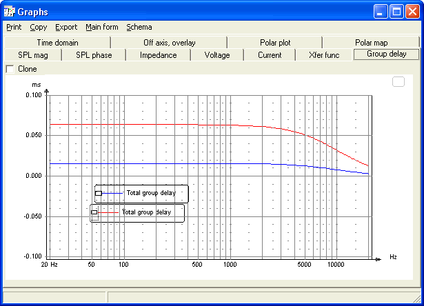

So – maybe a question beforehand – that from a mass spring chain some low pass filter and subsequent group delay occurs is clear (thend having outlined as well) but what's actually the trick that allows to flip from "group delay" to a "real delay" to establish "time of flight".
Group delay IS a real delay for a lowpass filter at low frequencies and goes to zero at high frequencies.
We've really gone beyond where the mass-spring model is useful but let's stick with it for a moment. The pics show the frequency response and group delay of 1 ball (blue) and 4 balls (red) with a resonance frequency of 10 KHz. Notice how the F3 moves lower and the group delay (real delay) grows larger at low frequency as you add more balls and a longer spring.
If you could build a molecular-size spring-balls gizmo, it might have an F3 for each ball in the GHz range. If you make it very long, say millions of balls, the combined F3 will start to shift down into the audio range and the combined group (real) delay will increase to measurable levels.

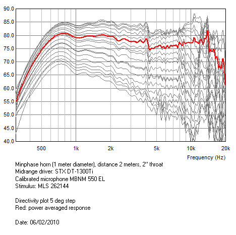

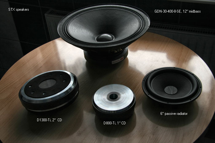

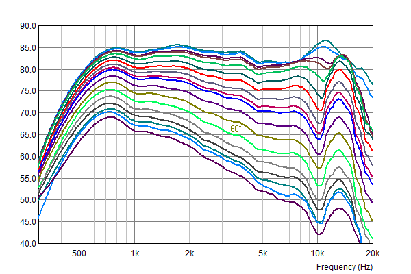

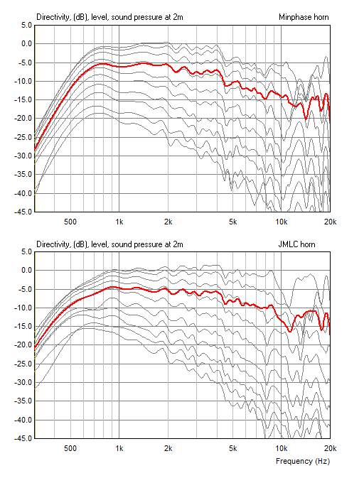

Thanks for your effort to present measurements of the 1m Gaussian MinPhase contour - very much appreciated, Jzagaja !
Have a link to the compression driver used : STX DT-1300Ti ?
Michael
Michael
STX DT-1300Ti is a driver prototype made for me by STX Soundstation, probably most affordable, high-quality on the market. Smaller brother is here:

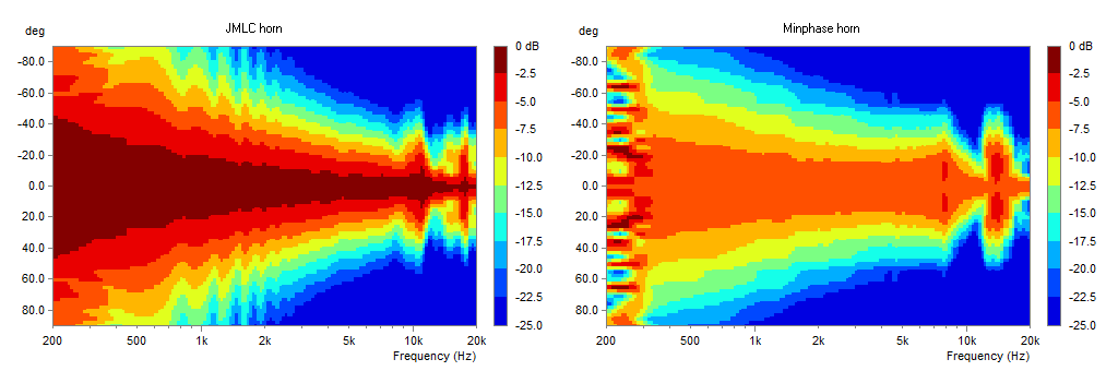

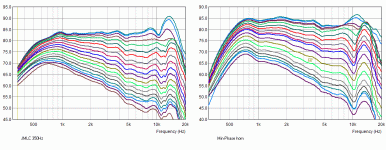

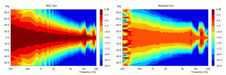

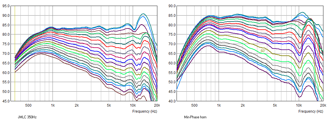

Gaussian MinPhase Horn
Where it all started from:
http://www.diyaudio.com/forums/multi-way/103872-geddes-waveguides-67.html#post1930266
Above is not exactly the same Gaussian MinPhase contour thats finally been realized and what we now got measurements for – but might give some background nevertheless
Thanx again, jzagaja - great work !
Michael
