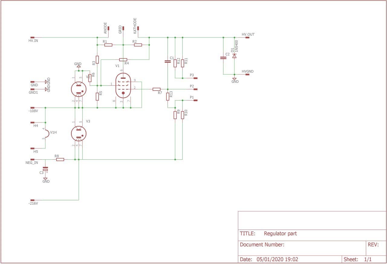

As part of the process, I redrew the schematic so that it's like a conventional regulated power supply schematic (mostly so that I could better understand what's going-on), i.e. Pass Tubes, Error Amp, Regulator tubes, top-to-bottom. See attached.
In this form, it looks much simpler and lots easier (at least to my old eyes).

Pete Millett HV Power Supply- Original Schematic
Here's PMillett's original schematic.
R12 is indeed 27K.
That seems about right for this voltage divider "stack". Typically the resistance ABOVE the voltage selector pot is slightly higher (37K) than the resistance BELOW the stack (25K).
This is what I would call a "low resistance" stack, i.e. totalling about 200K round numbers.
Classic regulated tube power supplies (Heathkit, EICO, Fluke, etc) use a ~1MM ohm stack with a 500K adjustment pot.
My guess is that Pete wanted to use a multi-turn voltage adjustment pot, which are only commonly available in 100K. This is one of the things I liked about this circuit.
I did the same thing in a rebuilt of a Heathkit PS-3, taking design cues from an HP regulated PS. Worked good, and those Bourns multi-turn pots are really nice to the touch.

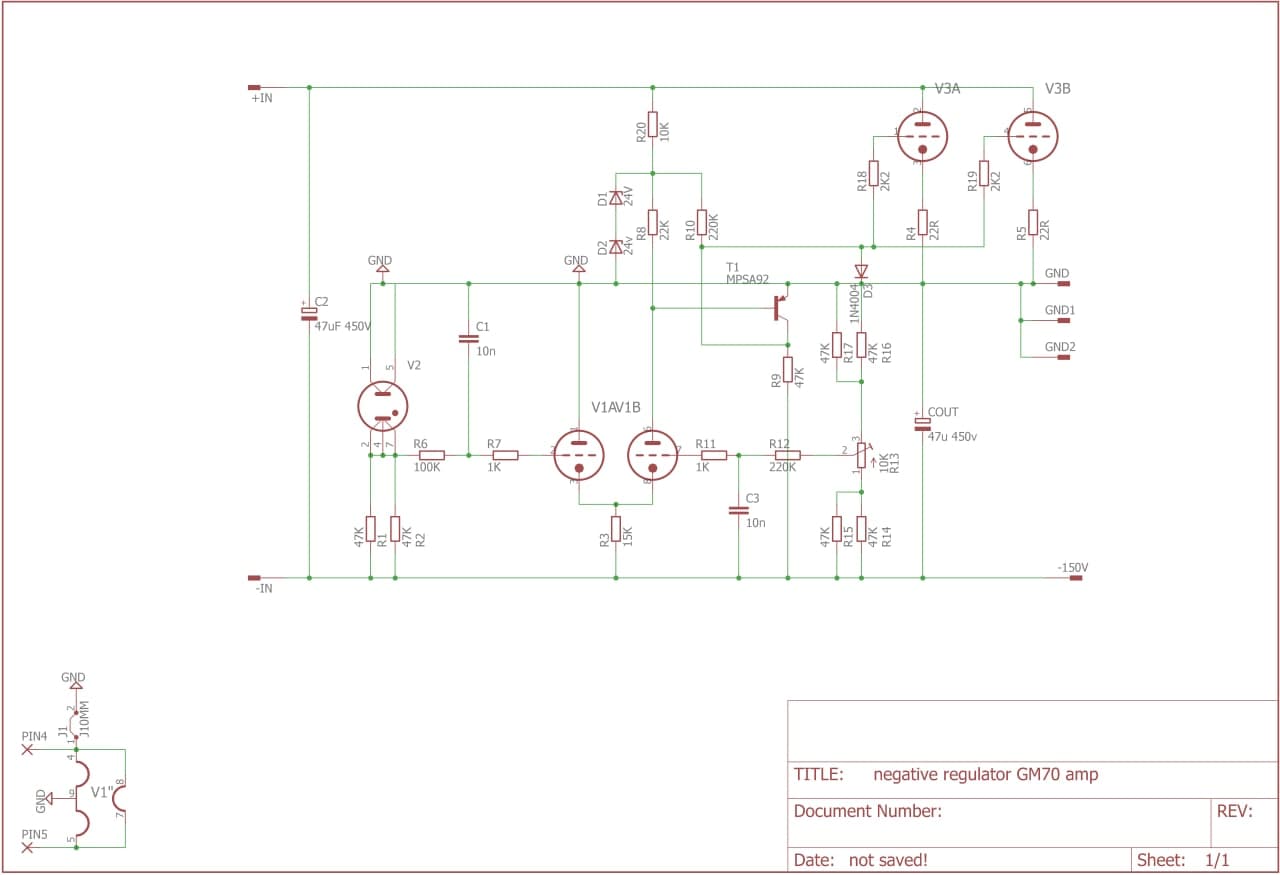

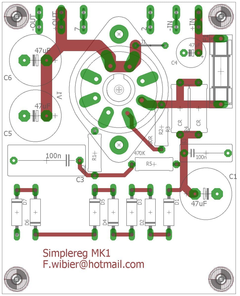

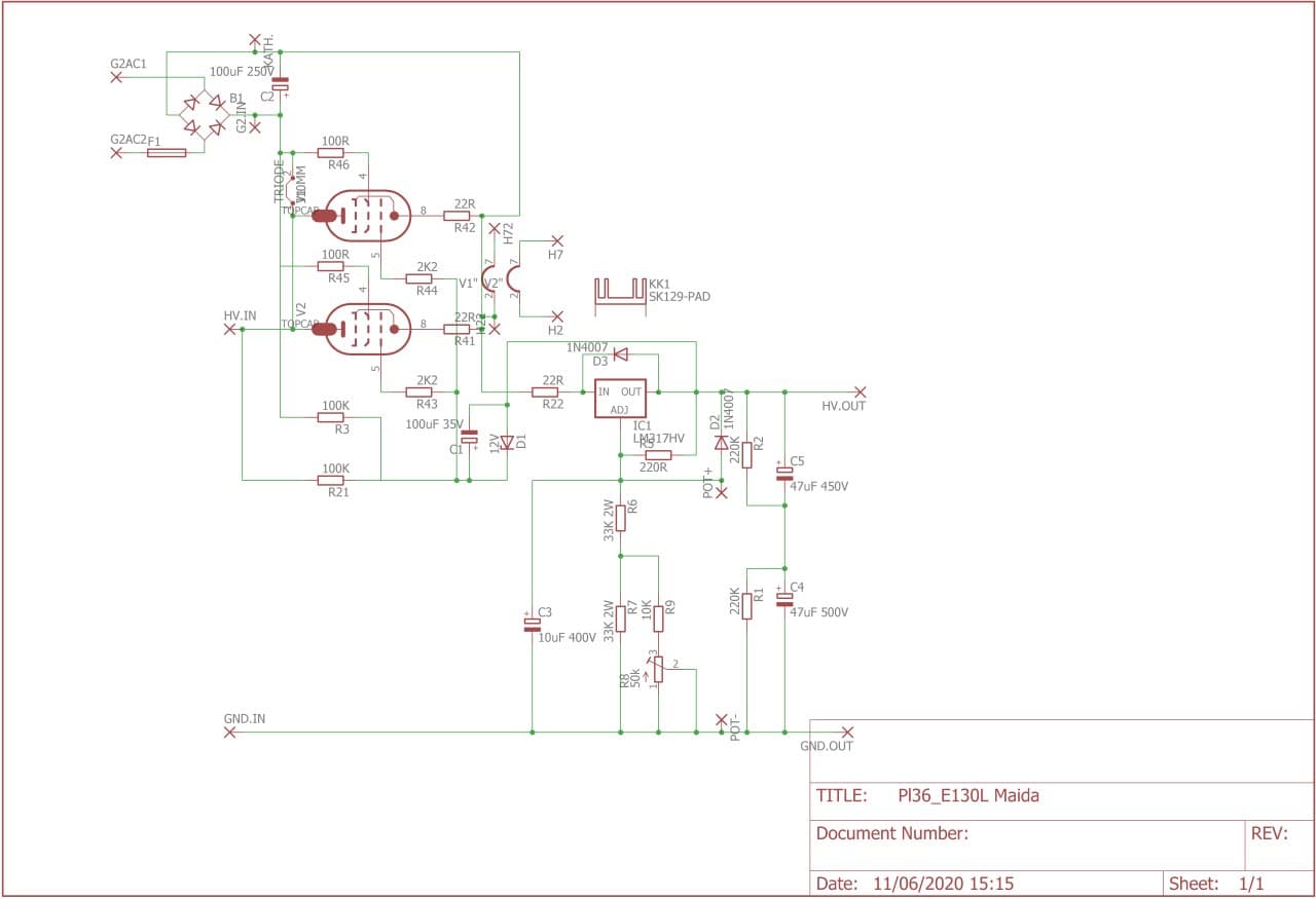

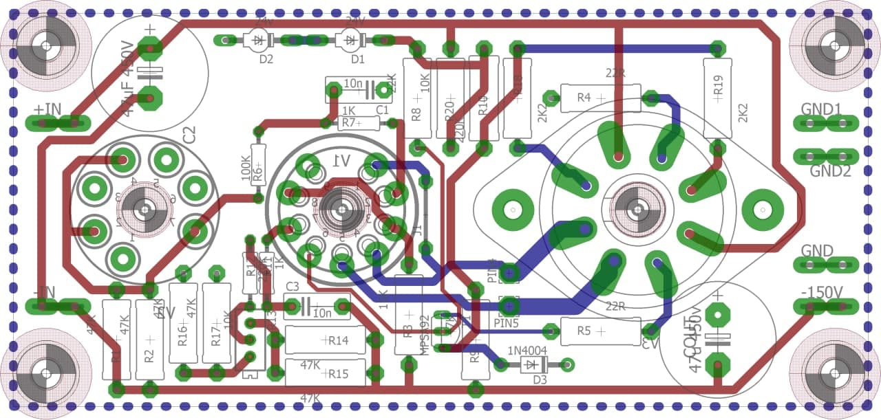

Tube Reg boards
I got about twelve to fifteen designs for various tube based regulators if anyone needs the boardfiles, just PM me your email and il send them to you.
Attached:
Attached:
- Control amplifier and reference section board on 100x100mm
- Negative voltage tube regulator based on the tektronix 567 power supply
- Maida regulator with EL36/PL36
- Simple EL34 emitter follower. (Simplereg MK1)
