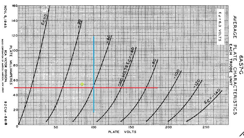

When I'm looking at the plate curves for the 6AS7 I realize that my bias must be way off. The green point on the graph is my voltage/current at the moment, but I only have -18V bias. Please correct me if I'm wrong here, but If I'm aiming for say 100V/50-55mA at idle (red/blue lines) I should get closer to -40V, so I should increase the 330R cathode resistor a fair bit. I'm thinking something like 720R should get me a lot closer to a good operating point?

720R cathode resistors resulted in -36V bias, but higher plate voltage, so I'm now at 125V/50mA. I figure somewhere around 90-92V on the plates and 55mA should hit the bias spot. Should I reduce B+ to get there, and then fine tune the CCS? Or am I overthinking this?
