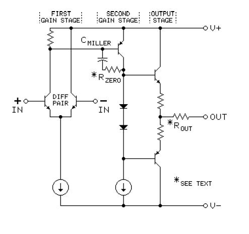

Miller compensation with a series RC network?
Usually, the Miller compensation is done with a cap. I won't do the maths here, but in the case of an opamp (among others), this compensation creates the non dominating pole, and a zero. The problem with this zero is that it has a positive real part, that makes an instable zero and so reduce the phase margin, degrade the impulse response.... That's basical opamp theory.
This week, one of my teachers told me rapidly about something: using a series resistor with this cap (a series RC network). According to him, this tip has many advantages: the series RC network creates a zero with a negative real part, so stable, so this would add 90° to the phase margin (instead of substracting 90°)
A starting R value would be 1k, and the RC time should be equal to the non dominant pole's frequency, in order to compensate it and have a truely 1st order rollof.
But we only talked rapidly about that, and he didn't have the time to show me the maths.
I tried to show this with the math myself, but wasn't able to obtain something with a stable zero. And my simulations with this RC don't show a stable zero, nor more phase margin. But only a gain like this: ˉ\_ and a V shaped phase.
Does anyone know this kind of miller compensation? Can you tell me more about it?
It's used.
Hi Bob,
You will find that this or its variations are used in many amps .
I haven't worked out the maths nor simulated a circuit with it. If it takes time to draw it up , its a disincentive.
However if you post your schematic and want others to check it out , it might be a faster way to get a response.
Ashok.
