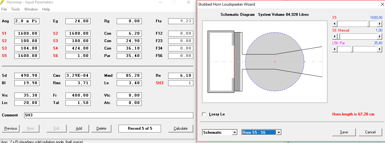

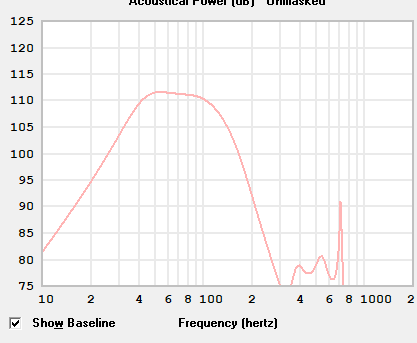

I used your LAB16 specs in those sims. Here's what the low tuning from that 46cm long vent does with the larger volume:
Yes.....that’s just about what my free ‘speaker box’ app came up with.
So if I cross at 80hz or so (12db) should be decent no?
I can high pass the bottom if it’s gonna get into over excursion.
What do you think?
I really appreciate all the help btw
Bob

David McBean's hornresp is free and am sure positive used by some of the pros.
you would probably be better off with a bass reflex - or maybe a tapped pipe as the little "horn" is just providing a nasty peak.
look what a tiny bandpass box might do:
xmax would not be hit it its passband with 1.6KW - it would just burn up.
Ask some of the guys who work with PA equipment what they would build withi your woofers.

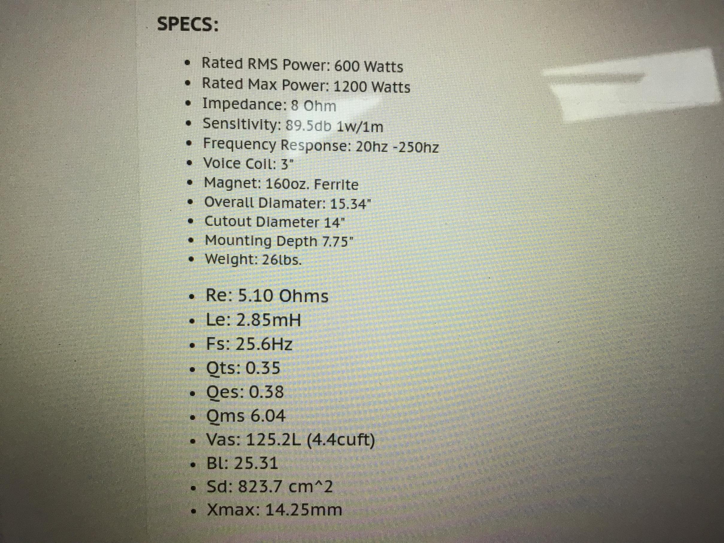

for space saving, that LAB15 woofer would work OK in a 1 cubic foot sealed box with 600uF series capacitor as long as the amp has low source impedance and the cap pretty good in quality (I have an xls2000 - great little amp)

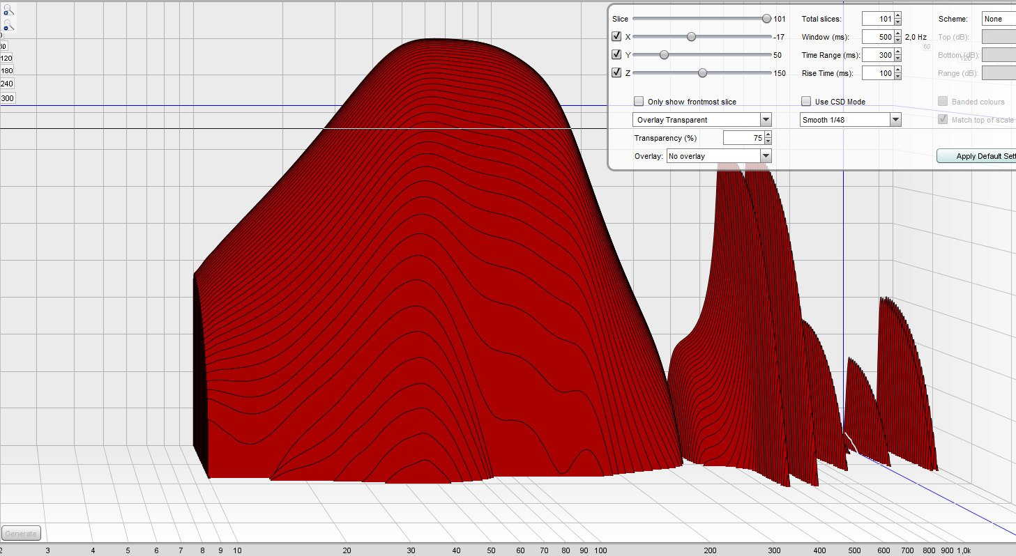

the deeper its tune, the worse things will get - the lower portion of response will probably be around 88-90dB and the long vent will have its own harmonics besides taking up more space. I have a 4th order bandpass box with similar vent and its got some bad spikes.
Just damp it !the deeper its tune, the worse things will get - the lower portion of response will probably be around 88-90dB and the long vent will have its own harmonics besides taking up more space. I have a 4th order bandpass box with similar vent and its got some bad spikes.
(waterfall/wavelet are done from hornresp impulse sim unstuffed into REW)
...dhhhoooo...cannot re-edit/delete last post. It only apply for low power ~<115db max 2pi that don't need that much big port (100cm²).

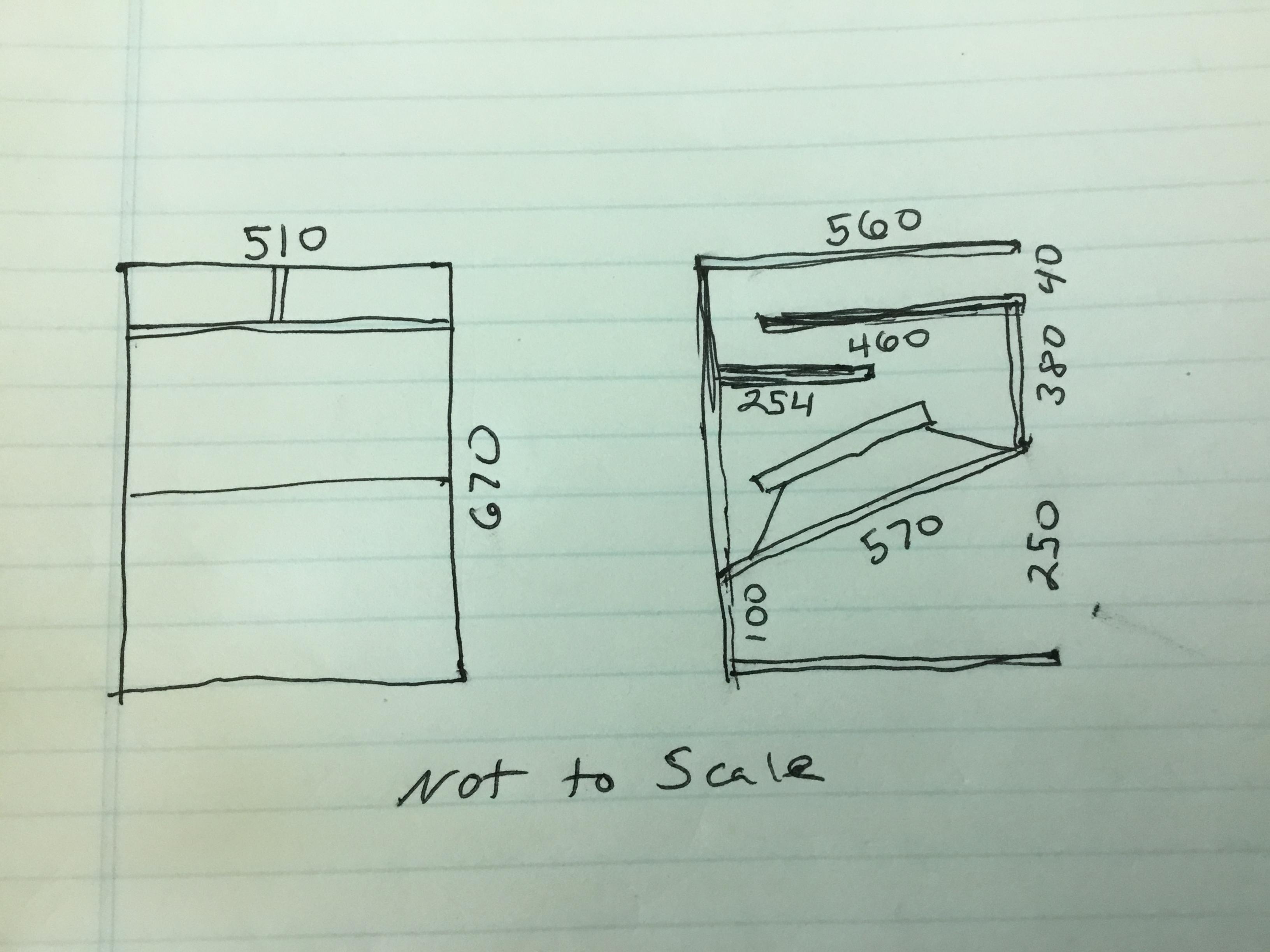

the way it was drawn: for home use I'd think it be better to make a simple bass reflex

Here you go - 69 liter bass reflex tuned to 22.8Hz. This would be good IF you can get a good vent in there - maybe right angle - or top to bottom exiting at the floor with box elevated a bit ??
also 6dB of Q=2 peaked 2nd order highpass filter would make it ~ flat to 22Hz
its tuned about a Hz high in the sim as the 76sq.cm. vent was a half meter long at that point

What I had in mind in the first place was this configuration and if I set the lp on the xls2002 at 80hz (12db) would that not bring the hump down to where I could meet it with the hp on the reciever (160 on down)
Or is that just not gonna work like I think it is?
