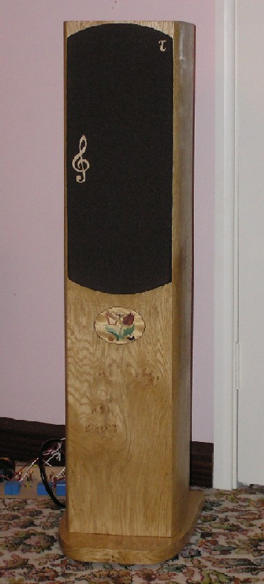

Remember my MTM of ER18RNX and 27TDFC, configured for my 300B SET amp? Well here's a pic (I hope) of the finished article and notes on the sound.
They have also acquired a name; Tau. From the tulip association, see the detail in the picture; and also tau for time constant and these have 3 of them (think about it ....).

They now have about 60 hours use and seem to have settled. An issue with female vocals seems to have 'run out' if you see what I mean. This wasn't quite right .... freq balance a bit out, with soprano voice seeming to have too little fundamental and too much harmonics. Not bad at all, listenable but not right. It seemed to come in more after about 40 hours use - strange.
Anyway, I decided not to tweak until they had at least 50 hours.
So a few days ago I removed my 18 ohm + 15uF across the woofer which pulled the FR down a bit at about 1kHz, bringing (by simulation) the BSC in at the right point. Removing it was an improvement. Now, over the last 2 days, the problem has substantially gone (perhaps totally).

Well this has nothing to do with anything you described here, but I must say I noticed the nice woodwork and am wondering if you did it yourself? The inlay is particularly noticable and unique - great idea. The artwork makes it look distinctive and like a commercial (not a bad thing!) product.
Thanks for the compliment.
Yes, I did the woodwork myself and it was complex. The sides are laminated. There are 7 braces fitted, 4 full shelf, 3 half shelf (I'll post photos later). The front panel is 28mm thick.
I've been involved with wooden boats all my life so I've developed some woodworking skills.
Veneer is pippy oak which I find attractive.
The inlay was done my me, in marquetry. The picture was chosen by my wife and me, from a magnificent book The Tulip by Anna Pavord - tulips are my wife's favourite flower. The picture is 'Tulips and an Ichneumon Fly' by Joris Hoefnagel, about 1590. We think it works well.
