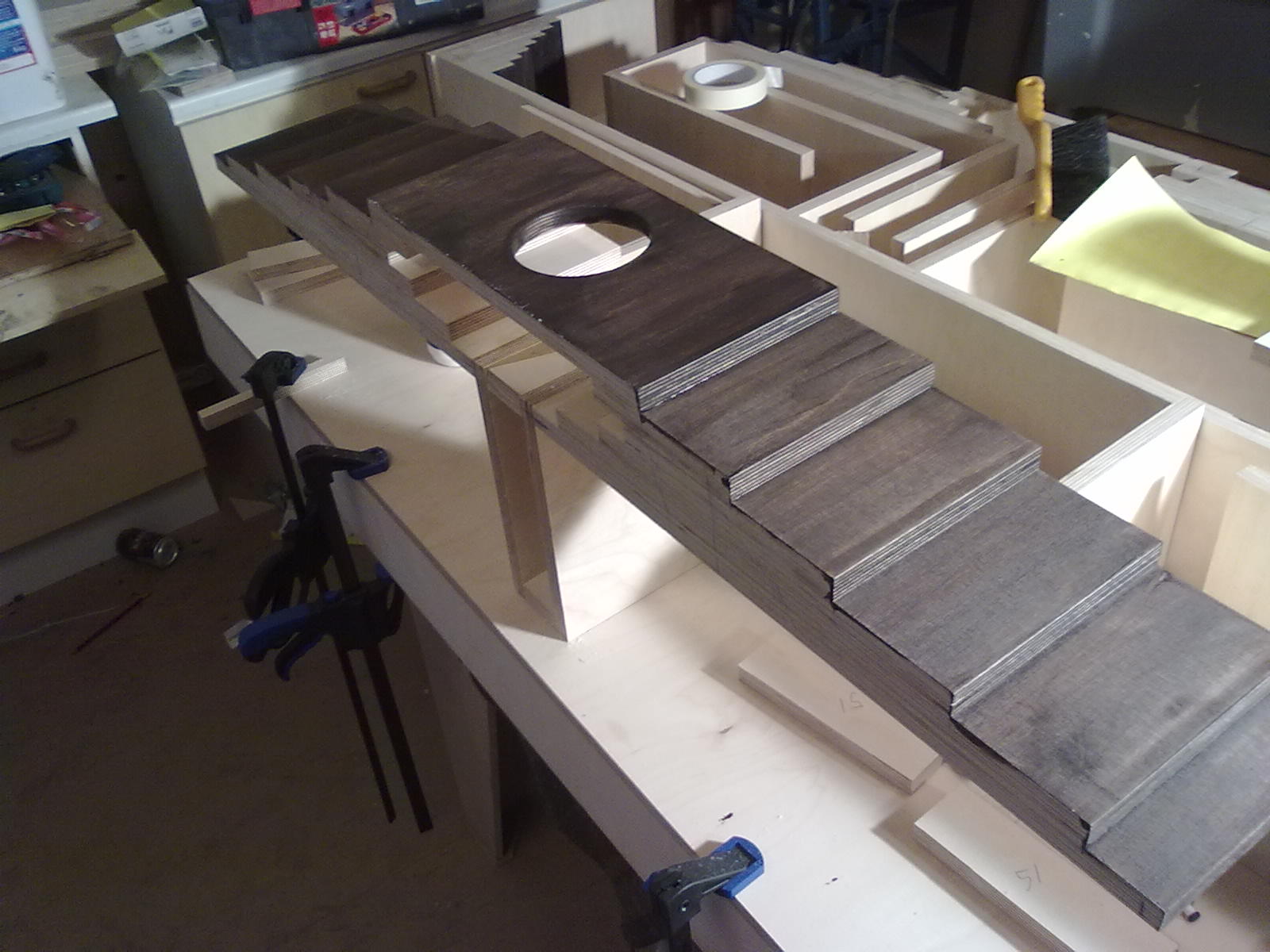

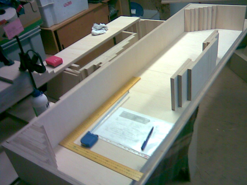

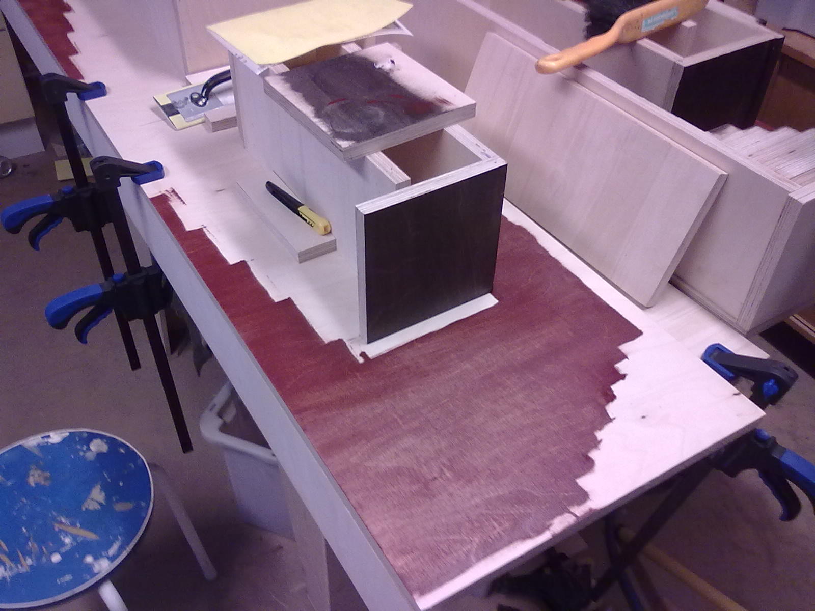

my brother is started to build the spawn family Mikasa for fostex new fe126en
drivers.
is there any good tips for it? we have all parts done and soon we will start put it together
http://www.dvdplaza.fi/forums/attachment.php?attachmentid=12324&d=1281285812
drivers.
Assemble from the middle outwards.
Post pictures 🙂
dave
cut some spacer blocks the width of each fold section, buy another couple of dozen f-clamps, and take your time 😀

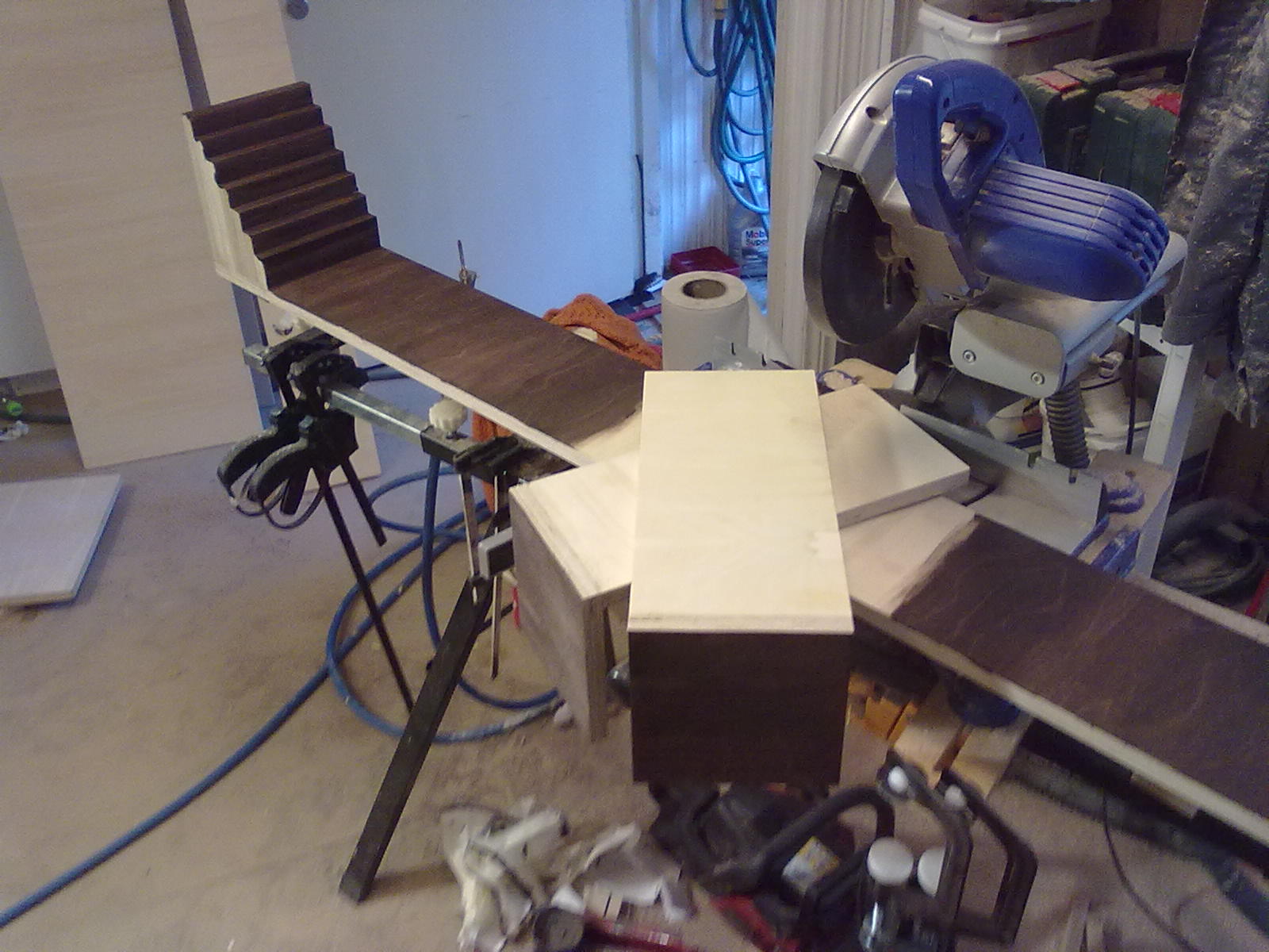

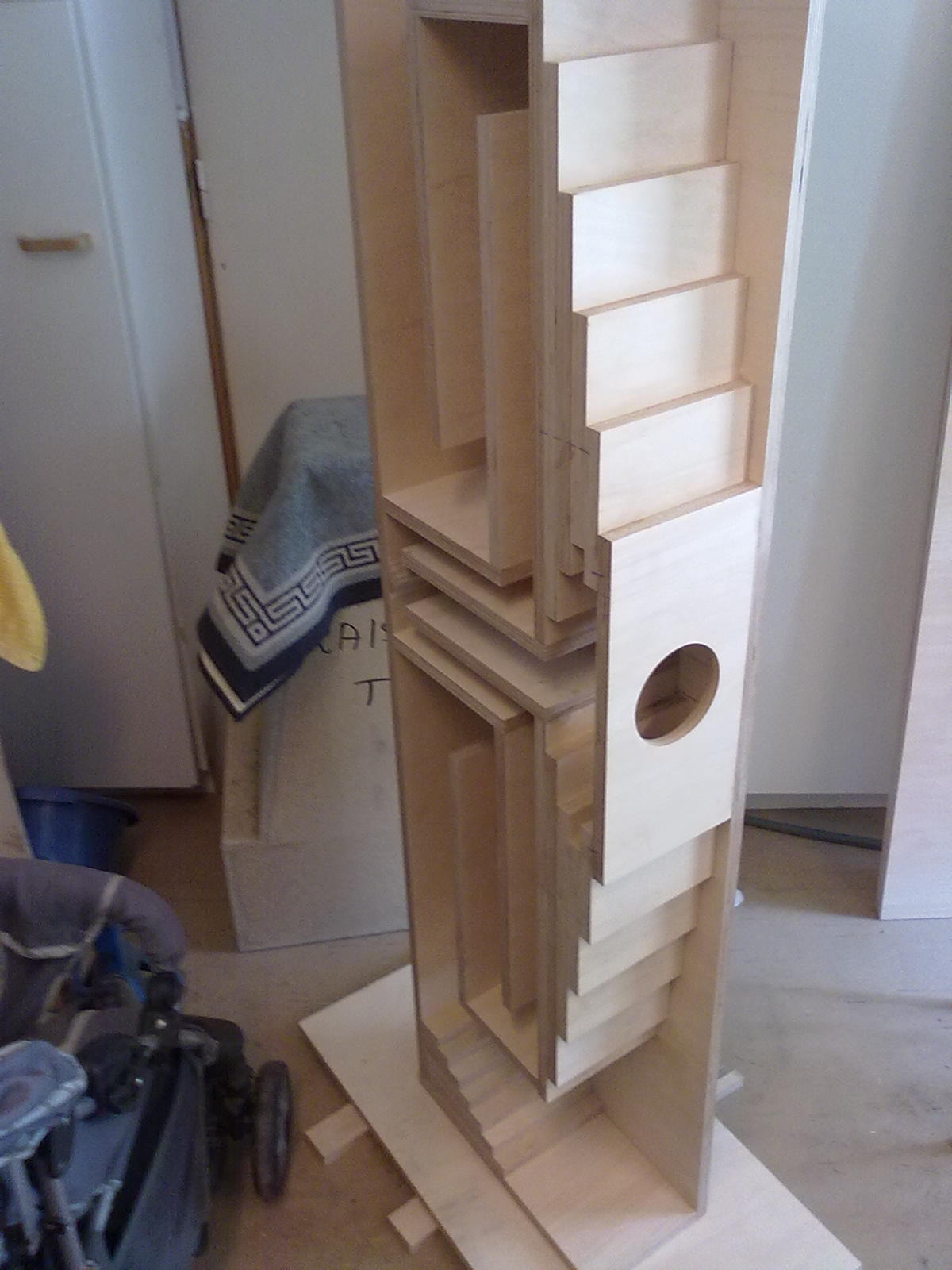

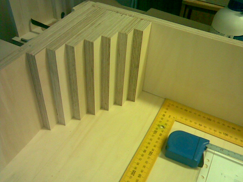

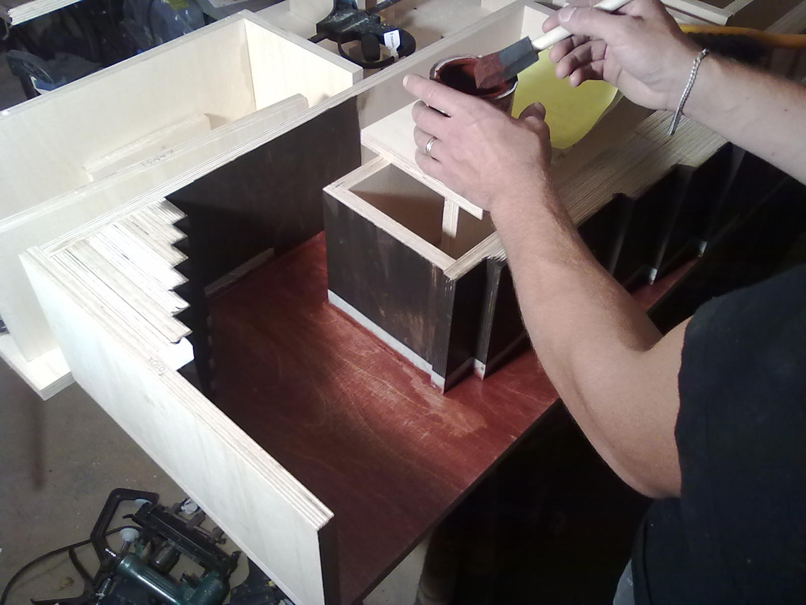

HI, some more pics and stuff.
My older brother start this thread and i tought to continue, there are some more pics my mikasa projeckt.
i cant found anywhere pics of inside of the mikasa so i wonder should i but there some stuffing, and the corners 90 decrees or some roundings...??

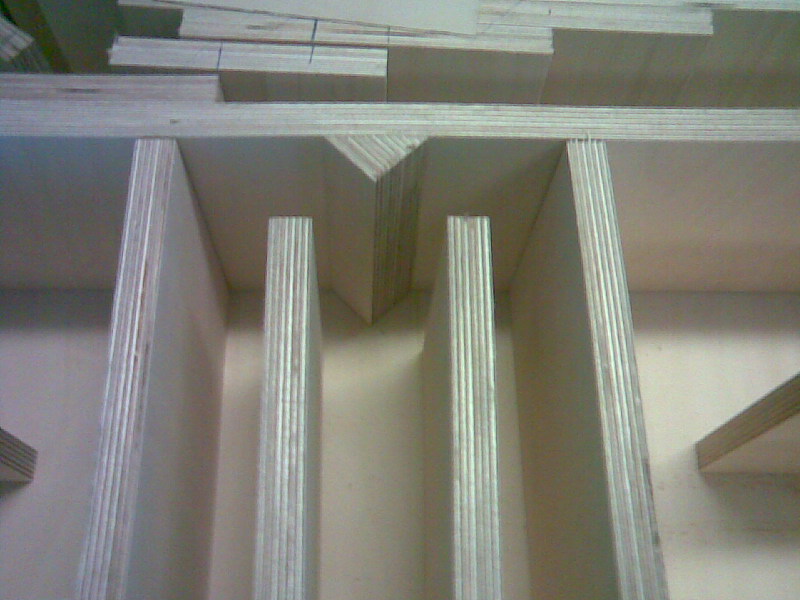

All the stuffing that should be needed should go into the air cavity. You don't want to round the corners... they act as low pass filters.

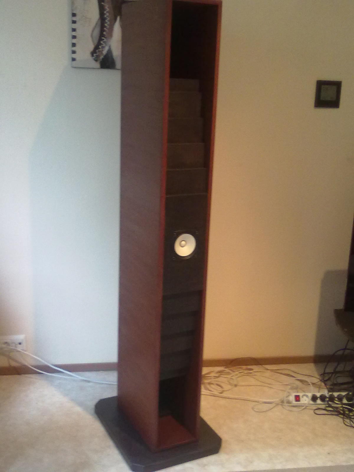

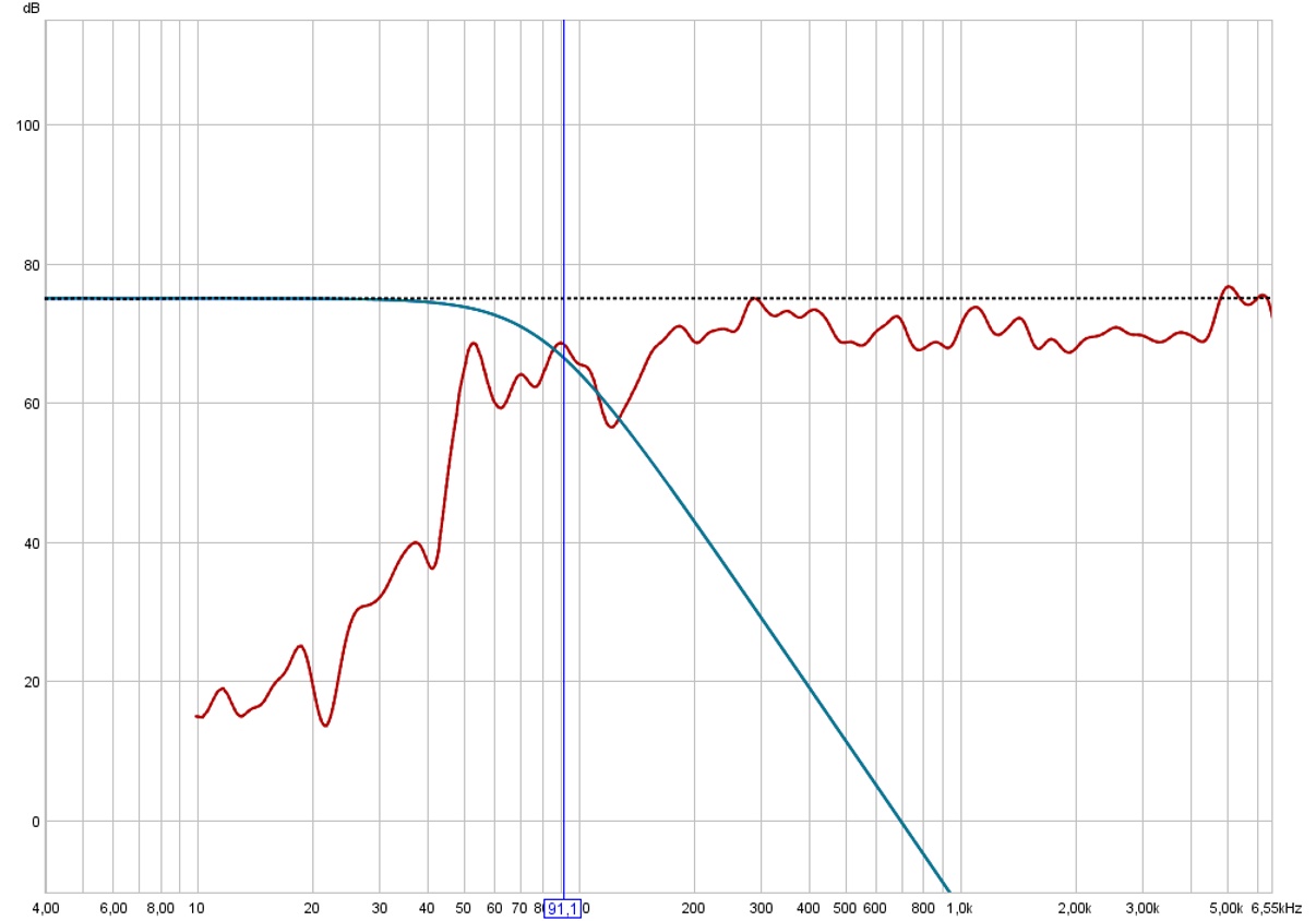

sounds better what i expected!
needs some final adjustments still...

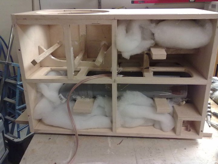

These are splendid.
Could you comment on any lining or stuffing that you did or did not do.
For instance did you use any felt to line any of the internal baffles?
Did you use any stuffing in the center chamber?
I am going to build a pair in the coming month and was hopeful of gaining from your experience.

I should have seen this advise before just posting a question to the builder. But then he should have some recent experience.
So, Dave, I understand that the corners of the baffles should be clean and square to do their job. But does the carcass itself, the panels - side and back - need any felt lining. Or is it just stuff to taste in the main chamber as described?
the latter
I put all the stuffing behind the element, directly behind on the tube to about 15-20cm on the way, reducing the pipe size slightly. its lowers that mid bass which is a slightly too loud.
