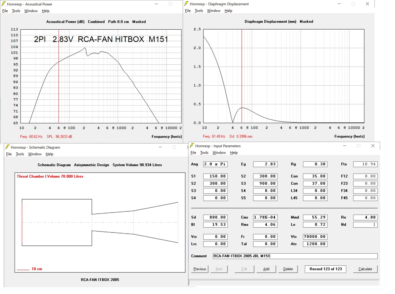

Might a 12" version of Bastanis "Matterhorn" exhibit some useful "hit" ?
I like the small footprint and driver height. I'd like some "hit" to emphasize cello, upright bass and percussion.
as a wideband I have Celestion K12H-200TC and as woofer, GRS12PT and Kappa12A.
what would you suggest for the volume, "horn vent throat", horn vent exit area and floor gap?

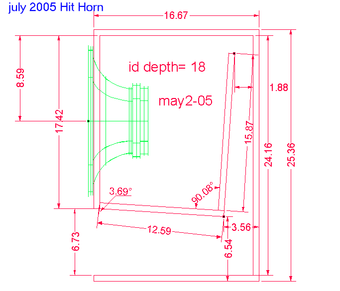

Horn-guy Bill Woods suggested a little cubical BVR for 15"
Alternately, I could try the 15" Matterhorn cabinet - if one has a correct drawing / dimensions for the early model.
I think one coujld be bujilt - then find what height works best from floor then build a stand from 2"x2".

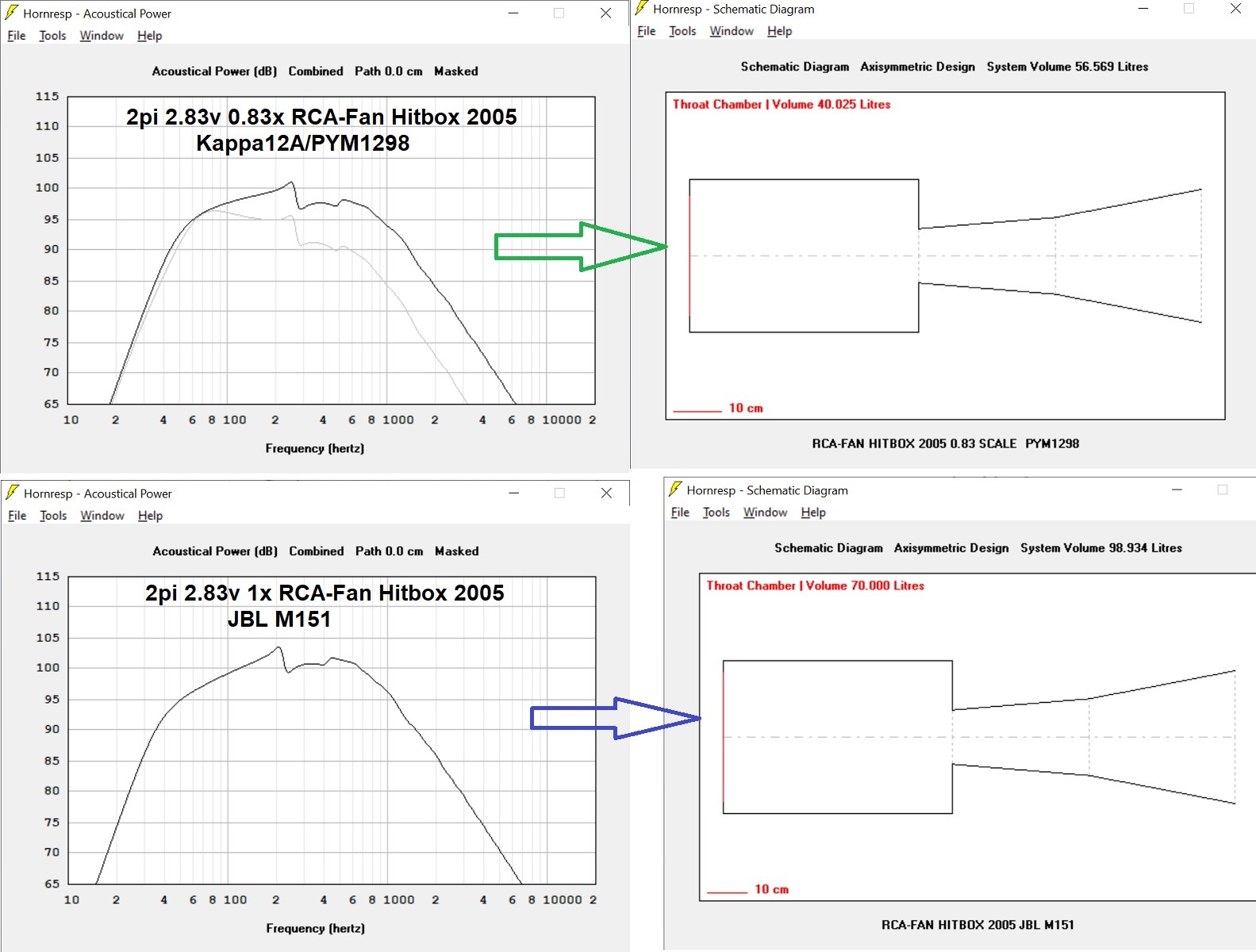

assuming the online drawing dims for Matterhorn with internal depth at 298mm are correct, its the same size as RCA-Fan's 2005 more cubical form-factor "Hithorn" BVR and just under 4 cubic feet total internal volume including the "stubby-horn vent".
