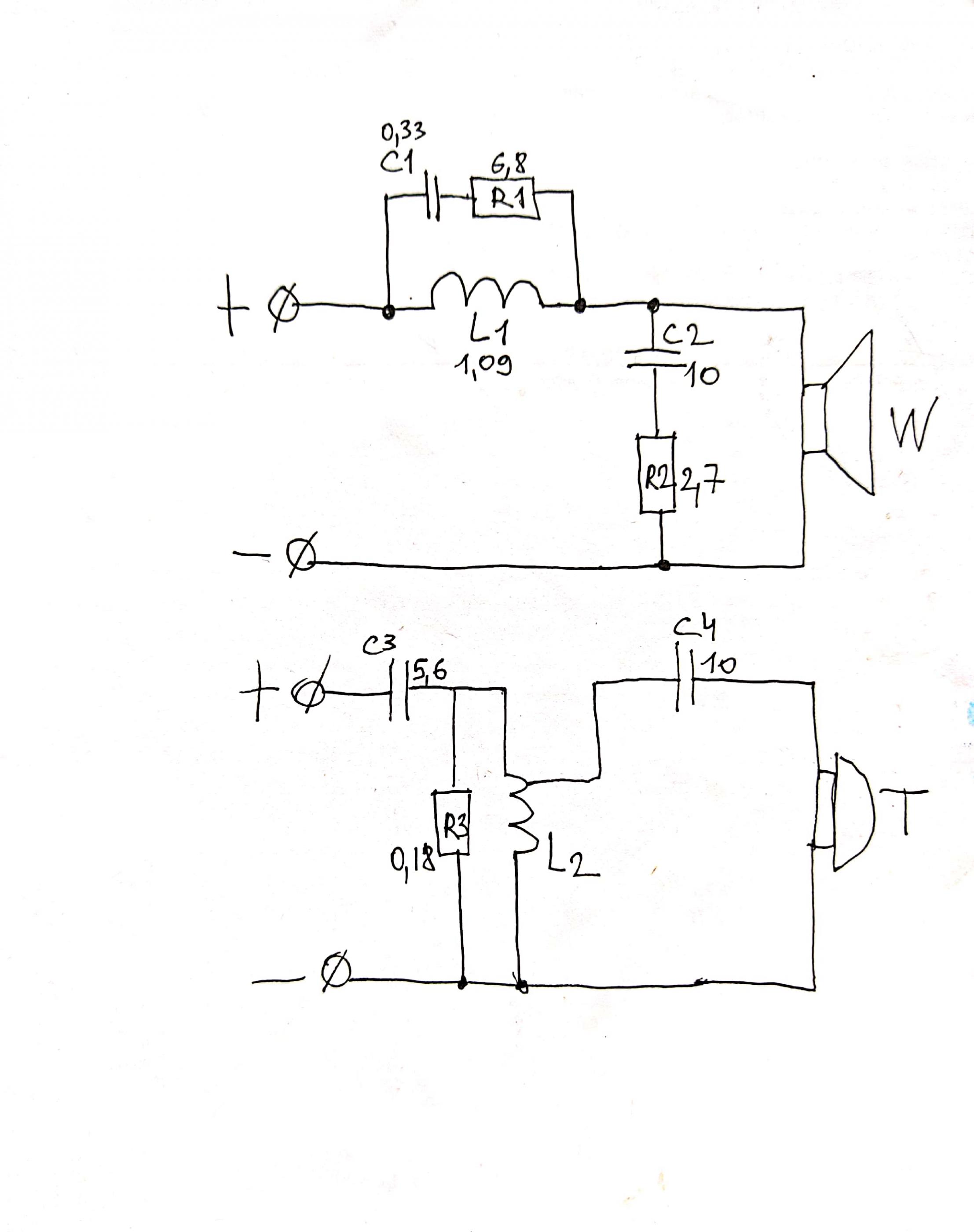

The bass level is unaffected, but the midrange from the bass drops. Click to expand... I understand it. But it is not my case. The response will be unbalanced with tilt to one side. Simple LPad did the necessary work for me. I can't hear any negative effects

I'd have to see the final schematic to see how it works. For sure, at some point you say: I'll stop there. 😀 The deep mystery of loudspeakers is that some designs just sound smooth and musical. And others just annoy the heck out of me. Ongoing fun.
