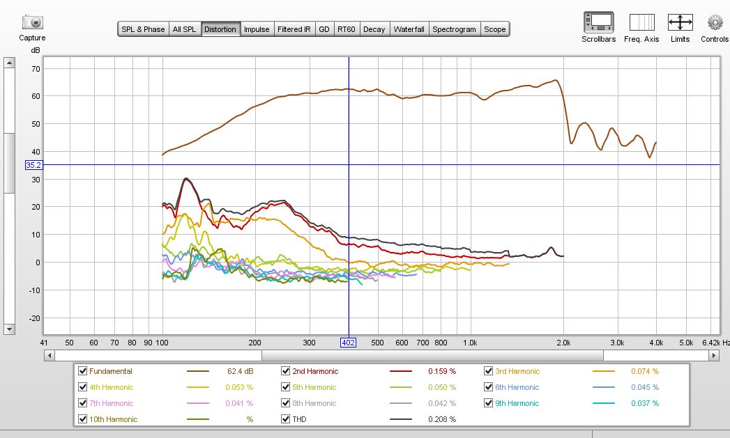

Ok the glue has dried and I did a first test.
It's a very rough test just to have a first idea. In a few days my measurement setup will be much better.
I used the DATS interface which has a small amplifier but there is a resistance also as it is normally used for impedance measurements ...
But for a first test this was easy to setup.
Microphone is calibrated but the distance was relatively close inside a room.
But the result can give a first impression I think.
This are the midranges
It looks like it goes quite low. Altough The hump in the low could be because of the resistance in the DATS interface amplifier.
Then it goes quite good untill around 900Hz it suddenly drops whereafter it drops more slowly.
Around 1k9 there is a notch.
I'm wondering if that drop at 900Hz could be the first cancellation notch.
If so that could be a problem.
The mounting piece for the tweeter is 12mm in thickness so maybe I could reduce this if needed using a metal piece instead of wood?
I'm gonna do some better measurements outside when I have the chance with a better setup.
Then I also did a measurement for the compression driver
There is quite a big hump between around 1k8 and 3k.
Don't know why this is. I still have to check everything for leaks so there could also be a problem.
And yet again a better setup with a decent amplifier could also make a difference.
more to come

So today I fixed a few small leaks.
I also used a decent amplifier to do some measurements.
The midhorn looks a lot better I think.:
The compression driver is also better:
So after a little bit of trying with an active crossover I've put the compression driver on High Pass 1k2 L/R 4th order.
The mid section was High passed at around 350Hz. they did go lower but I think the drivers can't handle that.
Low pass for the mid was set at 1k8. this made the total response look better. Phase looked better also.
Al filters where L/R 4th order.
This was the result:
far from perfect but starting to be usable.
Also the weird things in the higher frequencies is because of the in room reflections I think. I Need to get outside when the weather is good.
I also did a little bit of listening and I have to say I was really amazed how it sounds very uniform.
No matter what angle you listen.
Also when I was first testing and slowly turning up the volume to see if the channels for tweeter and mid where ok it was very difficult to tell if the sound where coming from the mids or from the compression driver.
Using pink noise you can hear the differency as the compression driver goes higher ofcourse.
But when listening to the mids it sounds as if it comes from the compression driver.
I can imagine what is so special about these synergy like horns...

Ok so the oberton drivers arrived and I finally got around to mount them and take some measurements outside.
When I first mounted them I made a rough test with some active crossover and I was quite amazed. It has a lot of detail.
The enclosure for the Woofers is not ready yet so they don't have a back chamber with reflex ports yet.
I boosted the lowend to get an idea of what it sounds with some bass.
Those Oberton 10b200 do a very nice job.
So some measurements.
The Low section:
It rolls of from 600Hz+
Don't know yet what happens a little passed 200Hz but gonna wait and see when there is a back chamber.
Phase response looks good.
The there is the mid section:
Not to bad. Those celestions work really great.
Gonna use them from 400Hz and up.
Phase looks ok and the sensitivity is about the same as the woofers wich makes the passive cross easier to design.
Then There is the hi section:
There is a bump around 2kHz that needs some attention. (I think it's also there in the datasheet of the CD10nd)
So I also measured the Impedances and exported everything To Xsim.
With some basic filters and a notch on the tweeter I've got this.
That doesn't look to bad I would think.
Still have to redo this when the back chamber and reflex ports are finished.
Maybe this could benefit from an alpass filter on the mid section.
This is the filter:
I also tried to use only a high pass on the mid section and no lo pass but then the impedance drops a little low.
This is the impedance:
A little bit passed 1k it drops a little low.
For the ressed it looks ok but I would say it's more like a 4ohm speaker.
So next up will be building the back chamber and reflex ports, do some new measurements and design the final cross over.

It has been a while, and I have finished the porting and box.
I took some measurements of the drivers. Weather was not good for outside so they are inside but it can give some clues.
Some pictures of the reflex ports and box.:
some measurements.
low:
Mid:
Hi:
I also took the impedance of each section and loaded everything in Xsim (whoever made this program, it is really handy for getting a passive crossover like it should)
I came up with the following cross over:
The resistor in front of the tweeter filter was added, the cap of the tweeter filter was lowered from 4.5mH and the resistor in front of the midsection was changed to 84ohm (was 39ohm before)
These changes made a gentle roll of from low to Hi instead of going for flat. It sounds much nicer this way.
A predicted response from Xsim:
Don't really now what happened around 1k but in the real measurements this was gone.
Measurements:
and then the first version of the crossover measurement:
Some of the dips and peaks are from the inside reflections and I like the one that slightly rolls of from low to hi.
The sound is really nice. The details are incredible and this is only mono.
I was also amazed how low these obertons go.
The measurement mic was calibrated but it was closer then 1m from the speaker. More like 60cm. Still it goes loud enough for a good party.
