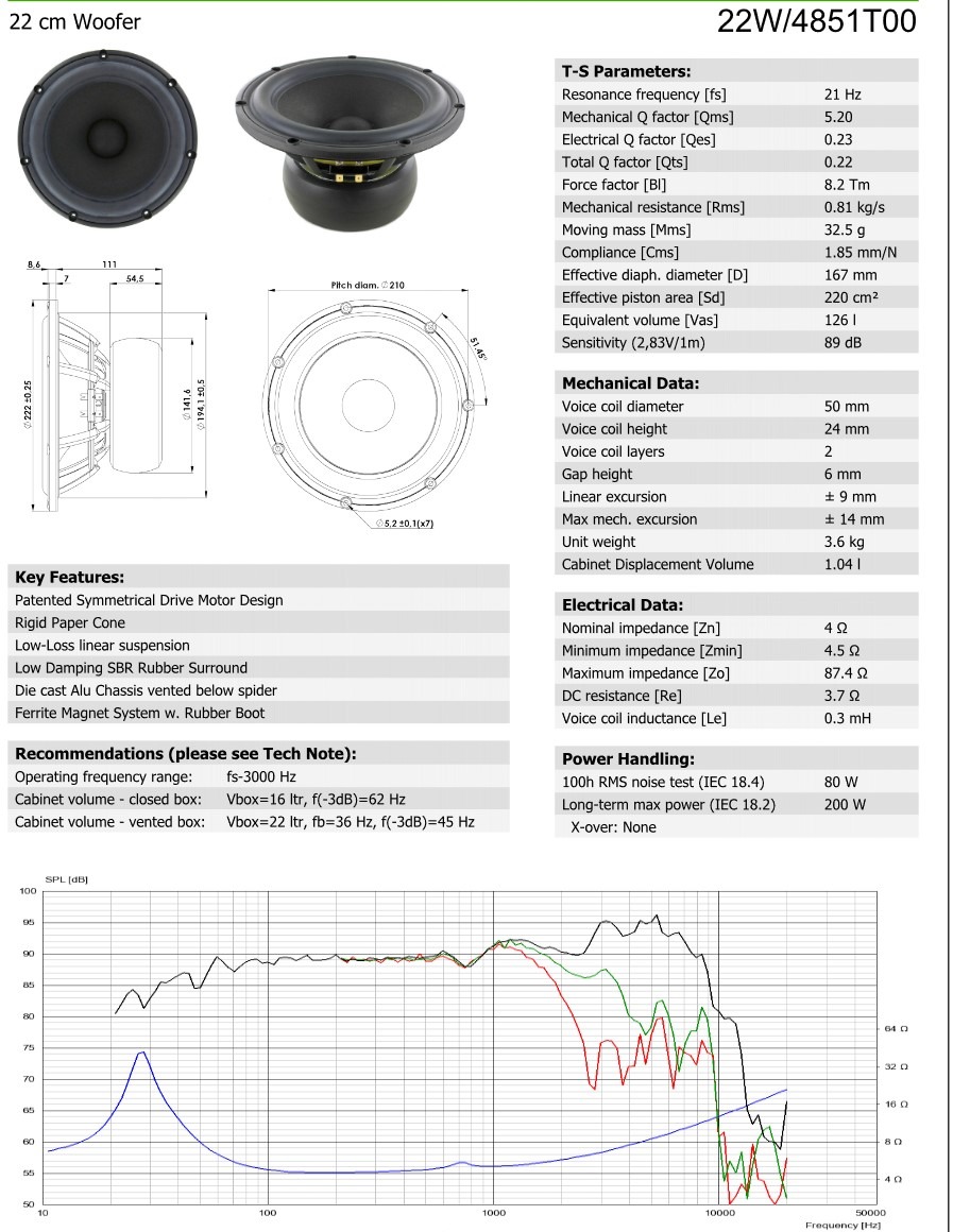

The 4551 should be good to 800Hz, so why the MW16TX? It seems like a "midrange" that would need a bigger woofer. Sensitivity?
- keep the woofer close to midrange (with this rule the result was always good, solid soundstage, the bands are well integrated and connected). Woofer placed close to the floor, on the sides, or read side, well there are the approaches to deal with this by lowering crossover etc, but I was never fully happy with the results.
- I do not push midrange-woofer Fc too low, 6-7" midrange Fc ~300Hz, 4" midrange ~500Hz
22W/4851 has strong resonance at ~700Hz, I wanted to avoid making Fc close to this.

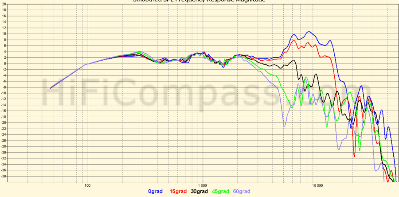

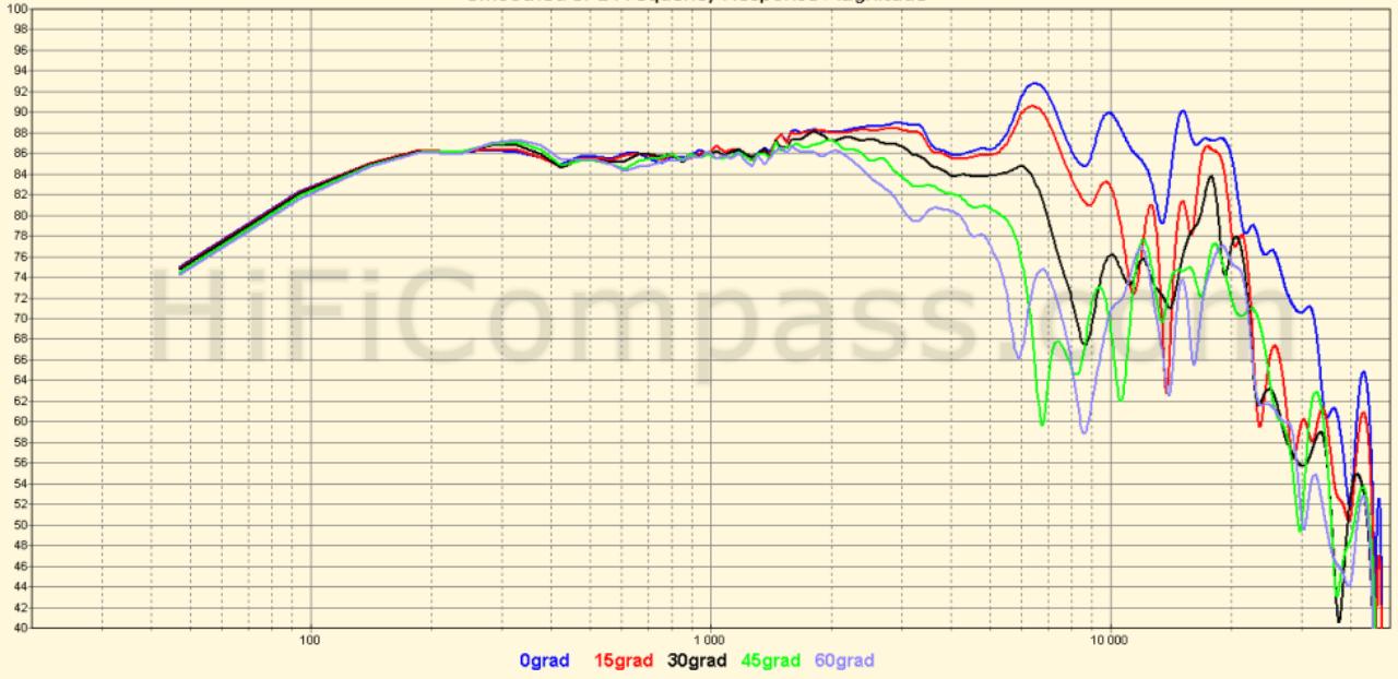

First picture is TX the other the NRX.

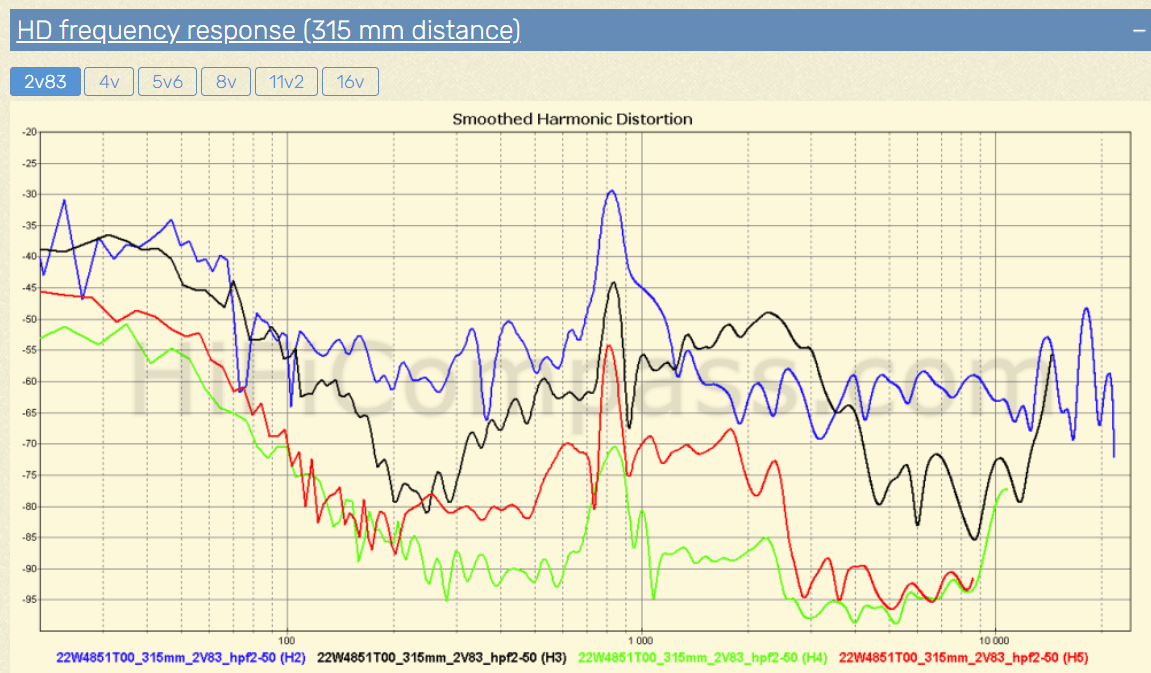

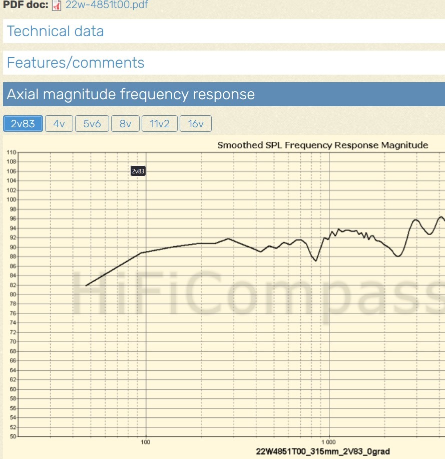

Strong resonance? I see a bump in the impedance curve... but that is small - right?
It is likely cone edge resonance. Anyway, it was just one of the system integration aspects. I do not follow 8+4+1, 10+5+1 etc guidelines. In this case I wanted to implement T25B with 5" WG, and 22W drivers I had already at home. To get good directivities matching with WG, ~6" midrange was the obvious choice.
Hificompass measurements:
Ah.. It's the harmonics making that "disturbance" at around 800Hz. Interesting how hard cones often get a bad rep for high Q issues, when this paper woofer clearly has trouble too. But again, a given type of cone material can be made in many ways, which works across common belief of concept. KEF uses a rubber ring around the coil to cone fixture, to tame the typical resonance of their hard cone midrange. So many ways to do it.

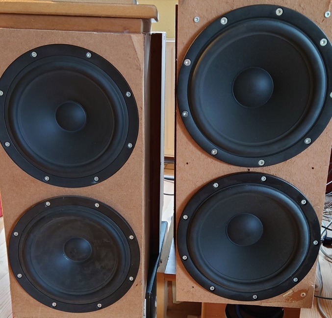

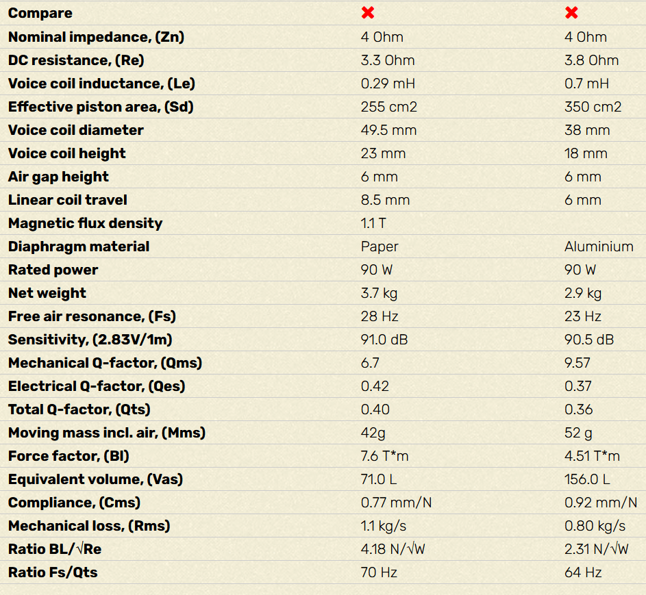

One of my friends often has drivers on the shelf, so I tested it for kicks and curiosity.
SB23NRX and WO24 are within a few millimeters of each other, when it comes to diameters of cut-out and over-all basket size. So I took two identical closed 60 liter boxes and swapped two NRX for WO24 in one box - then shifted between them to hear what full-range on both sounded like. The NRX definitely has way more upper frequency to it, which is also clearly seen in its break-up mode, and distortion measurements also define this pretty clearly. They measure almost identical when it comes to how deep they play and the curves are, in-room almost on top of each other, except the NRX being around 1,5dB more sensitive. They are coupled in parallel, providing a 4 ohm load and driven by a 400W amplifier - directly - with DSP in front.
I then added my usual 400Hz LP LR24 filter, to hear how much came through when used as an actual woofer + added my coax on top, because a filtered woofer alone, always sounds weird to me.
And here I think I found the real difference between the two different motor and cone types. The better motor and stiffer cone of the Satori, makes transients in music like funk/disco and acoustically dynamic recordings sound way more distinct. With the NRX it sounds flat, where the Satori gives a much more natural "snap" when a musician smacks the guitar or a drum smacks hard. The tone is there in the NRX, it just sounds smoothed out, where the Satori has way more "life" to the actual dynamics of the sound.

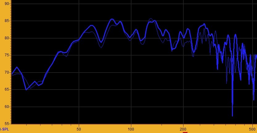

did you equalize the acoustic response of the woofers to be the same?
Using same electrical crossover doesn't equalize them, and they would sound different due to different system response, no matter what's the reason be it motor or cone or everything different.
When equalized to same acoustic response, differences due to frequency response is now eliminated and any real difference of materials, motors, cones, better one would emerge. I mean, if you compare technically superior and inferior driver, but they just have different frequency response, the inferior could sound better if it happens to result better system response. First drivers must be equalized to have same acoustic response, then overall SPL needs to be calibrated as well to match the system responses.

And believe me, I absolutely wished that there were less of a difference, since I could then live happily with the cheaper option 😉
It could be that the geometry of the cone, the slightly larger cone area and other little factors plays a role too. I will certainly explore further and create my own thread about it, since I have a project right around the corner with these 😀
The thicker "bluer" curve is the SB23NRX and the thin slightly dotted one is the WO24P-8

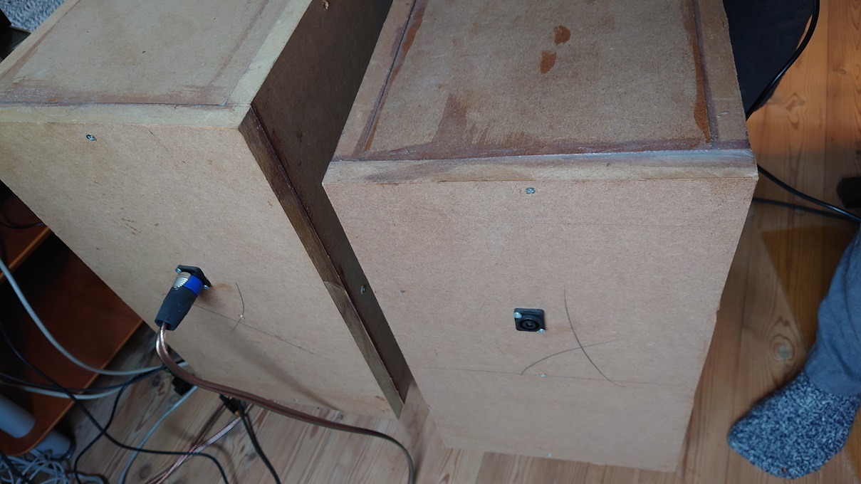

I played only a simple bass tune with a simple rhythmic tone like the intro of Daft Punk - Da Funk, or the like. Then at moderate volume, sitting in front of the woofers, switching forth and back between them. It's a little bit like the experience I have when switching between two different amplifiers, where one have much better damping/control - the sound somehow "tightens" and it becomes less muddy.
The only difference is the drivers. Cabinets front baffle, room-placement, stuffing, amplifiers - everything is the same. The NRX has a "character" to it, which also shows in its other published curves. And even when EQ is applied, the tonal character seems to stay, even though you can dampen it a bit with EQ.
