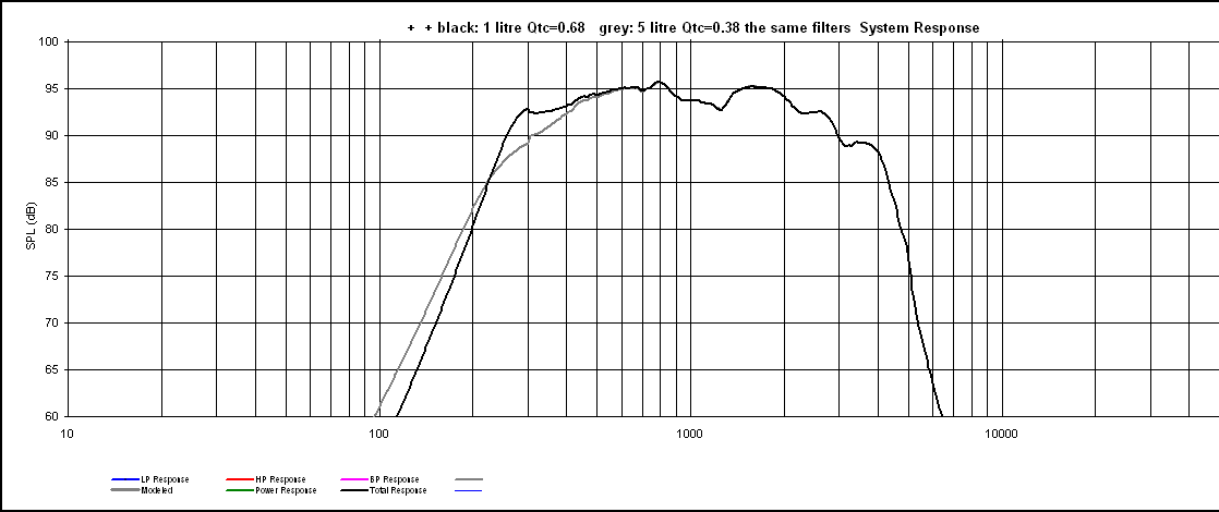

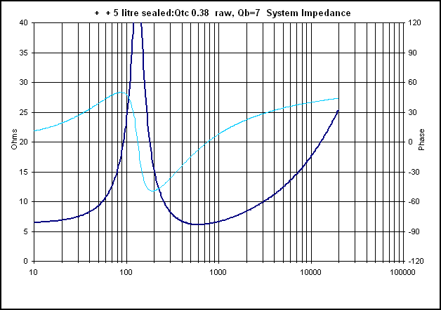

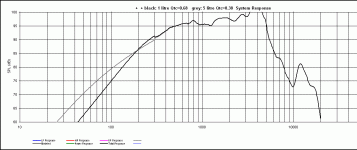

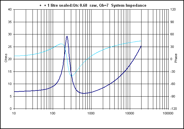

These are simple simulations with not that great splicing at 300 Hz,
but it should give us a taste of what is going on. The smaller cabinet
has significantly higher Fb so the same XO filter because of the Impedance
peak doesn't work the same as in a larger cabinet. In order to have similar
HP response in both of the cabinets the smaller version would need
an RLC Impedance peak compensation and different HP filter values.
