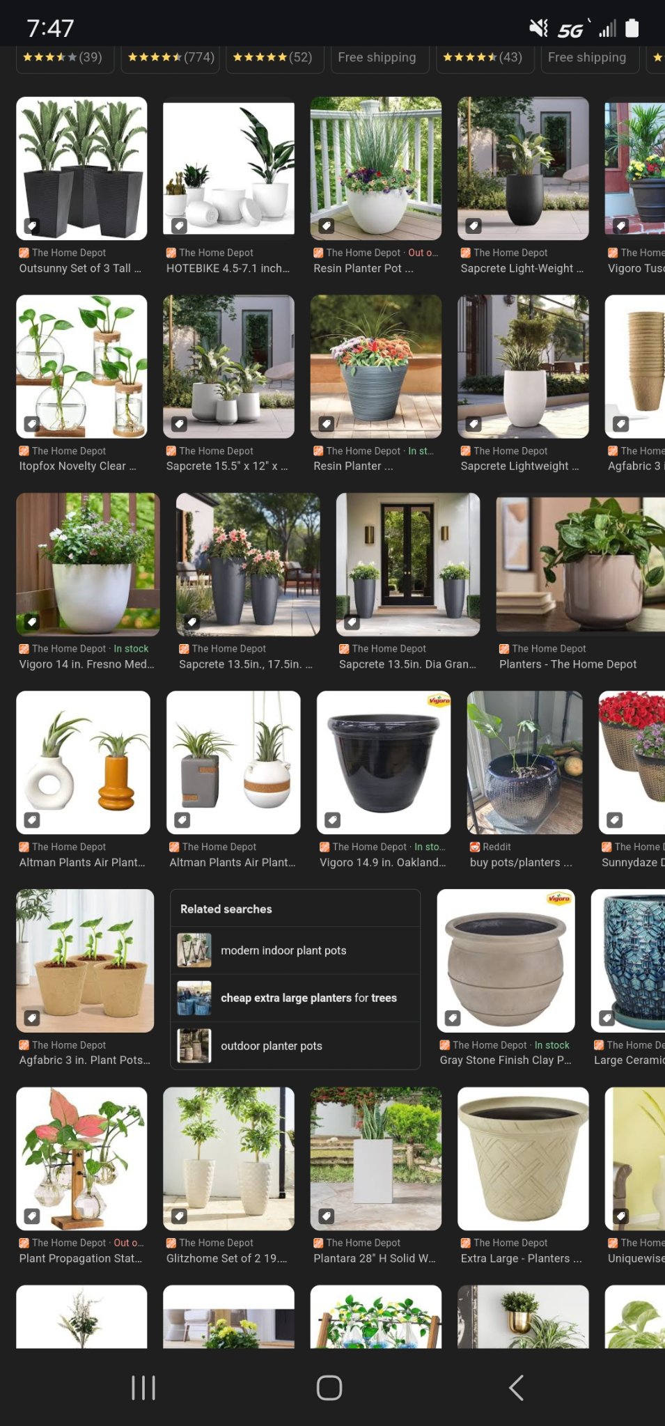

I need a solution for enclosure or chamber which is mounted inside of loudspeaker cabinet to protect midrange or mid-bass driver from bass driver interferention. It must be sealed solution, no matter is it just aluminium cover or construction of MDF or plywood. As you can see - I know how to do it, but is there any simple way to do it? Where I can (perhaps) buy this cover? Is there any special name for this, because I cannot find something good... If I'm going to build - it will take some time and efforts.

Any plastic flower pot or vase would do.

If we are talking about measures - driver is 10 inch, it's approx 250 mm wide and 120 mm depth. Measures are taken when driver is positioned on front panel...so I need a pot diameter 250, and 120 mm in depth.
