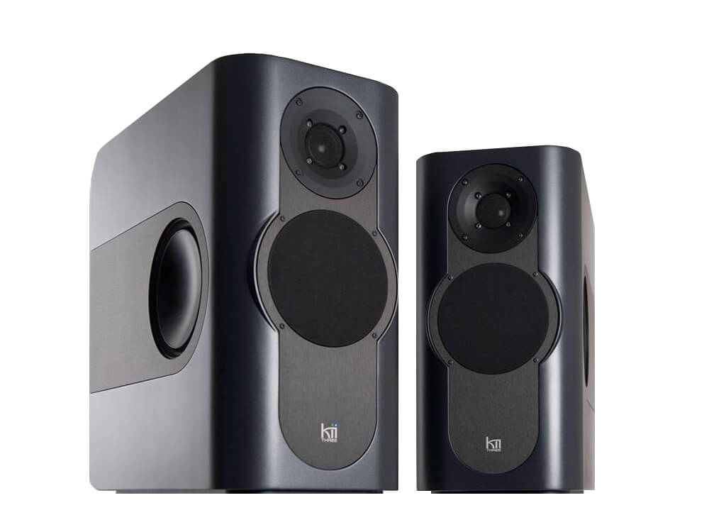

This is the first time I've seen the Perfect8 but the Kii Three is similar. The Kii adds an additional woofer to the front out of phase with the side drivers. In that case it shifts the relative volume level from front and back to front only.
