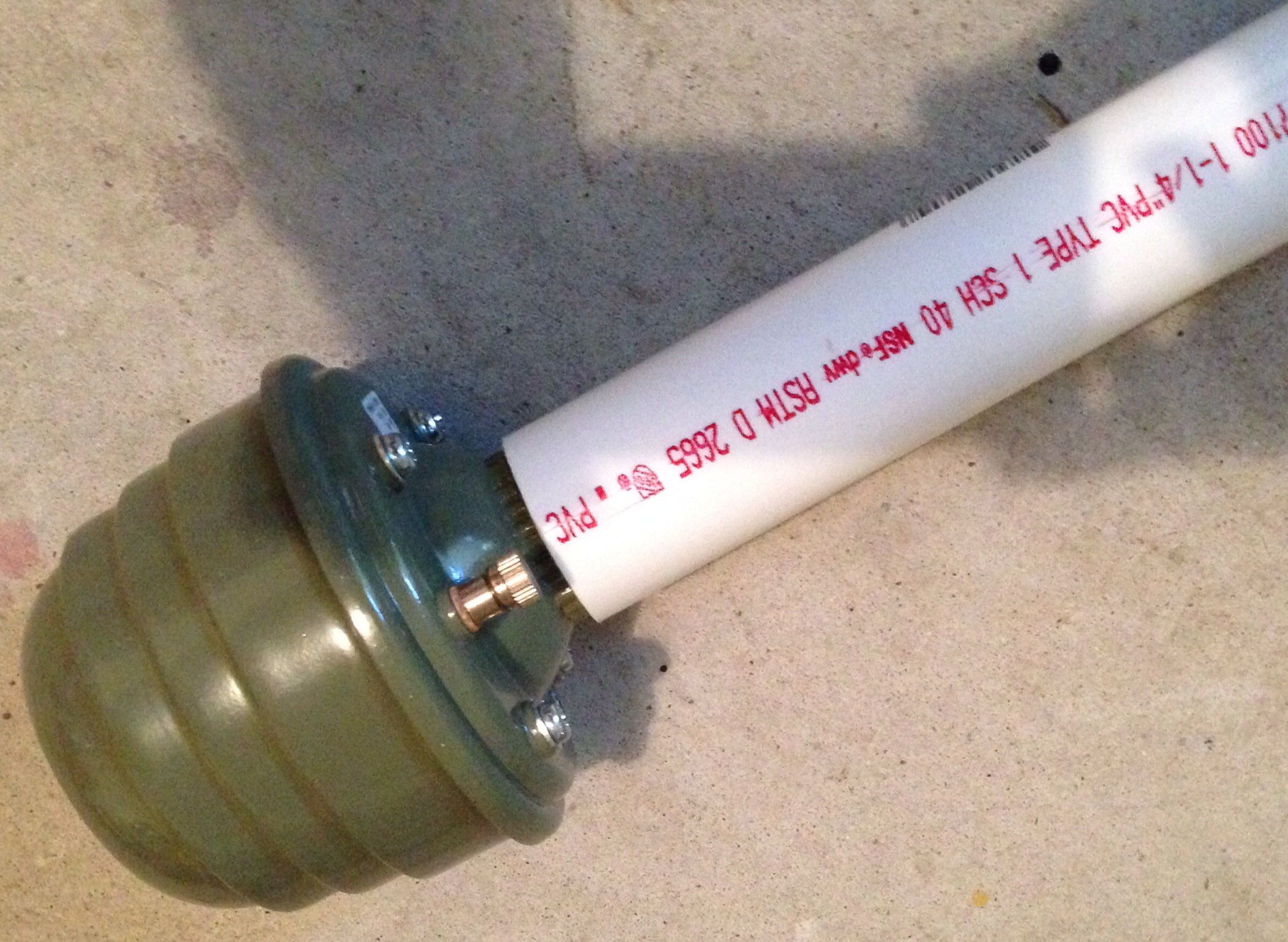

Found some suitable pipe (currently 2 ft long) that the driver can securely screw into. I won't be able to measure the raw response / impedance or cut the slot till this weekend

I guess I'd suggest first trying to make a tube proportional to the Transylvania unit. Since you have 1.25" PVC, I'd make the slotted length 6.625" long and only keep enough "stub" to screw into and perhaps make a smoother transition with some blue-tak or putty. This should provide a fair load into the 600Hz range I surmise. Adding a longer "stub" section might take that lower, but could introduce unwanted artifacts. Only testing will reveal that. 🙂

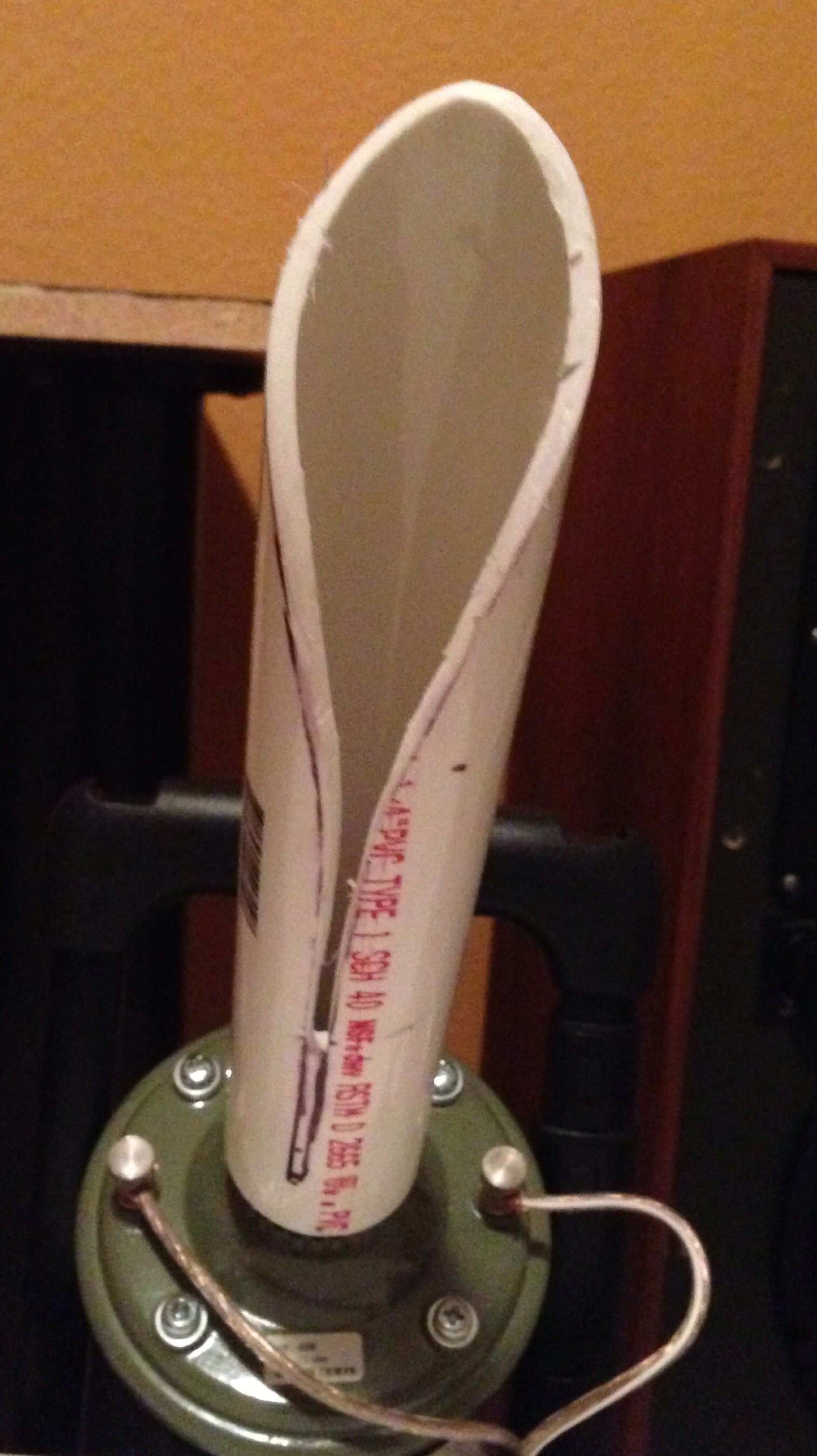

I started out with about an 8" long pipe, sketched something approximating a mirrored exponential slot on a piece of paper and transferred the profile to the pipe. I carved the profile using a cut off wheel on my dremel.
Update:
For now, I started the cut about 1/3 of the way along the length. The k-tube for now sounds better than the uncut tube but it still sounds somewhat hollow and resonant. On the plus side, the dispersion is rather good. Using a frequency generator on my phone, the sound seems to pick up around the quarter wave frequency of 400 Hz
I think I need to start the curve earlier and open it out a bit faster and should probably take measurements as I continue to mangle the tube.

Cool! I guess the profile deviates a bit from a half-ellipse but it still looks ballpark to me.

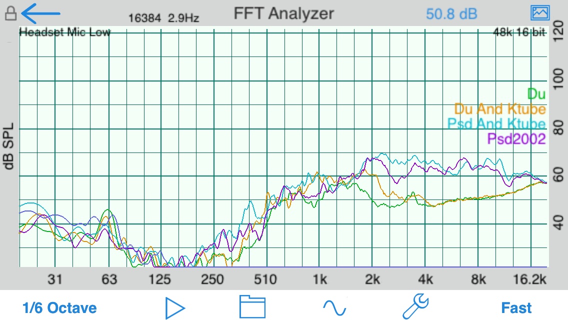

Measured the k tube on the midrange compression driver as well as on an eminence psd2002 (more efficient ). Instead of the u-mik and REW on my laptop, I used my iphone , audiotools and the cheap dayton imic
The psd2002 sounds better, despite a higher resonant frequency

Not certain the throat angle mismatch would account for as large an effect as that dip I got. Looking at certain traces of BMS 4550 on the Tube, there is also a little something, as well as a bit more distortion at that frequency. I'm wondering how the two drivers would compare measured in the far-field, like a good 10' or so, which I can't really do well indoors. I also used D220Ti at first on the tube, but don't think I kept any crossover-less plots of it.
