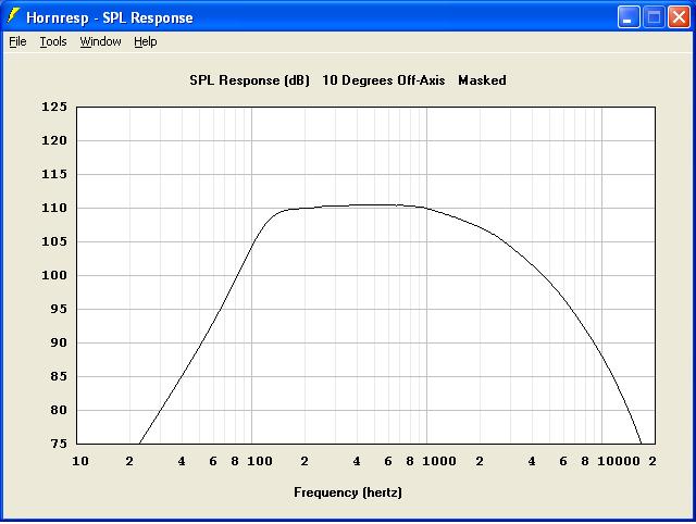

After the discouraging sim of the 206e I also tried 206en and that looked a lot, lot, lot better. Question is how much the whizzer-cone will contribute to hf-response? Note it needs a 3dm3 backchamber to keep lf-response OK. Will work with open back if you can accept a higher Fc.
Sim is with a full Le'Cleach 200Hz, T=0,8 and 2,55:1 compression. 2:1 might be OK too.
The rising response in the upper register might help a lot. I guess the treble response will also be better than the sim due to direct radiation. Still a tweeter might be added due to beaming. Jean-Michel can probably predict this.
No other sims than those with full LC shows a close to flat respons on 0-20 degree axis. The others like Sph and Tx shows rising response.
Anyway dump the idea of the conical Pispeakers horn.

Learn Hornresp! Will take you just a few hours. Forget about Volvotreter and MJK. You have it all and also optimized in Hornresp. Simulation of all parameters, templates and much more. Also remember a Lecleach and a Tractrix differ a lot in size. A 150Hz Tractrix has a diameter of 65cm and a full LC 126cm.
Hello Jean-Micel
I didn´t use the text file. By taking Am=12955cm2 from Hornresp and running "ROT(Am/Pi)" I got a somewhat other radius. It is probably necessaryto use At=80-100cm2 at what the "en"-model sims nice. This makes the horn somewhat longer though. I used T=0,8.
EDIT: Just doublechecked and the export seems to differ from the "input parameters".
Nice thing that David now incorporates the petals, I haven´t looked into it though. How many petals is your sim for? I don´t have the new version of Hornresp here at work.
