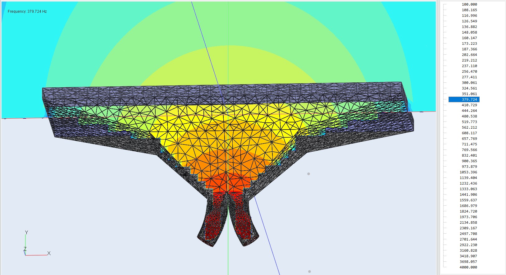

379Hz the wavefront in the throat looks planar, waves in horn look as expected for conical horn:

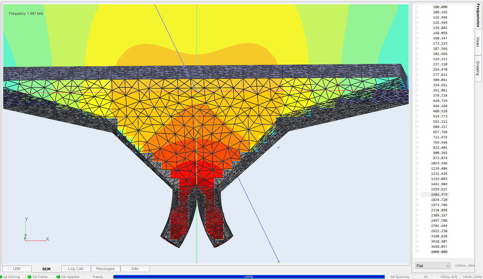

1600Hz somewhat odd, perhaps some cancelation in the initial conical flare and then weird interaction with the flare

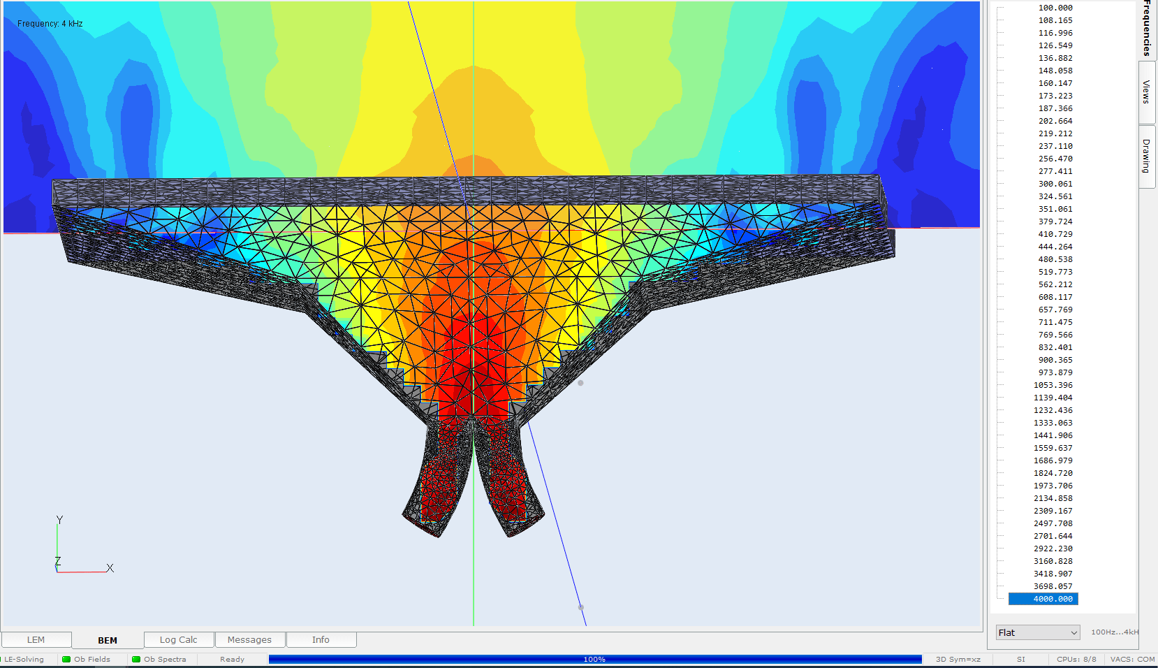

4k the source size is causing beaming
so I would guess something to do with the throat having two acoustic centers that are offset? might work better if I rotate the throat adaptors 90 degree so the offset centers are driving the 60 degree horn.

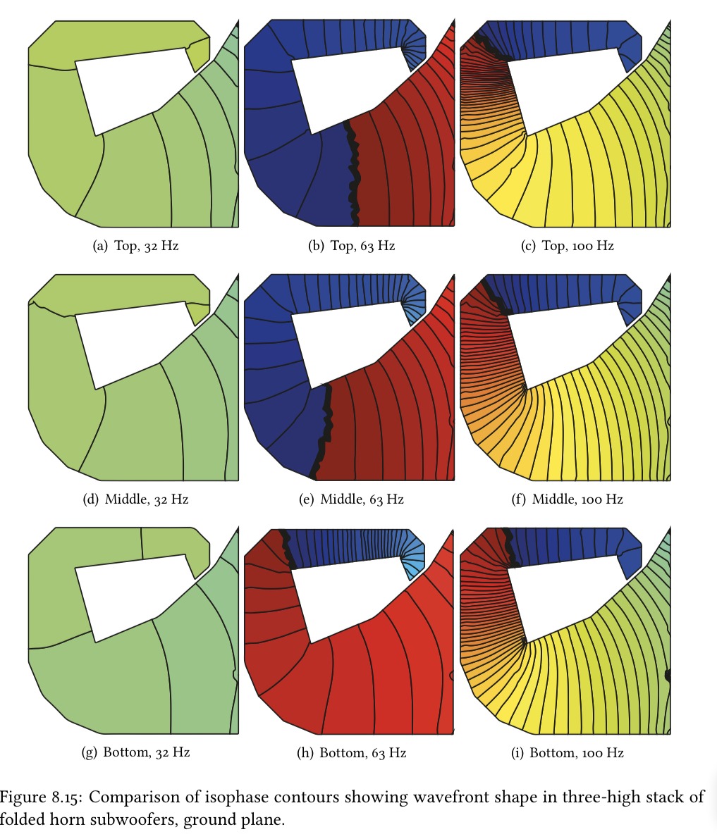

You can plot phase isocontours for the modelled frequencies in AKABAK, although the colour stepping wasn’t adjustable nor could be disabled last time I checked.
It might be useful to analyse those both for each individual source & how they combine to see how the wavefront is interacting with the horn walls. You can do that with several duplicated Field observations, changing the radiating elements that contribute to each of them.
I found that exporting an image of the section-cut plotted phase isocontours and marking out the edge transitions between colours using the Image Tracing function of Adobe Illustrator helped highlight the wavefront shape development. Essentially adding black outlines for each step of a 5-degrees or more:
The sudden transition from dark blue to red is where the scale has ‘run out’. That was from a model with a ground plane infinite baffle, so the isocontours highlight the phase shift as you move farther out from the centre of the vertical array.
