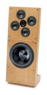

I do not see midrange drivers in a circle, do you?McIntosh Labs XR100, bunch of small mid range drivers and some of them are for hi mid and some low

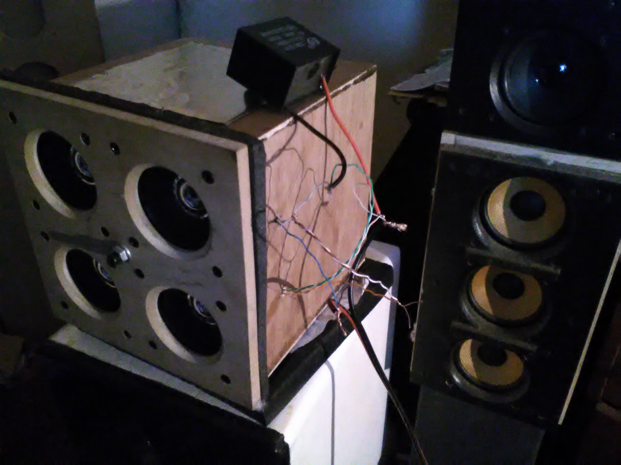

Yes, everything below 1,5k has had a bounce on the wall - It was a friend who had made som simulations about turning the speakers towards the wall which looked quite good so I wanted to try that...Wow, nice work and certainly in a circle
I would imagine that in the room, the wall behind is also part of the audio experience.
Btw, where did you get the inspiration, don't say that from this topic?
My analysis so far is that the LF of that speaker has no immediate problems so I'm contemplating a larger version with 6 pcs of 5", still facing backwards and a larger wave-guide. Perhaps with a 1,4" driver for lower x-over...
