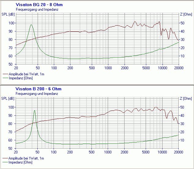

Midrange drivers dips above 1Khz...

My observation is that the crossover from dip to bump arises where a half wavelength matches the cone diameter.

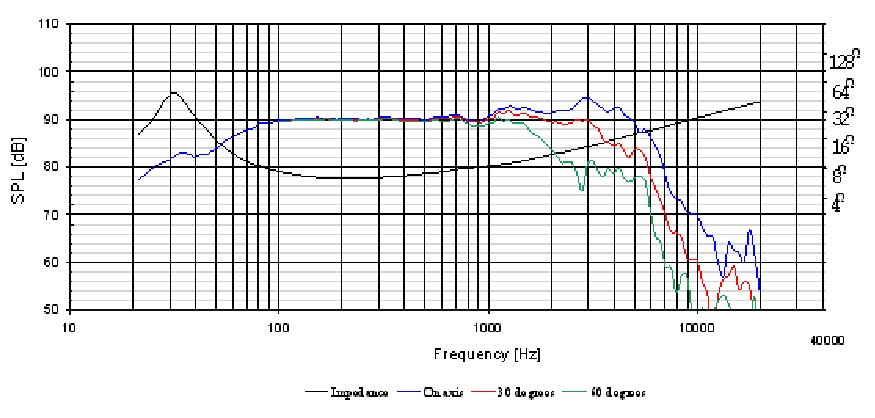

Quite a dip on the Usher.
Cheers ......... Graham.
critofur said:
The dip I'm talking about is the one you see on manufacturer's charts, sometimes followed by a bump. This would typically be measured on-axis on a large baffle in an anechoic chamber.
Jay_WJ is correct, it's almost certainly due to a cone/surround impedance mismatch. This is found most with PP and doped paper cones, though not all. It's seldom found in hard cones such as metal and ceramic cones.
For true midranges it can be exacerbated by a restriction as mounted on the baffle that often impacts the same frequency range. It's very important to open up the air gap by chamfering the rear of the baffle around the driver opening.
When I was working with someone who designs and builds his own custom drivers for his company, I referred to it as the dipbump, with our drivers it was around 2Khz and not as severe as in some of the nice Vifa, Peerless, and Audax drivers I'd been looking at.

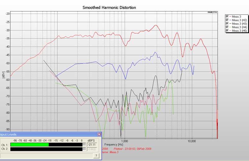

I've seen this numerous times with designs I've built. One thing I've noticed is that when taking a near field measurement ie. 40cm or closer to the driver axis, its quite pronounced. However, at a typical listening distance of 3 meters it disappears almost in my room. I take it this is because of a combination of reflected energy from the reverberant field reaching the mic.
Here's an unsmoothed measurement illustrating this:
Black shows 3m listening position measurement and green is at 40cm on axis with the mid driver.
It's hard to make any reliable predictions as to audibility. The direct response is very important, but so is the power response (in-room). The farther away, possibly the less audible I would suspect, I don't know for sure. Some folks have reported being able to hear this type of resonance on some specific drivers. It's certainly going to depend on many factors, including where in the spectrum it occurs with each person having differing ability to detect this stuff. It will also be music-dependent, of course.
I've found some things undetectable, then on other music a problem jumped right out. I recently had a 13m/8636 re-coned. There was a wandering soundstage, nothing I could pin down. Then I put on an a capella song that had just plain awful distortion from one driver not readily apparent in more complex music. It had to be replaced, the coil was not centered properly. The SPL measured just fine, the problem was in the distortion profile.
